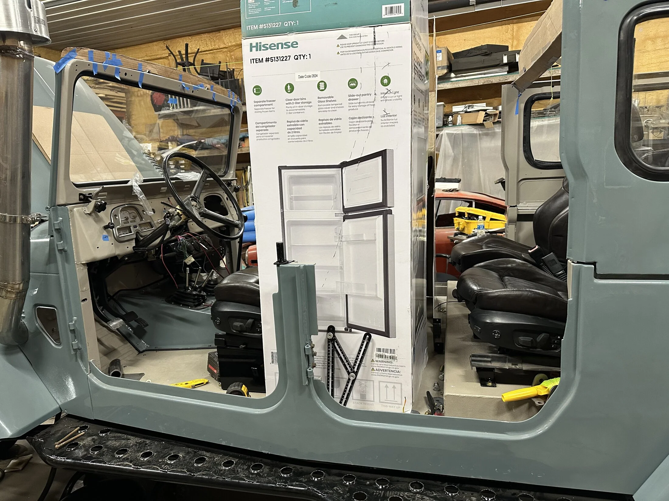

Picture of said seats? What were they out of?
BMW M93.
Editing this to correct to "BMW E93 M3" seats. Its all very confusing.

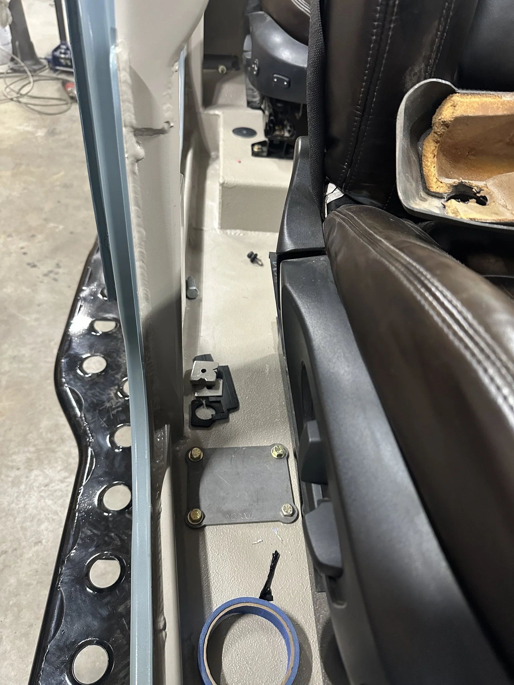

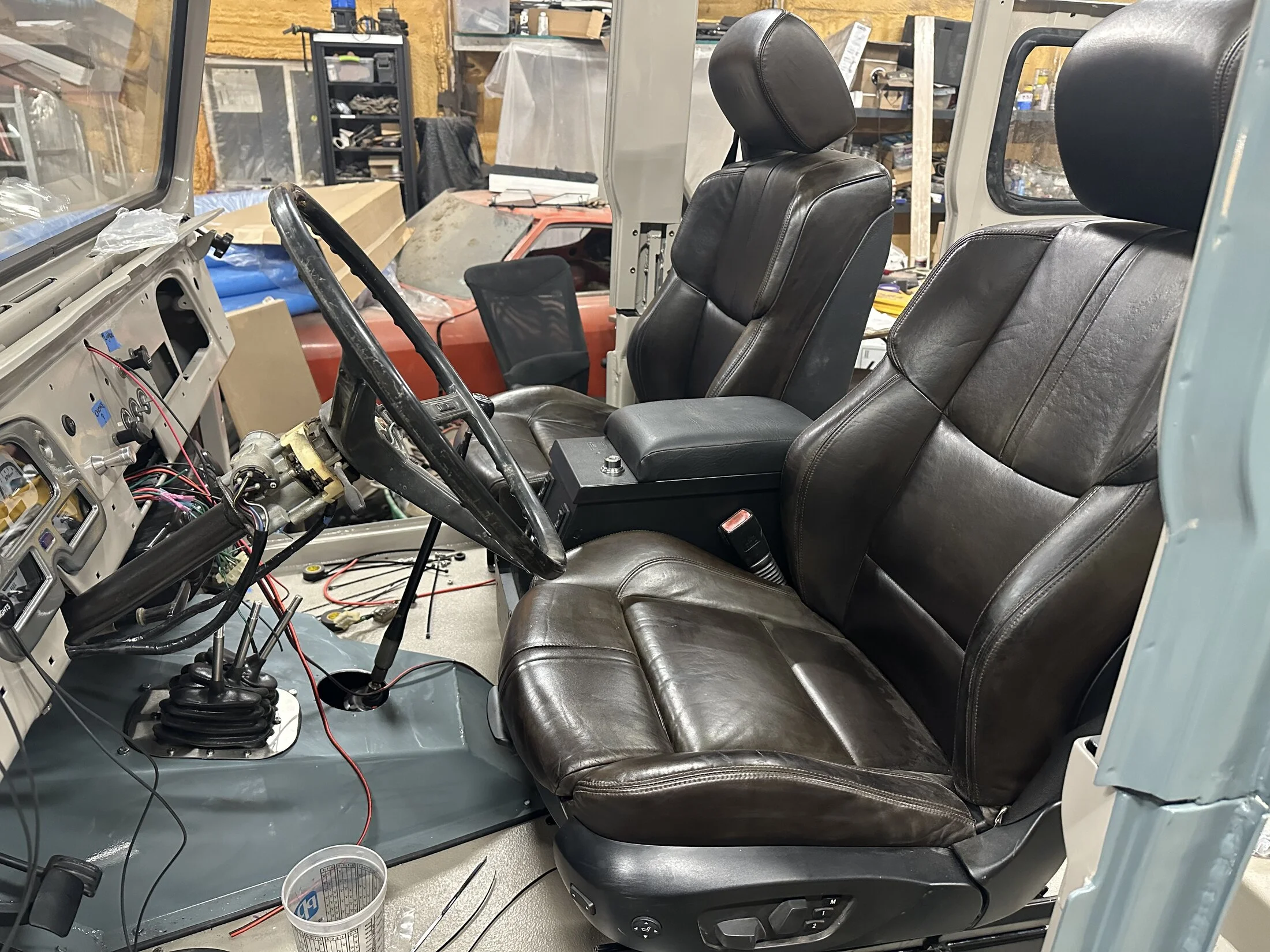

That’s not a car (I don’t think?), that’s a seat model used across a few platforms. Convertible, so all I have to do is bolt them to the floor, not worry about a seat belt point on the roll bar or certainly not on my janky b pillar.
4 leather 12 way buckets, gray and cracked, repaired and dyed brown from eBay. $1400 IIRC shipped from Ca. off ebay.
Tons of threads to convert the seats from BMW canbus to regular old hotrod dude electrical.

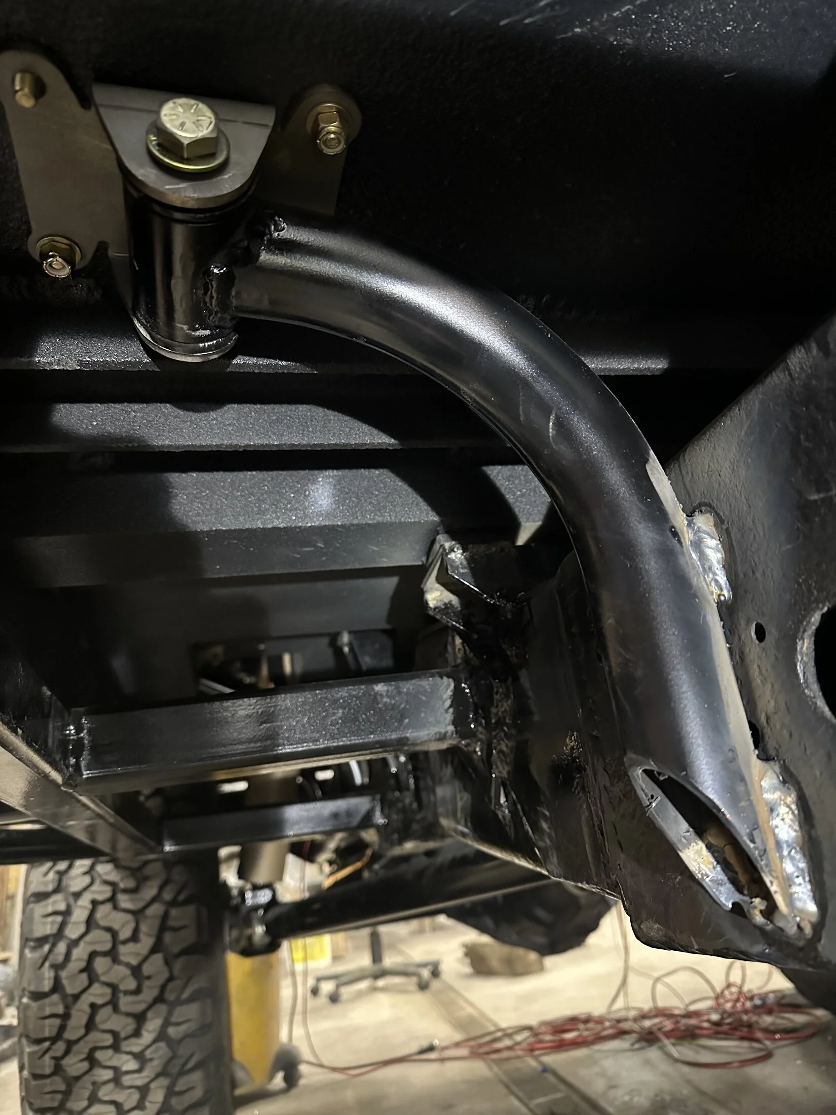

…also hope that’s all the underneath welding to be done.
Do you realize what you have done here? I thought that I was done welding upside down and in awkward positions a few years ago and I was under the rear welding upside down yet another time. Ha.

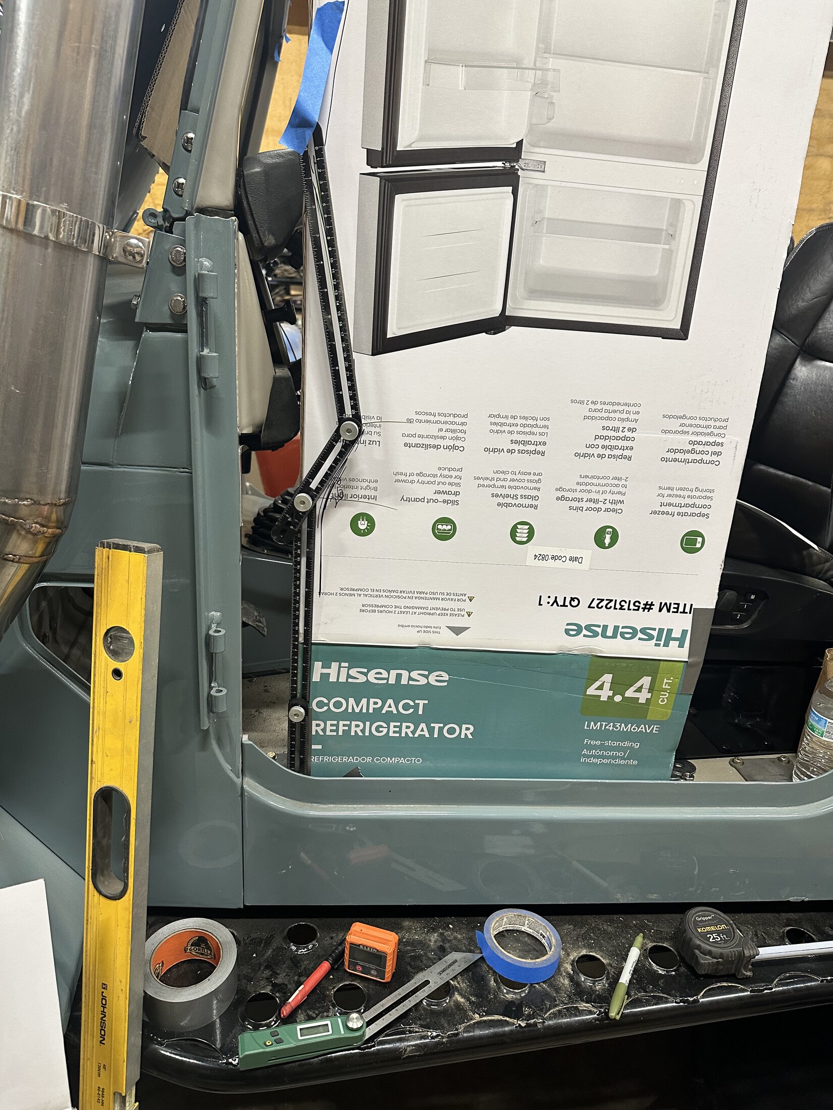

It is looking good. I’d move those front tubes and notch the plates so that they are tucked in closer to the A pillar. Just a thought.
I might be too late on that previous comment. I see that those plates are bolted down…

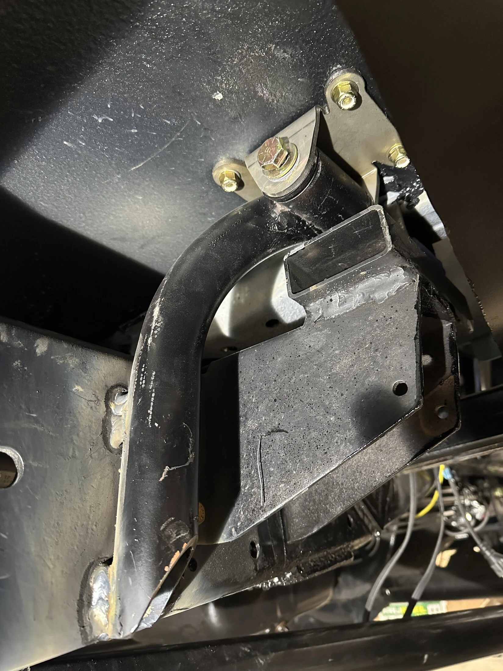

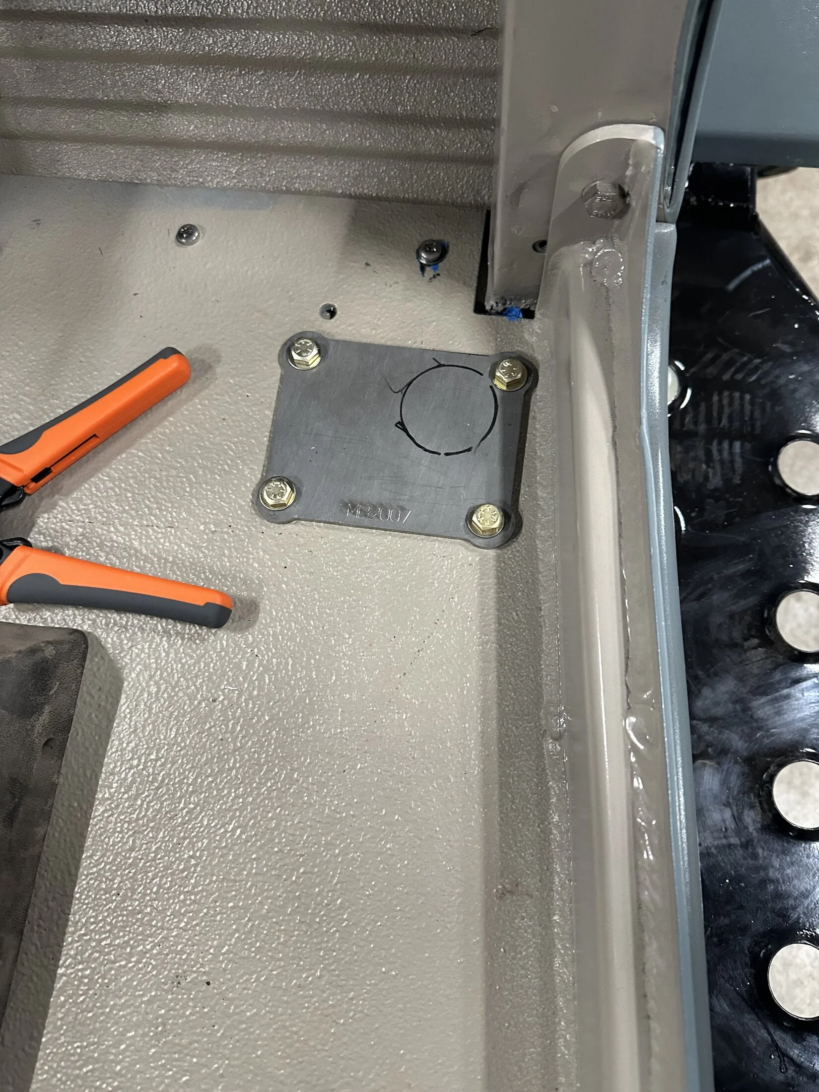

The floor is sandwiched between two plates, bolted together, one welded (via the rubber bushing assembly) to the frame, and the top plate forms the base of the rollbar, in case that wasn’t clear.
As far as where that is next to the a pillar, I can’t move it any closer and still be able to weld the lower bracket to the frame, due to the original body mount being right there. I used the Aqualu body mounts the way they intended as much as possible, and the roll bar mounts are separate but both mounted on rubber.

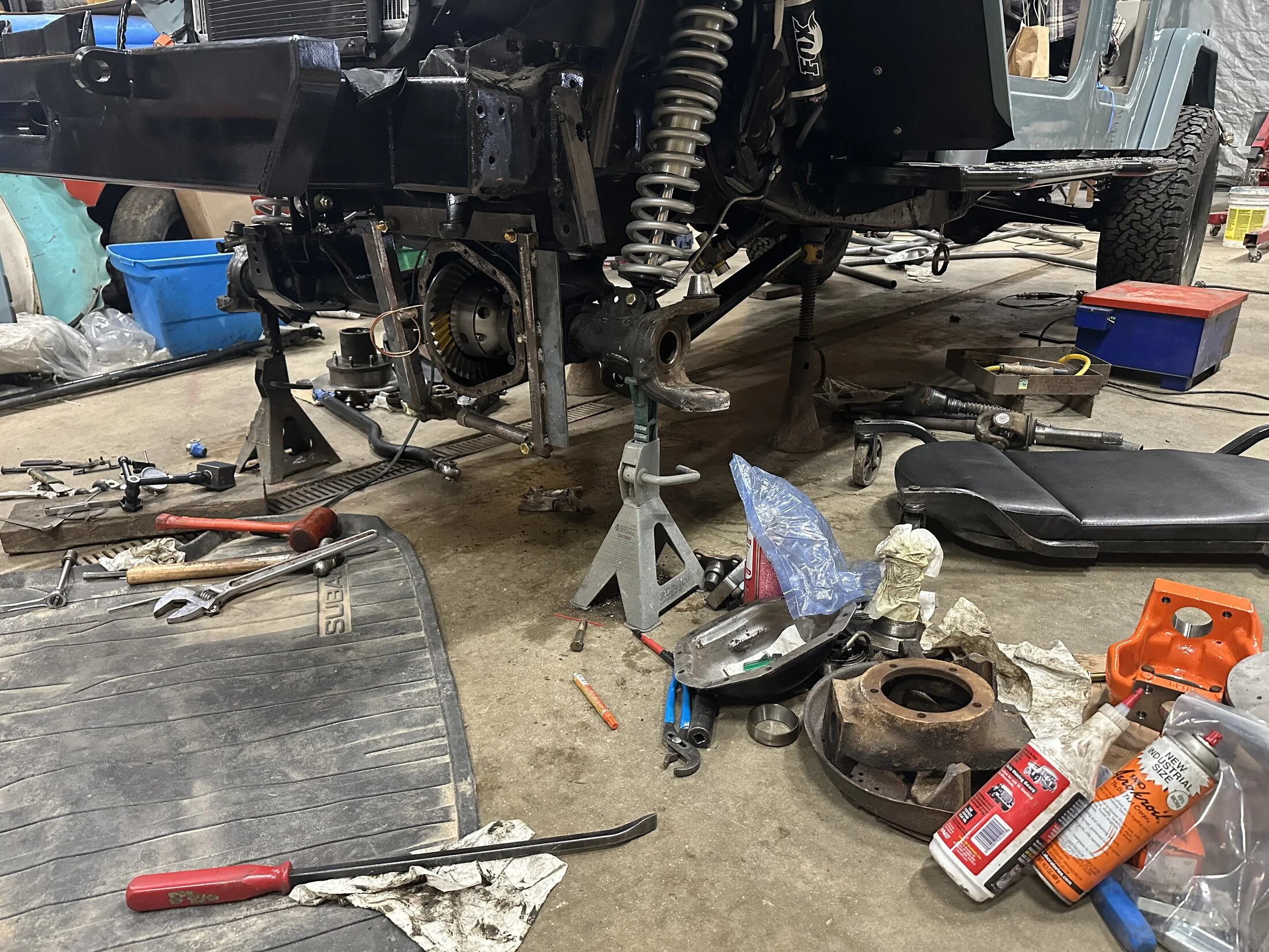

The decision was made a few weeks ago to just go ahead with the front axle locker install now instead of waiting. Parts arrived and it’s apart now, feels like going backwards to take it apart.

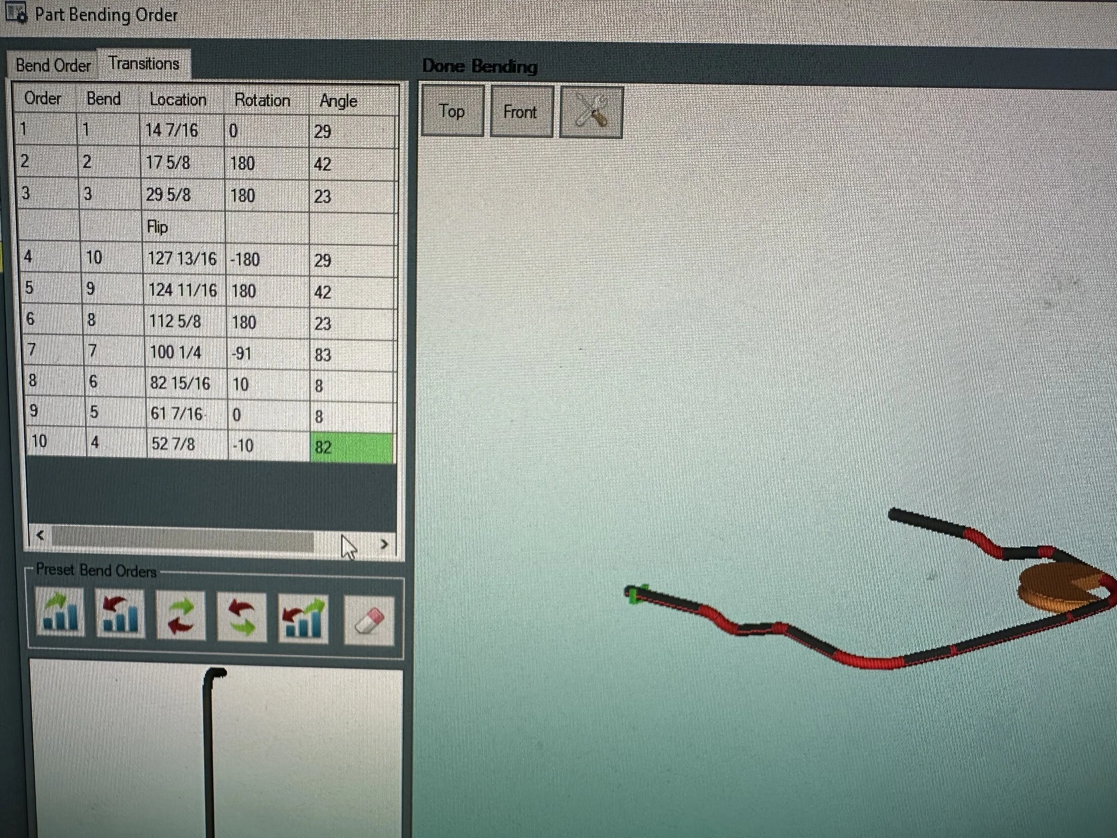

My big focus is on the roll cage. I bent one tube with the free bend-it program and went and immediately bought Bend Tech. Been quite the learning curve, my A pillar has 10 bends in it and b and c have 8 each. Bend Tech costs less than one stick from my close, instant supplier (way overpriced) or two or three sticks if I order it and pick it up from another supplier. I was able to use the ruined bend-it stick for cage under-body mounts.

Go ahead and put the front locker in now, they said. It’ll be cheap and easy, they said.
I mean, it does make sense to do it now because by the time I get this thing out the door I’m not gonna want to work on it anymore!
It only added up because new knuckles were in order to fix the steering geometry and clearance, and the obvious bearing and u joint replacements.
