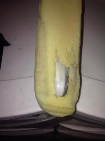

After many years of resting my elbow on the drivers side armrest, it was worn down and I could feel the plastic bar jabbing into my arm. It was driving me crazy. A new drivers side armrest sells for over $200, which i would never pay for a $20 armrest.
I figured I could unstitch the threading, put some new padding in, then get Kathryn to re-sew it...so I unbolted it, and to my surprise, it's extremely easy to remove the covering!! No work needed. All you have to do is unstick some Velcro, unclip a little plastic clip, and slide it off. I added some padding that I had left over from wrapping my water heater pipes, and it's better than new!! Best 15 minute mod I've ever done.
