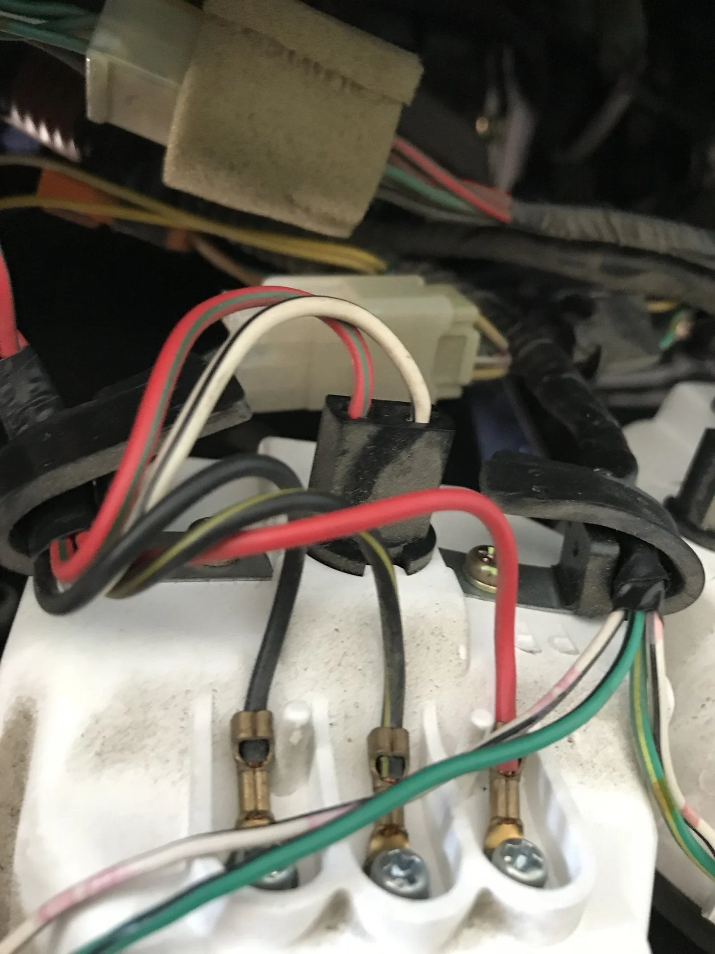

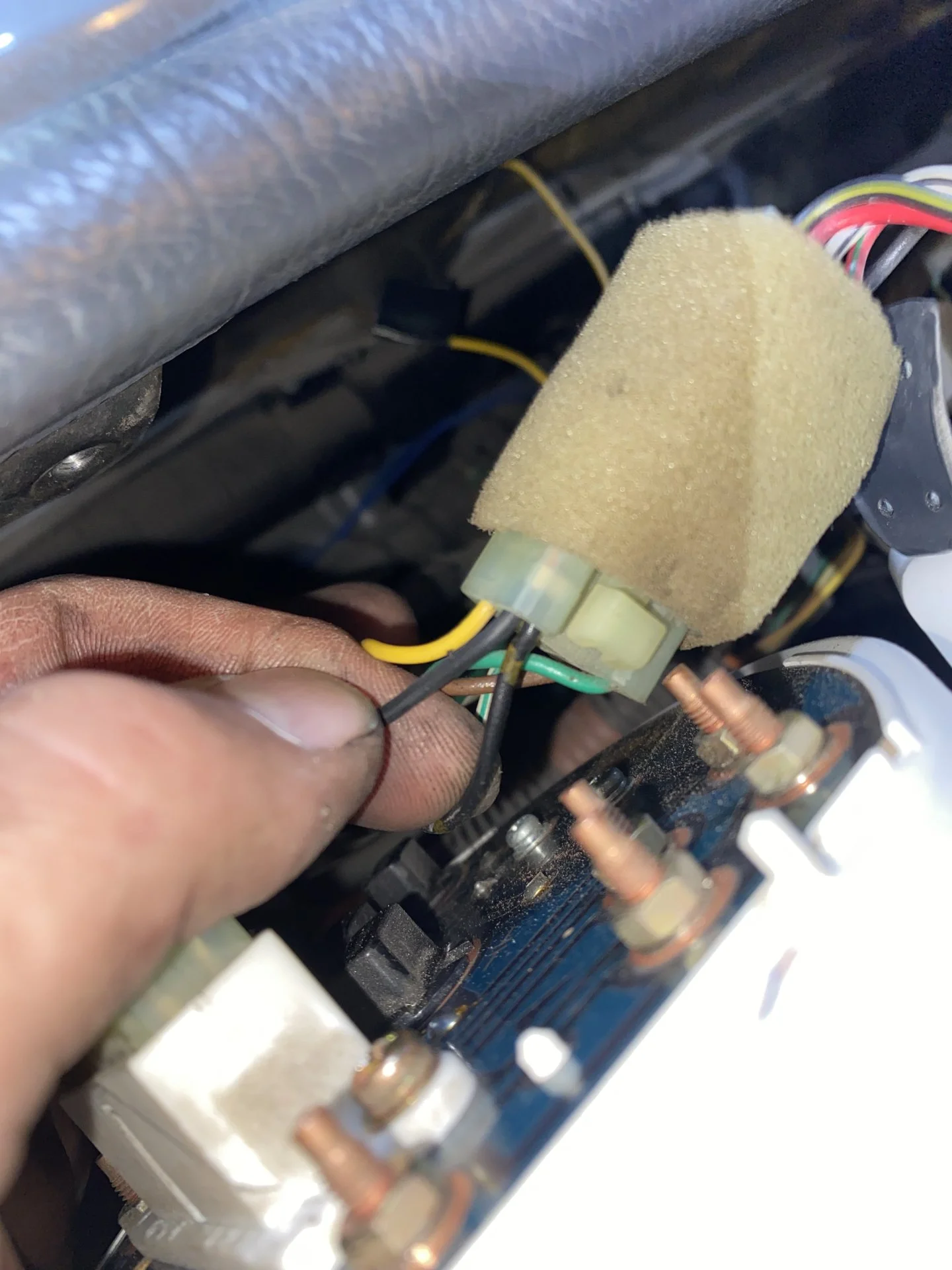

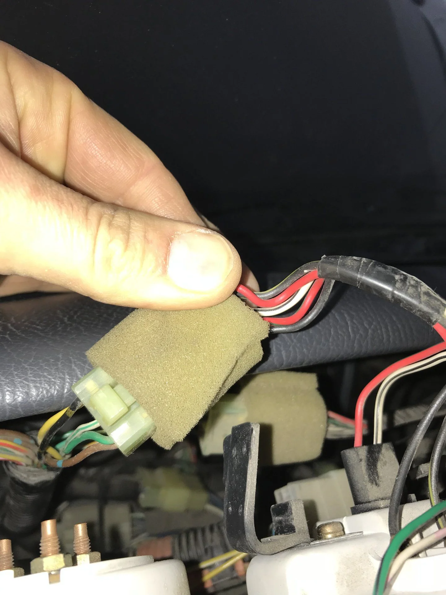

i don’t have those colours going into my tach. ill have to check tonight to see if that’s the colour codes in the harness upstream from the tach wires themselves. on the back of my tach there is a red, a black and a black with yellow stripe. this one has 12v when the ignition is on
just had time now....currently white black and red/green stripe are the light. there is a black wire with yellow dots upstream in the harness that connects to the red on the back of the tach (yes this is my stock harness). black/yellow stripe on the tach connects to a yellow wire in the upstream harness and the black on the tach connects to brown in the upstream harness.

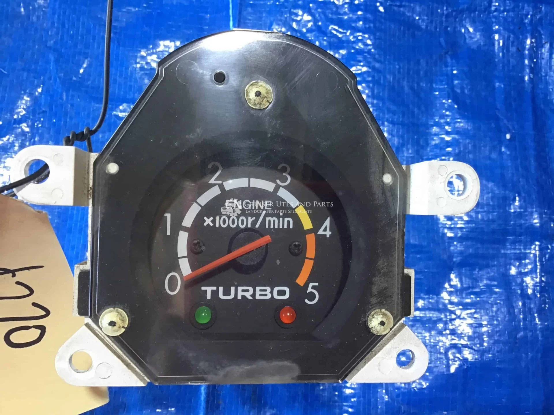

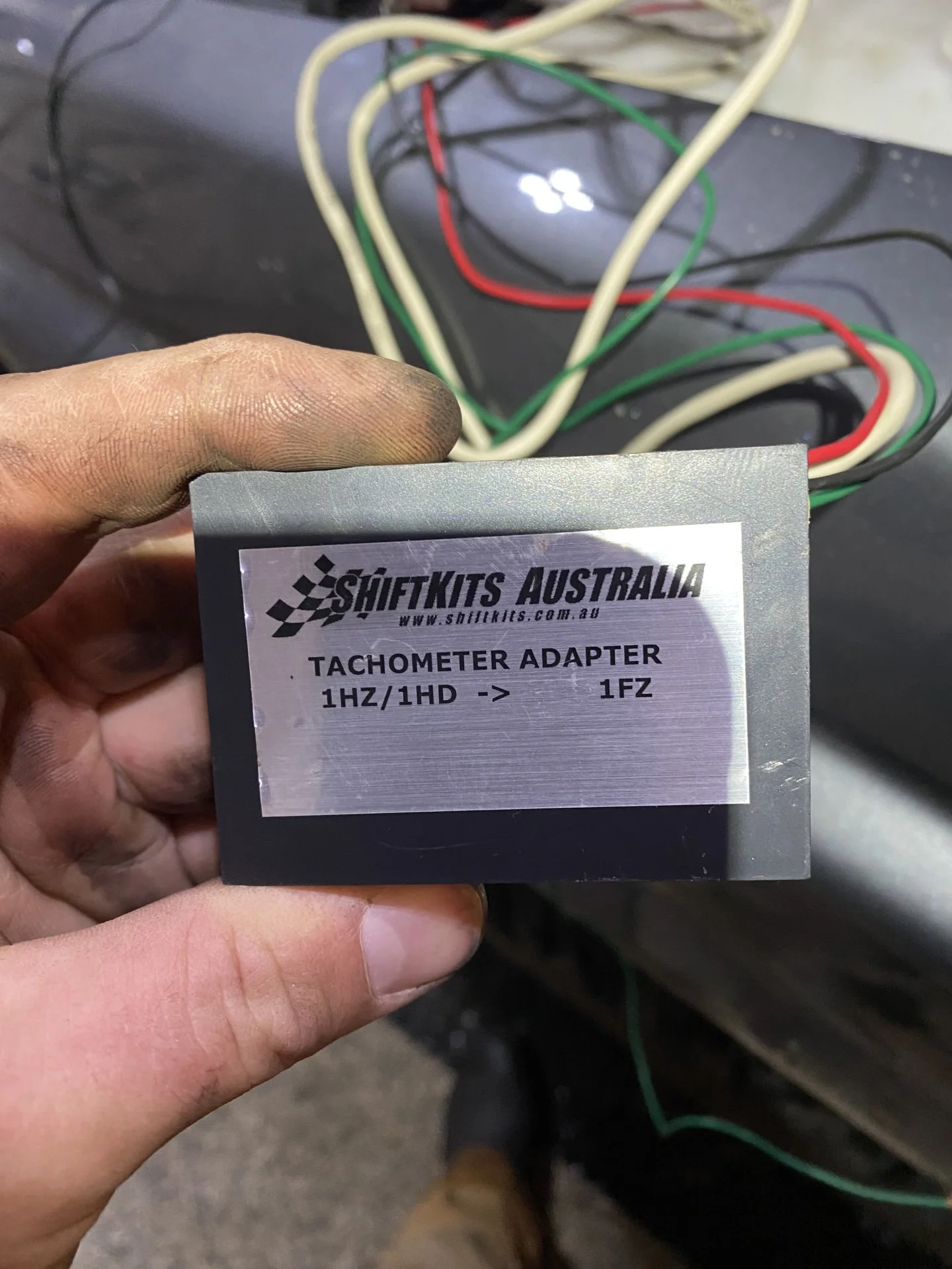

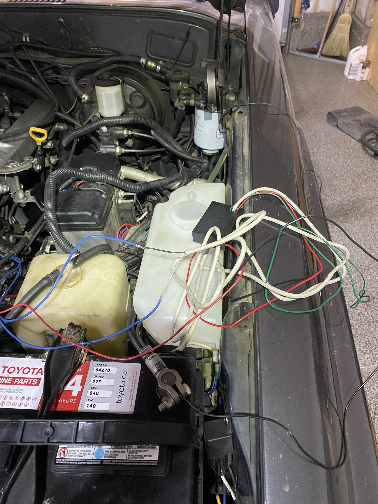

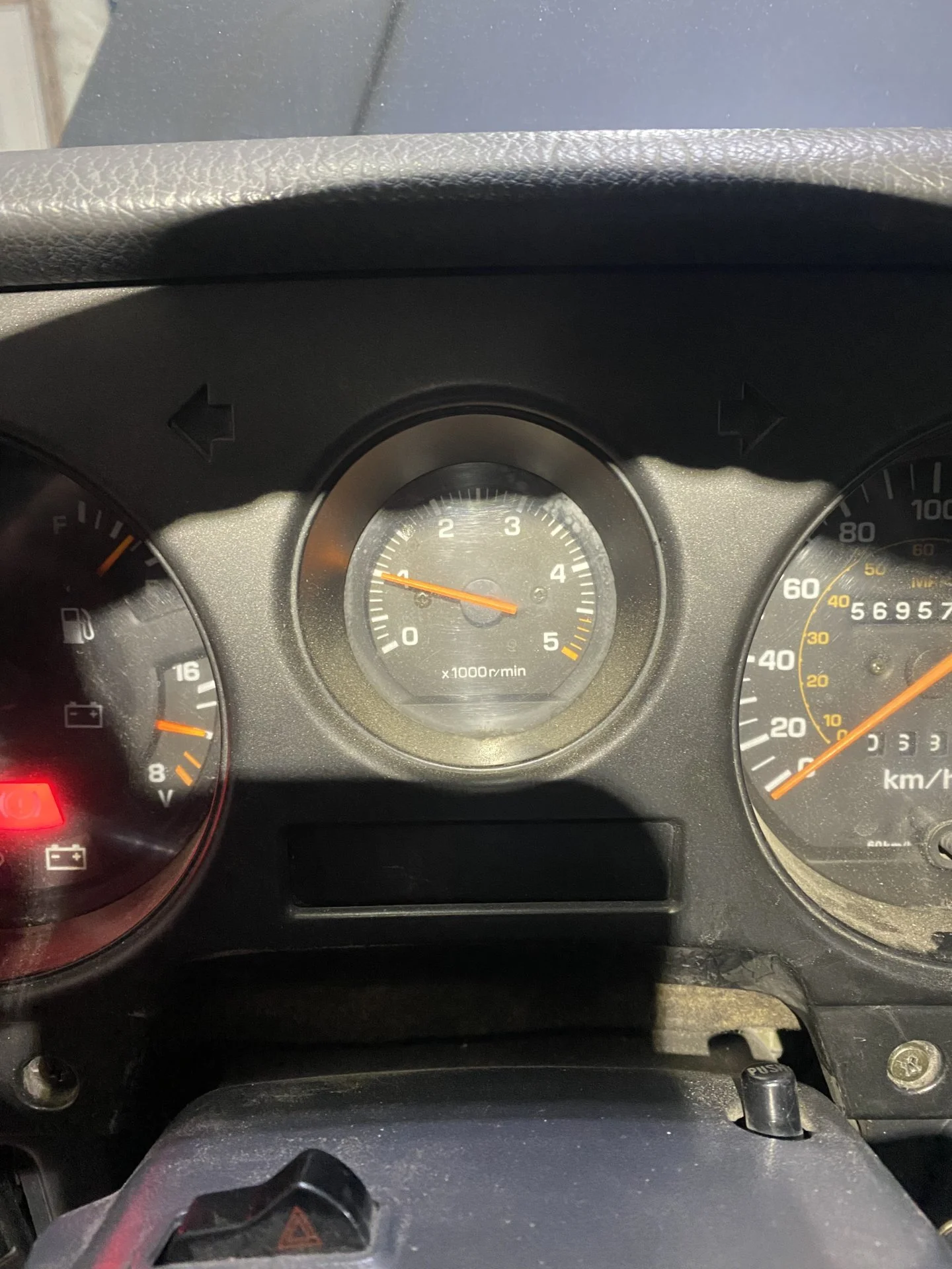

long time since i’ve added to this thread but i decided to give the stock fj62 tach a go again. i bought one of these this time…
it was a bit more expensive than a new tach but i like the original look.
turns out that the red wire on the back of the tach is the signal input. it connects in the harness upstream to the black wire with gold dots. i spliced a new wire into the connector.

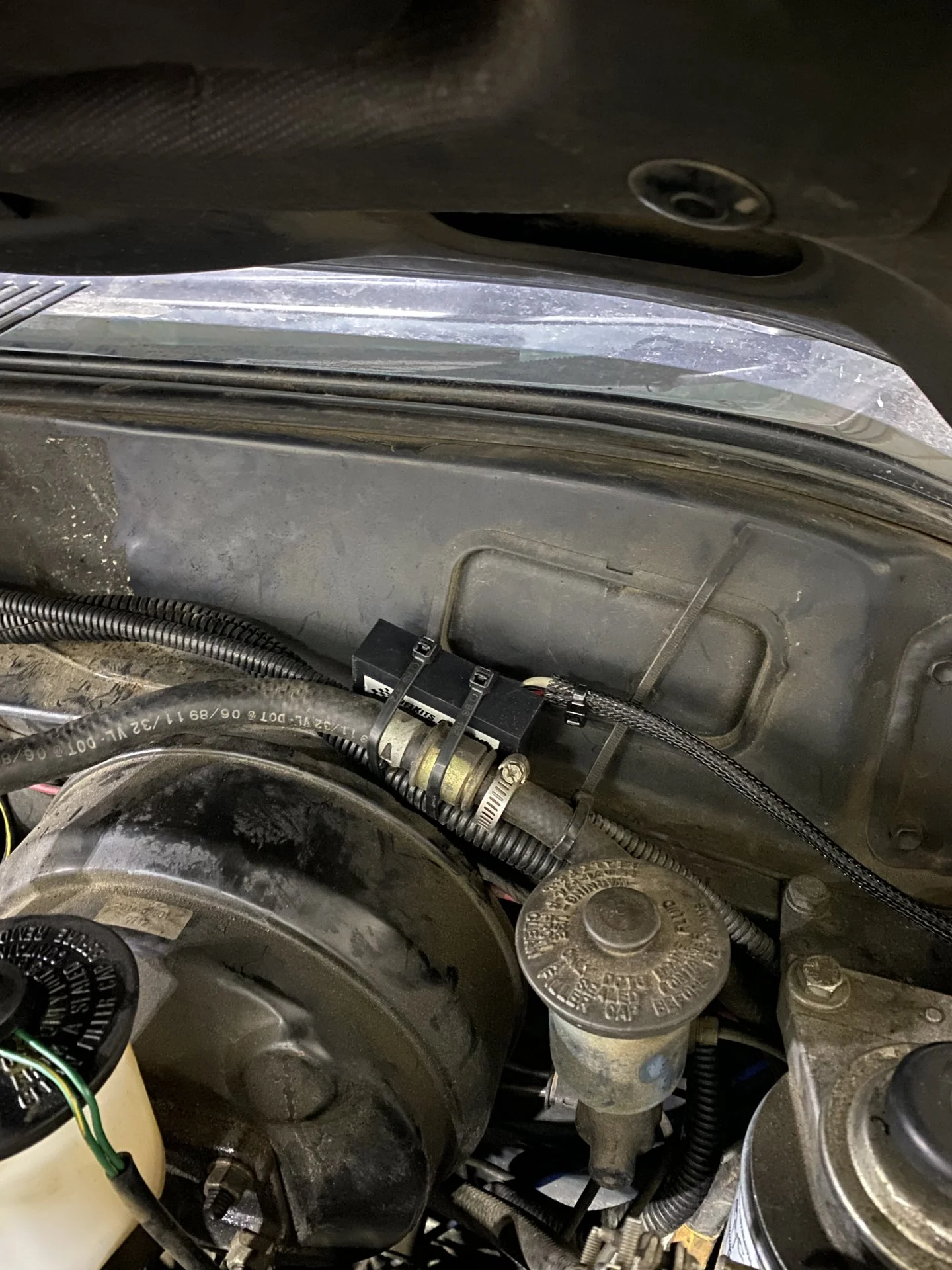

then it connects to the module through the green wire. the two wires in the shielded case go to the tach sensor on the injection pump. red to ignition power and black to ground. pretty simple and it works!!
testing it out to make sure it worked…
then ran the wires properly
except i forgot to run the power wire from an ignition source. i connected it right to the battery. probably doesn’t matter but i’ll do it right another night. too late tonight!!
but it works!
then it connects to the module through the green wire. the two wires in the shielded case go to the tach sensor on the injection pump. red tonignition power and black to ground. pretty simple and it works!! View attachment 3178830
then ran the wires properlyView attachment 3178829
but it works!
Are you adding this small box / kit mr. Franklin because you don’t have the sensor / signal pickup sender on the bell housing ?
HA 🤣 i guess i should give some context as to what i was trying to achieve!!
i put i 1hdt engine in my fj62 years ago. i wanted to keep the stock dash but the tach sensor on the injection pump only works with the diesel tach which i don’t have. so instead of buying a new tach that didn’t match i’ve been trying to get a way for my tach to interface with the diesel pump. i kind of let it go for a while while doing other things but came across this little unit on line somewhere and thought i’d give it a try. well my speedometer cable broke so last night while the dash was apart to fix that i figured i’d give this little guy a go! works like a charm.

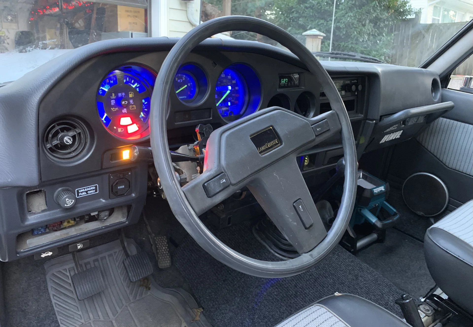

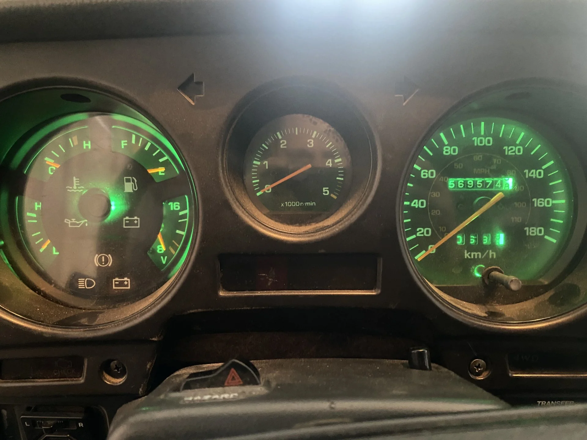

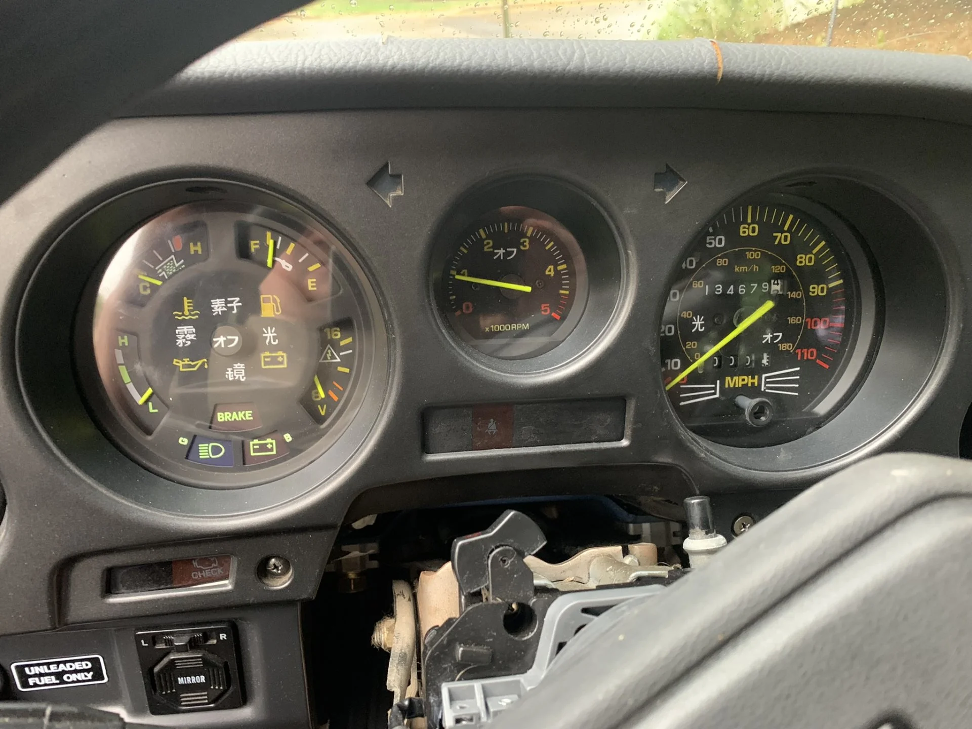

i dialed in my new to me 10/88 FJ62LG-PNEK Stock Factory Tach , that goes with my grand plan concept vision restore / build theme .....
I sourced all the speedometer paint Thu SUMMIT
I hand applied it with a traditional Quill 🪶
Details matter and matter do details

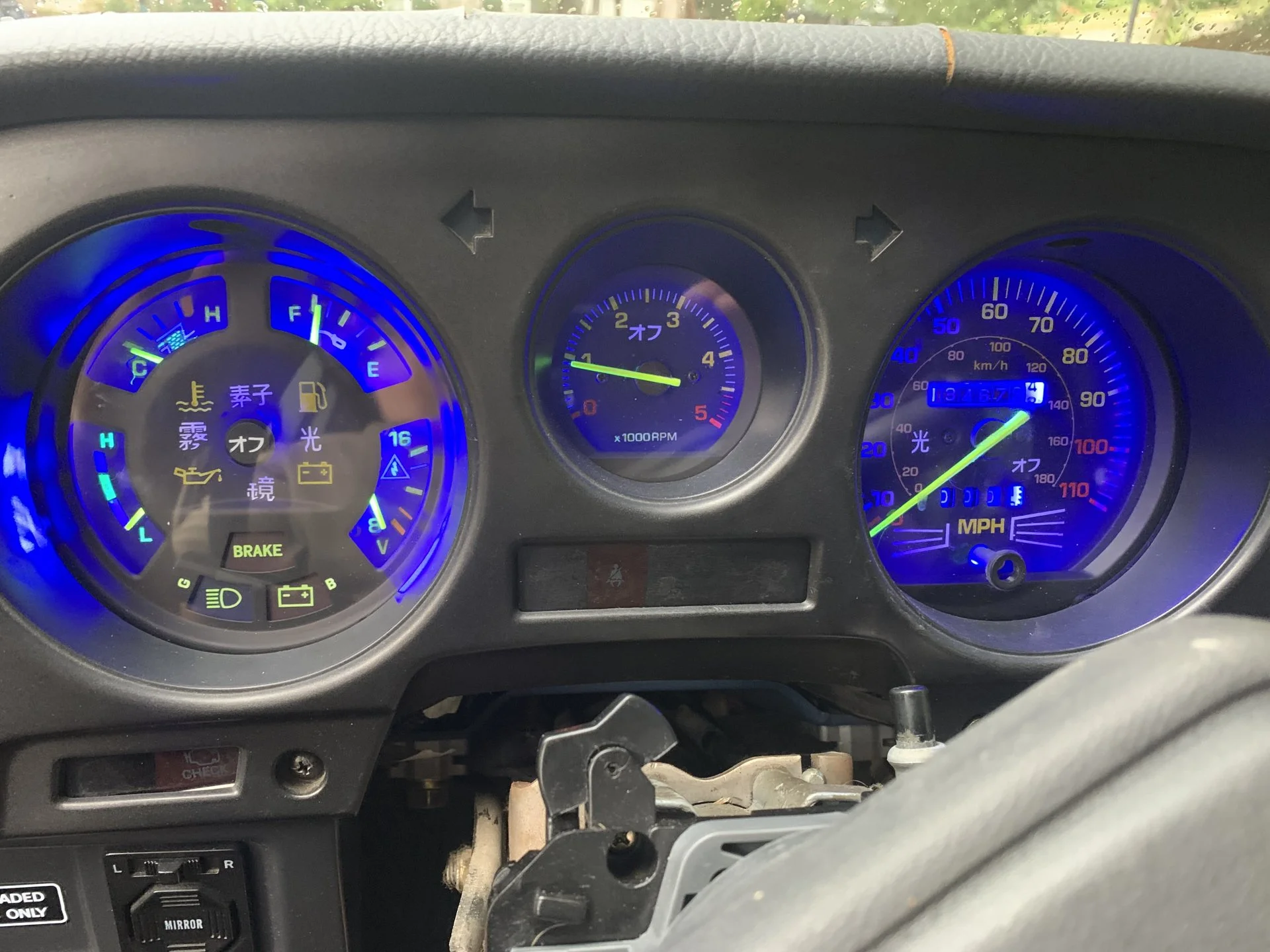

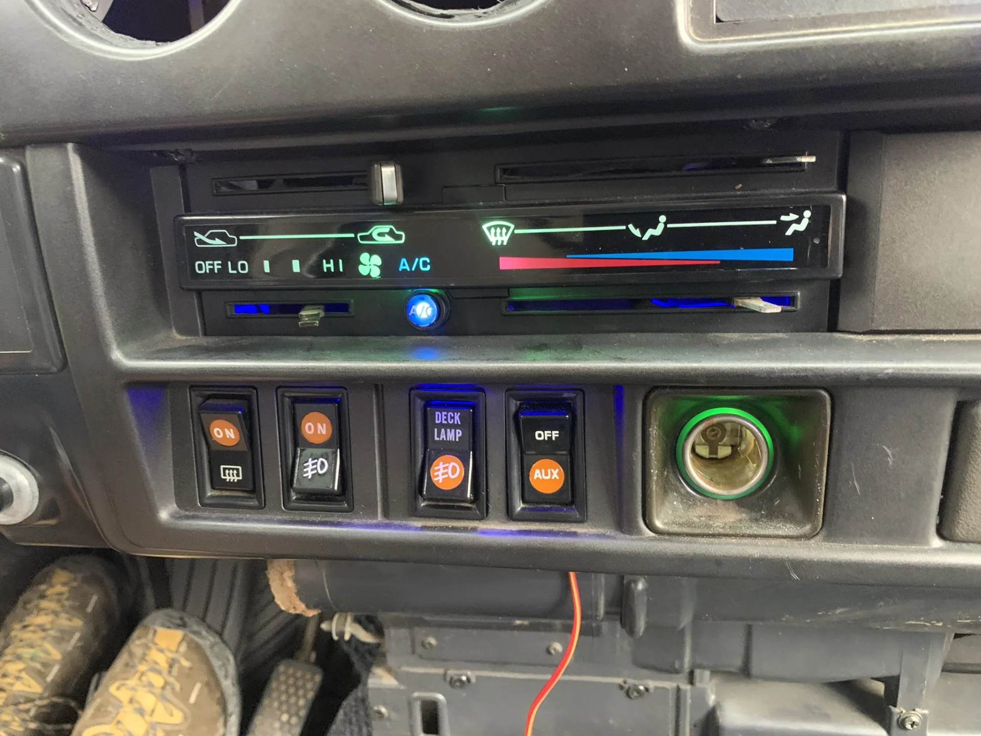

wow that looks great! i stuck with the traditional green even on my stereo. played with the splash screen a little too. all led except my 4WD and high beam lights. they were too bright at night
there to prove it works
and after confirming it was idling too high i adjusted that to 800. sounds awesome
