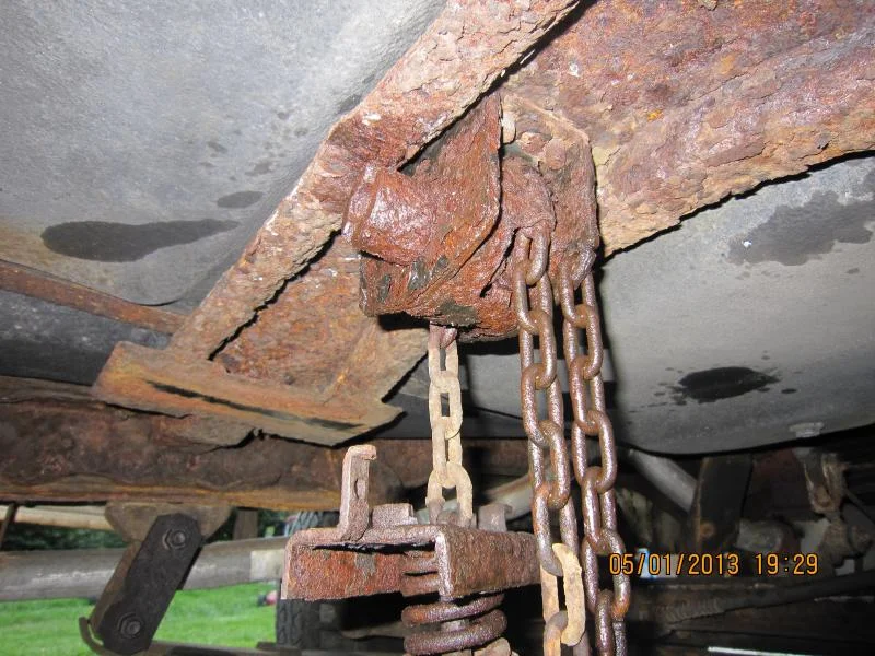

Hi Guys,
I think I figured out how to post pics and thought I would post a pics of my new LC and share my first challenge. I plan to reinforce the frame in there rear, the 1st step was to remove the spare. The spare tire hoist was seized, instead of cutting the chain I tried another approach. Since the spare was still inflated, I thought if I let the air out I could push it up enough to release the bracket attached to the chain enough to free the wheel. I used a Jack and some blocks to press the wheel up and was able to get it off. P.S. Disregard the jack stand, I thought the wheel might pivot off the hanger and the stand would hold it in place, but it wasn't needed.
Cheers!

Mine was seized like yours, I deflated the tire and I was trying to find a way to saw the chain, but the chain broke of before that...

Biche, I considered adding a before-pic showing the tire against the crossmember, your pics takes care of that. 8960, as long as the spare was stowed inflated, it should work. I knew I have my work cut out for me with this truck; but damn, the 1st task I did that should have been quick but took about .5 hour!
Wow, fun with rust.
Glad I live in CA.
Mine was also rusted but after a lot of wd40, oil, grinding and time it still does not work.
Then I bought a cheap wheel carrier wich had the lift in perfect condition.
The old one never worked, there are some small bearings inside, and some rocket science.
Wow, fun with rust.
Glad I live in CA.
X2
Not in CA but AZ. The one in my 62 is still in great shape. I have a few spare tire carriers. One off a FJ55 to use in my FJ45 and one I installed in my M416. Found just this last weekend the FJ40 rod with the hook is to thick to operate the winch. Better finding now before I have a flat and need to use it.
If I couldn't get it loose I would have just remove the whole carrier complete by unbolting it from the frame or in the case of the rust belt breaking the bolts. These are loose nuts and bolts so no worry about getting broken bolt out of a threaded hole.
