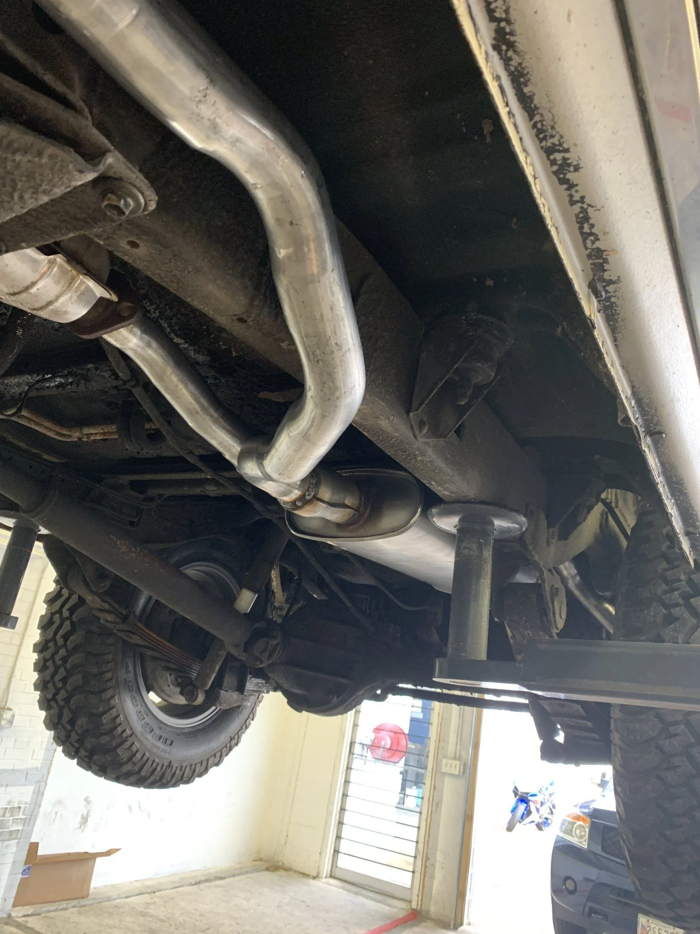

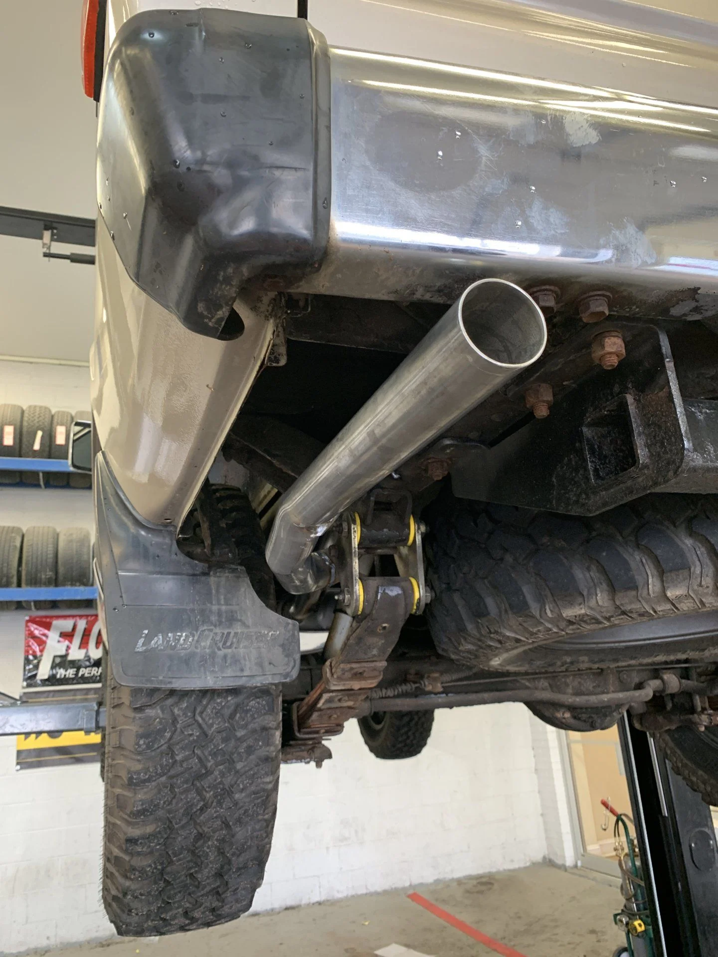

Following up on this. I ordered the Walker 21423 and it was too big imho so I sent it back. Eventually I got around to going through their entire Quiet Flow SS offerings and ordered a 21242 since it was the closest to the factory muffler dimensions.
I’m usually an OEM guy but decided to go for stainless since I could do it for less when factoring in the y-pipe replacement. Cats are universals that fit the 62 and ahead of that is stock.
View attachment 1952327View attachment 1952328
