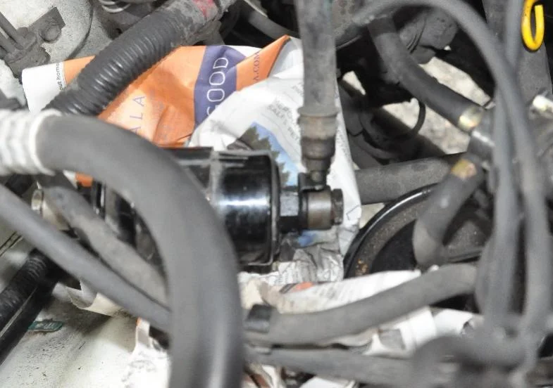

I could use some advice on how to break these 17mm bolts. Not a lot of leverage into this space and don't want to break anything important. I held the filter body in place with channel lock and tried both a socket and a 17mm wrench - but no movement. I put some PB Blast on it...

spray it with liquid wrench real goo and let it sit overnight. That always works for me..
Just changed mine last week, I had similar hard to get off issue. I used PB Blaster and let it sit for a few and tapped to vibrate it in there. Then I used a breaker bar and channel locks to smoothly break it free for one side. The other side that was tighter to get into, closer to the front if I remember correctly, I used a 6 point 17mm wrench, and lightly tapped on the open end with a ball peen hammer. You only risk breaking the bracket that holds the filter on the truck. Tap it while using a wrench to counter. Quick blows in the right direction didn't break mine.
Thanks. Glad to hear this is a shared experience Ray. I'll try the path you outline and let some additional PB sit on bolts this morning. I'll keep at it with more effort....
don't take this as an insult to your intelligence, but are you trying to loosen the correct bolt? in the photo above, the bolt to loosen on the right side of the pump is the farthest out bolt, the skinnier of the two bolts on both sides of the fuel line. the bolt that is between the pump and the fuel line on the right -- the thick and black bolt -- doesn't loosen. while the line on the other side of the pump -- the side not as clearly pictured -- is basically the same, if i remember correctly.
another thing, if your pump didn't come with new copper or aluminum washers and you'll be reusing the old ones, be sure to remove the lines gently. they're bent pretty good in their current setup, so they'll wanna spring off of the pump, and you might lose the washers in the process.

austinmark & ray - after sunday I was definately questioning my own intelligence and sanity... neither my fsm nor the aussie book (Gregory's?) gave much fidelity of detail of the fuel pump. The dusty third reference provided the detail of the pump with banjo bolts - so I did figure out the exterior bolts early on the process. For a 17mm bolt, the FSM showed approx 83ft lbs of torque - so if applied here, I see why this was so tight. Ultimately PB Blast, hammer taps, and cordless impact tool did the trick...the new toy filter was installed...

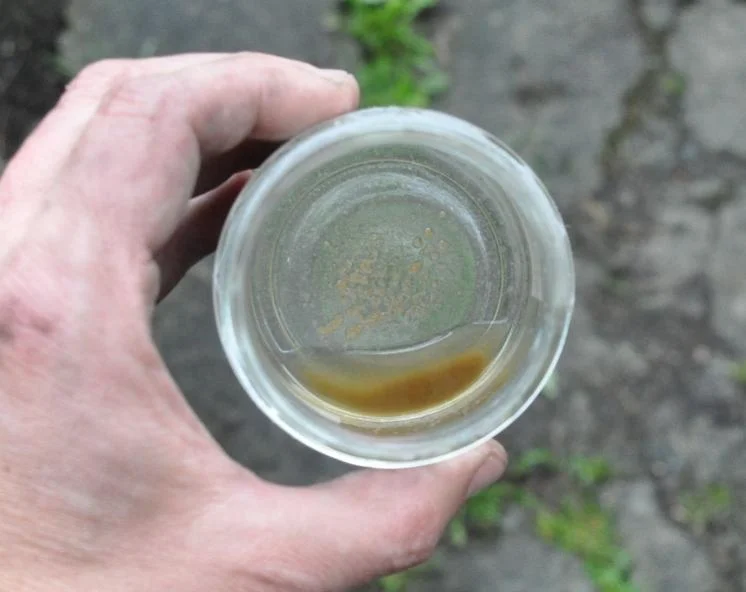

My read of the situation, is that any remaining fuel at the bottom of the tank must be junk - and re-clogged the new fuel filter. So my next step is to buy another 5gal gas can and fully empty the tank from the plug. I'm attaching a picture of the "fuel" that I poured out of the old fuel filter. Lot of particles and haze...
I'm hoping that draining the tank, adding some fresh and let it run a bit will let the fuel filter flush off some of the crap. But I'm open to a different diagnosis.

thats some pretty dirty fuel, but I bet that some of that was back-washed from the filter into your cup. I'm still going to guess its the fuel pump. It's dying and can't provide enough pressure for the higher RPMs required to go faster.

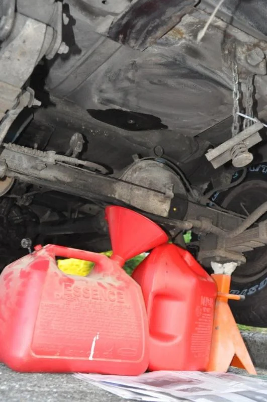

So tonight I towed the mighty cruiser back home 2 blocks (the ignominy - behind the family mini-van) and drained out the tank (wow 9+ gallons drained out - glad I had a spare can). Picture below. So I'm "airing out" the tank tonight and plan to put the plug back in tomorrow am.
My original plan was to put in a gallon of fresh fuel and see how the truck responds (after jumping it again).
Is there anyway to test the fuel pump theory? I'll read up in the fsm later tonight but welcome any inputs.
I'm well beyond my understanding of the vehicle (which is kind of fun) so very open to ideas.
Thanks from Seattle/Ballard
