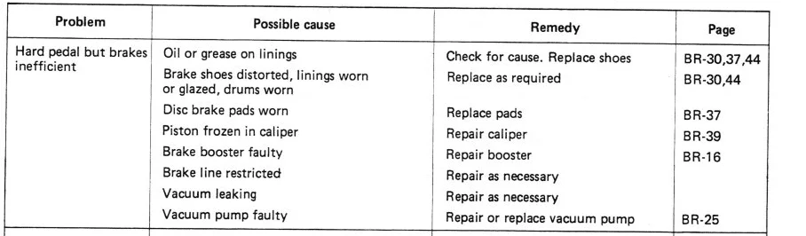

Brakes are fine for the first 5 minutes or so when I first leave the house. Brake pedal has its usual give and brakes function as they should. After I drive for a bit and it warms up, the brake pedal becomes stiff with no give. Engine is noticeably pushing through what seems to be stuck brakes. I’ll let it sit for a while and back to normal. Once I drive it again, the cycle starts all over again. Thoughts?
I'd start by checking the for a vacuum leak at the brake booster, and also the vacuum line going to the booster. My reasoning is that these are things that could cycle from normal to faulty depending on vacuum/vacuum leak.
So no wheel is overheating or smoking? I'm guessing if a brake shoe or pad were stuck ...that it would stay stuck.
Check your soft lines. If they're old they can look fine but they'll sometimes swell internally. This basically creates a check valve, lets you push fluid to the wheel cylinders or calipers but it won't flow back.
Drive it around until the brakes are sticking then jack up the front end and verify the wheels are hard to turn. With it still jacked up loosen the bolts between the booster and master cylinder, if they release it's in the booster. If they don't release loosen the brake line at the master cylinder to see if the brakes release. If they do the problem is in the master cylinder.
