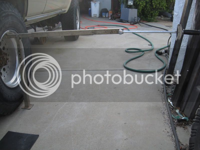

It's not computerized scale accurate, but it will get you really close; the Corner Scale Tool:
Easy enough to build, you're seeing all of it except a piece of paper that there is to the whole tool. Make the support foot adjustable, you want the horizontal bar to be horizontal at the point of taking the reading. Make the ratio of the horizontal bar something easy to work with. This one is 10:1 (to the torque wrench's handle pivot pin), so a 100 lbs reading on the torque wrench means that tire has 1000 lbs resting on it. Use the piece of paper to know *exactly* when the tire comes off the ground. That is when to read the torque wrench. Really helps to have a helper.
One of those fancy digital torque wrenches would be a trick feature and would increase the accuracy of the readings.
That's ghetto fabulous....
