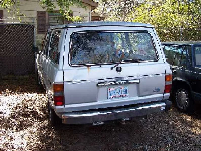

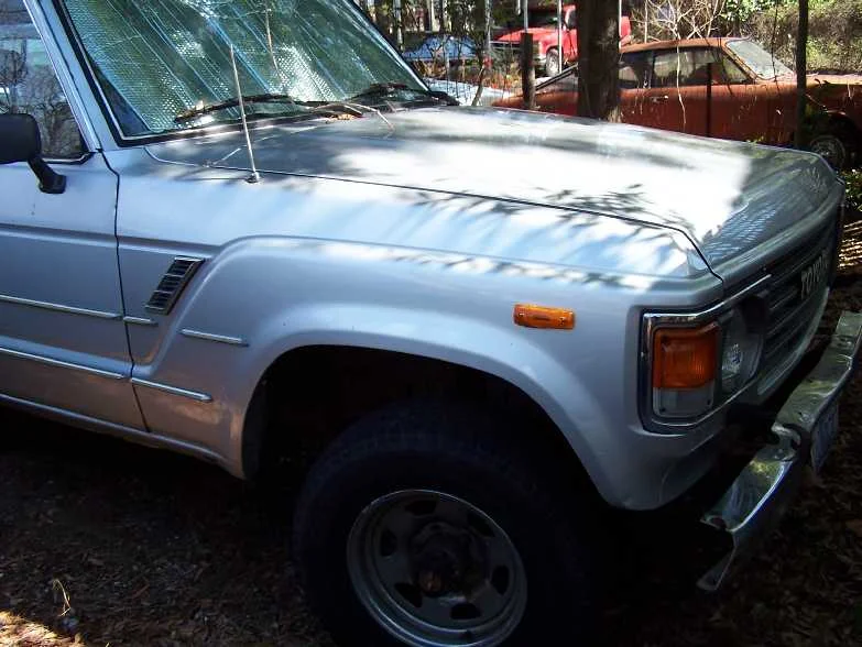

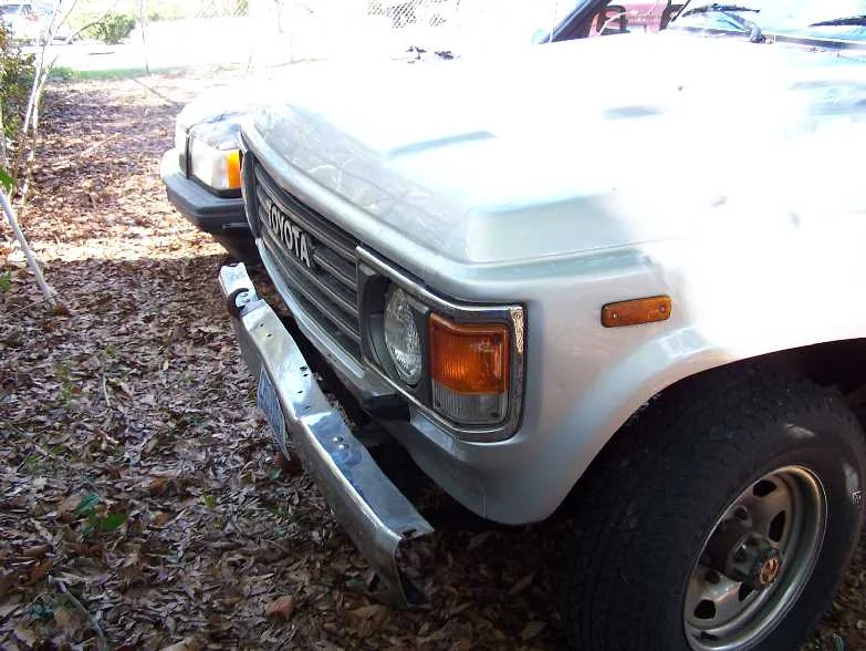

Here are some pics of the rig...Needs a front bumper too, but for what I paid it will be a good workable resto truck...

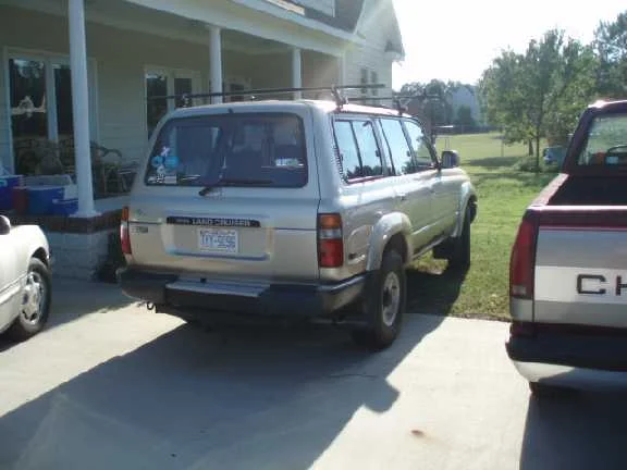

Here is a couple more pics...and a pic of my 80.
That is the first time I have seen the chrome like that on a 60 series.
I am still learning alot about the 6o series trucks/specs and history, but I am pretty sure that trim was likely "PIMPED"...
