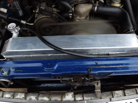

I got the old one out, took A/C condenser and other parts, but not the compressor. After getting all nuts and bolts off, labeling them, I waited till Sat.a.m. to install new rad. When I was finished, I filled w/ coolant and distilled water, tested it , and then realized I forgot to put the shroud on! I couldn't bring myself to undo everything, so I tried to find a sawzall or something to cut shroud in half. No luck. So I went to my job, 20 miles north of here, up a small mountain pass(Willow Creek Pass), over the top, down a valley for 5 miles. The temp gauge ran a little below half all the way, heaters on, no leaks or drips. 11 pm, going home, same thing, ran perfectly. I am so grateful for all the tips and encouragement you'all gave me. Now I know how to do it. It really isn't that bad. And now that the a/c condenser is gone, the air flow seems good enough w/o the shroud. I am going to get it cut in half, as so many have recommended. Its impossible to install it without removing the rad, or fan( didn't want to do that). ANyway, where I live, it never gets very hot up at 8,000 ft. I'll wait till Spring to install the cut in half shroud. I was worried when I realized I'd forgotten to install it, but then thinking about the temps here, I figured I'd just check it out and see how it goes. Next project will be draining and refilling differentials, trans, and transfer case over the next few weeks.
DSCF4015.JPG DSCF4012.JPG DSCF4016.JPG DSCF4017.JPG L to R : Old rad w/ JB Weld all over, after removal of rad & condenser, new aluminum top view, front view w/ new rad
Yeah, you really only need the shroud when the outside temps get hot, and you're not moving.
