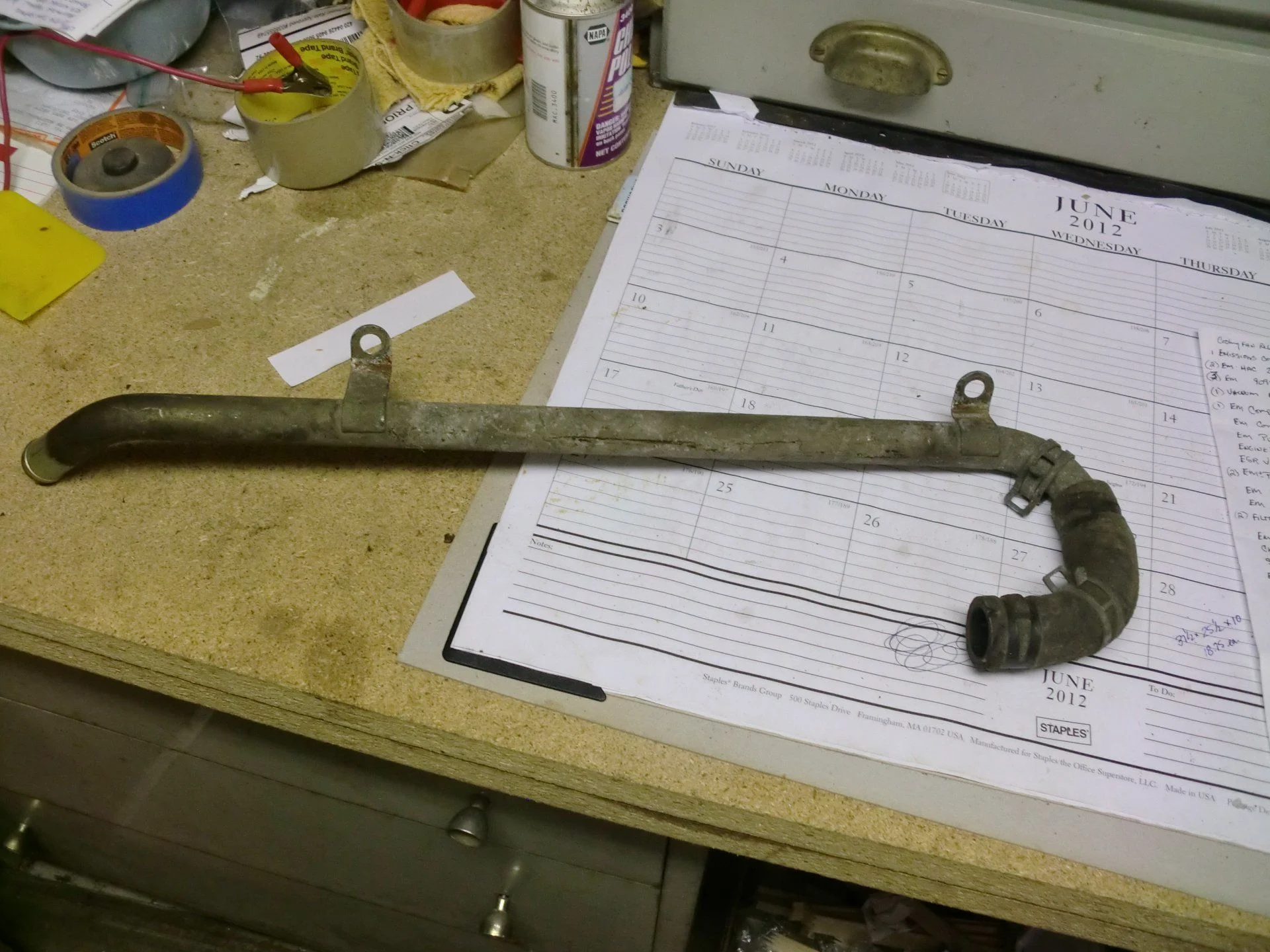

This hose came off a 1985 FJ60 but can't remember where it goes, I've looked at heater hose diagrams but find it hard to match this one up, could it be an after market pipe? Thanks
That's not a coolant pipe. It's part of the air injection/smog pump system. It leads air down to the exhaust pipe.
Thanks output shaft, so this goes from the ABV to the exhaust inlet check valve, I got the first five numbers of the TEQ stock number but not the last five, anyone know what they are?
