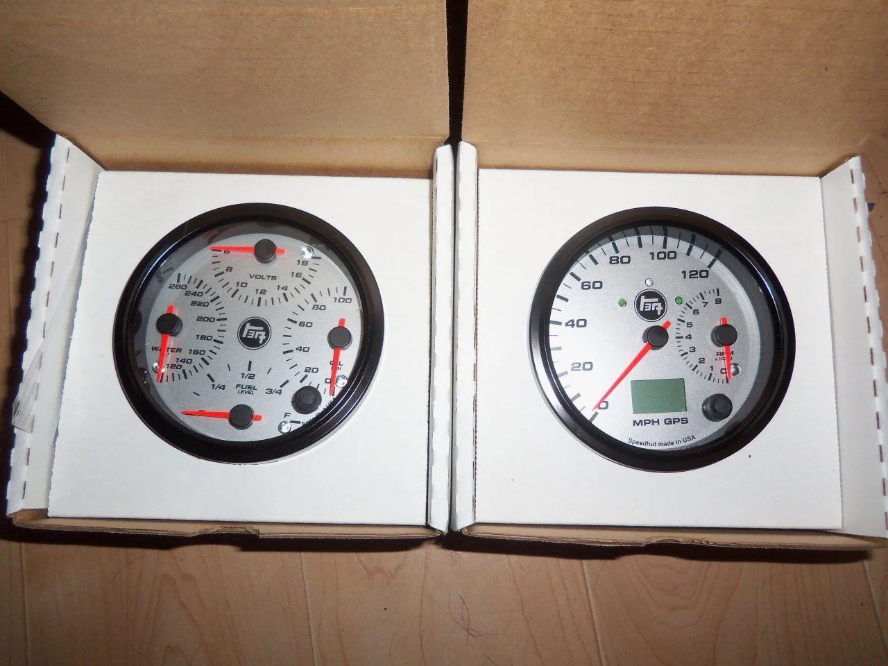

So... I've got the Speed Hut gauges and we're wiring everything up as I type this.
