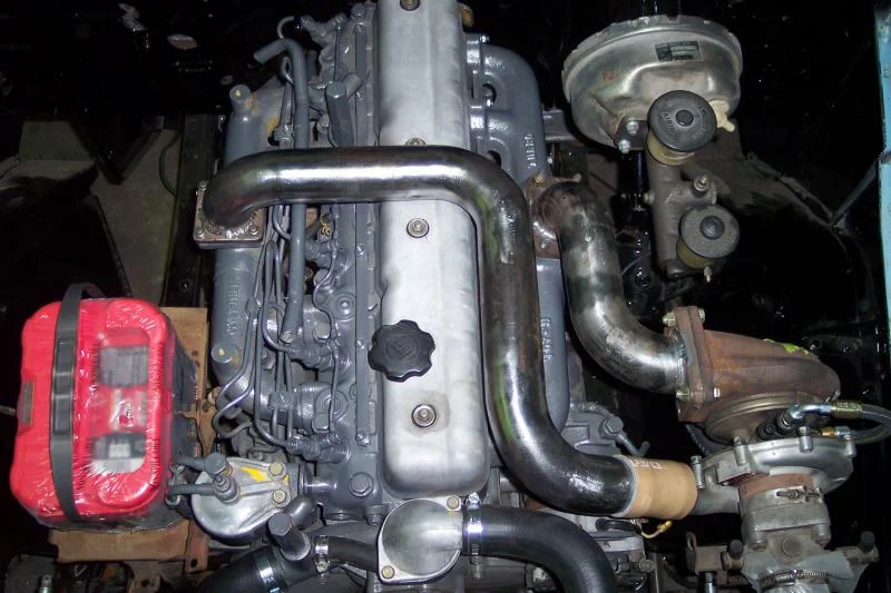

Draw-thru vs. blow-thru
I'm curious why you decided to setup the throttle body in front of the turbo in a draw-thru configuration instead of the more typical blow-thru setups found in kits from companies like Turbo-Glide?
attachment.php
I wonder how the injection pump diaphragm will react to the stronger vacuum created by the turbo?
sometimes it just takes a little time. A few updated pictures, got the lv running, put a few miles on her last couple days. so far so good. Boy where do i start, got the motor running late last year, siezed up the rocker arms due to no oil to overhead, then the turbo was pushing oil. Long process of wondering why no oil was getting to the overhead?. Ended up right from the start, it had a new head gasket from wherever SOR got the engine. WRONG HEADGASKET, that was interesting finding after ordering a new headset from sor being the same as what came off. Beating our head, we finely got the right set. Home free, nope. Rebuilt turbo, test ran still pushing oil. come to find out all ready been reman and bored over, no parts available. Tracked down the same turbo from a used tractor parts shop here in town. Seems to be running good. Took time to do all the time consuming wiring, with a glow plug timer. It has been a quick few years, their was just never enough time, many excuses. Its on the road.
