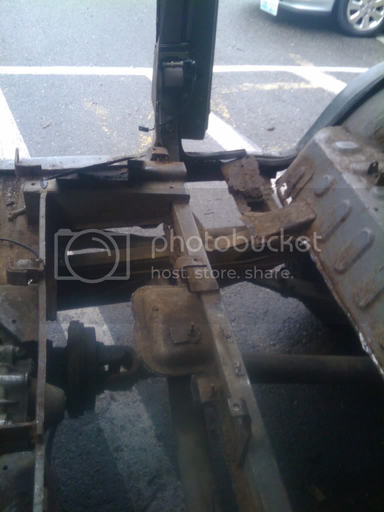

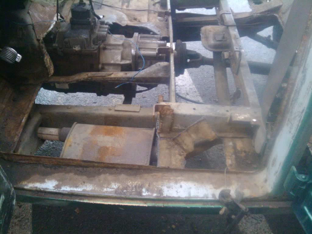

hers the pics i trully dont know too much about cruiser, my dad had this when i was a kid and i fell in love with it. i had the choice of keeping his cruiser or his house when he died and i picked my 45. i dont know if its an LV and dont know the difference. the tittle is MIA so all i know is its a FJ45 Wagon with a chev 350

Cool rig! It's really, really cool that it was your Dad's.
That is indeed an FJ-45LV. Mark is right on about the floors, and now that he mentions it, I do remember that about the windshields...
Speaking of Landcruiserjunky: are you planning on upgrading to dual circuit brakes? You don't want your LV to end up like his did. Yours is pretty nice, really, and being that you inherited it from your Dad it's a tad on the priceless side...
It looks like you're in MT (well, the plates do, the rain in the pics sure don't). There is an EXCELLENT source of parts/knowledge in Helena if you need to know more about the early trucks. I wish I knew more about them, they are just so much cooler!
