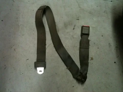

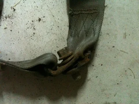

My FJ45 is registered as a 3 seater. It however only has 2 seat belts and I would like to convert this back to 3. Does anyone have a layout or picture of how the seat belts are mounted in case 3 people would sit in front safely?

Nice truck! In Australia we had three seatbelt 45's but I don't have pics to show you unfortunately. I know because I had a HJ47 and my old man had a BJ40, both with three seats in the front.
As for the extended shackles in truth it's a quick fix to saggy springs and will potentially lead to terrible handling. If you're of the do it once, do it right persuasion then I'd find new springs or have the old ones reset. Do your bushes at the same time.
Just checked my hj47 seat beats that I have in a box. The middle seat has an adjustable lap belt that uses the same mounting hole/bolt as the drivers seat belt receiver and the middle belt receiver shares the passenger receiver mount/bolt. So now you just need to find a centre lap belt, bolt it up and your away with 3 safe and sound. Hope this helps
