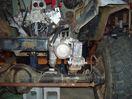

in the bottom picture in post #69 you need to rotate the lower shock brackets 90deg so the shock eye is parrallell to the axle, not perpinducular to it.. when the axle articulates the shock will not rotate at the bushing correctly the way you have it now.. this will destroy the shock bushing or break the eye off the end of the shock...
one other thing is try to angle the shocks "in" a little at the top.. this will allow them to actually "work" under articulation... having them straight up and down only allows them to "swing" side to side when the axle articulates, not compress/extend per se'

Are your rear upper coil buckets just located on the bottom of the frame rails? Or inside? Have a good close up pic?
I know this is too late, I would have done a 3 link front with a track bar. A lot of aftermarket companies are doing so on TJ's. They work and handle excellent.
inside i am thinking of moving them to under the frame here is a pic the way they set right now and as far as a 3 link in the front if you have some good info i would like to see it. my fj will be my dd so would like it to drive good no the road
Thanks for that pic. Why are you moving them under the frame rails? Clearance for the shocks?
What info would you like to see about the three link?
