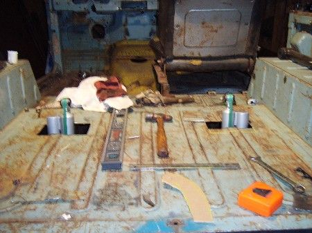

i got the rear shock mocked up in place. cut holes in the floor. made an upper shock mount out of cardboard will put on steel some time this week. had to cut some of the coil buckets on the right side damn stock toy axle i used 13 1/2 in of stroke out of the 14in travel thanks for the good info on what shock to run tranny should be here some time this week but i need a bellhousing for it and a tcase adapter will get some pics up tonight:beer: and one other thing has anyone put a gas tank under the drive side seat. not much room under the 40
pics are here tell me what you think. i know the shocks are not at the right ride height. it was easie r to work with them in the band.:grinpimp:

Don't worry about not getting much feedback. People look, but just do not comment. Been there too. You get a bunch of work done and post up the pics and you have like two folks to say something.
