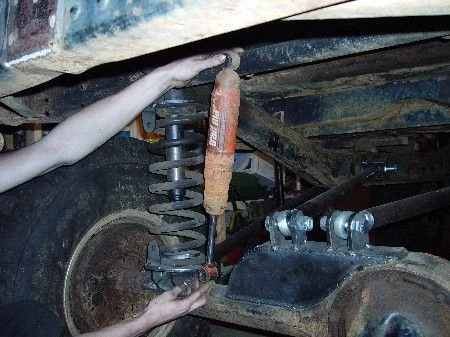

"i" dont think that shock is going to be long enough for a link suspension and alow the suspension to travel
"I" think so too. The shock itself looks too short and mounted in that location will not allow enough travel, no mater how long the shock is.
i will be get new shock when the time come.but they will work for placing new shoch mounts. what i need to no is where is a good place for them.or should i get new shock right now.

i dont know if it is in the budget but i would say new shocks now, you need probly a 14" i know when i bought my proffits kit he was saying to run a 16" but it also depends on youre reardriveline no point in running that long of a shock if you cant use it all.
i need to no is that a good place to put for the shock. what kind so shock did you use coolcruiserfj40 pics of your would be cool thanks

haha you dont wana see or know what kinda shocks i used, no pics of the set up grogan pushed me over to the buggy side so the 40s on jackstands still.
Mount the bottom as low and outboard as you can on the axle and make some brackets for the shock to be mounted higher on the cross member. Angle the shocks in like on a stock setup. The further appart the mounts are the more travel you will allow for.

The shocks should be as vertical as possible, when pushing them in on a angle it allows more travel but has a different leverage on the shock and makes them less effective.
But the problem with vertical is you would have to cut into the floor and make shock towers.

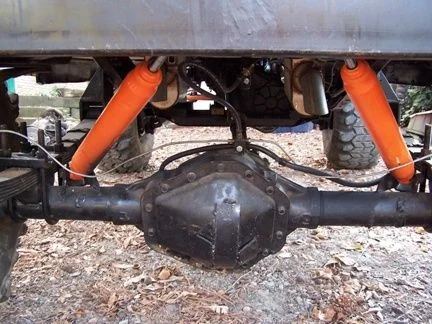

I run 14" stroke Bilstein 5150's on my suspension, all 4 corners...
the rear shocks mount behind the axle and are near-verticle...yes, they do extend about 5-6" thru the rear tub to a custom crosshoop.
my suspension uses ALL of that 14" of stroke, front and rear....you want the shocks as verticle as possible for maximum dampening/control and you will need more than those cute short ones you show in the pic ;)

woody can i get a pic of the crosshoop. for the rear thanks did you make hoops for the front thanks for all the help
rear:
not sure I have any of the front, but it looks just like every other tube-type shock hoop in the universe...
this gives ya the idea tho...
