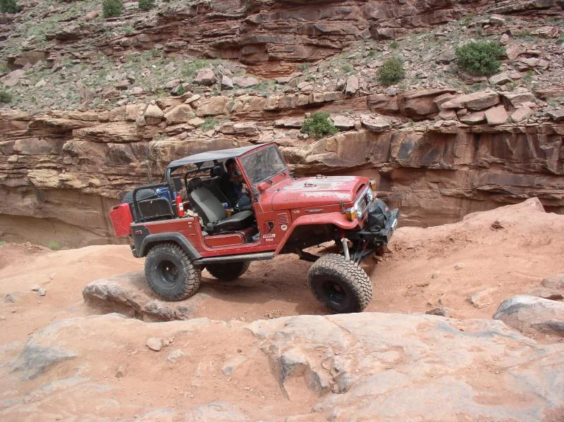

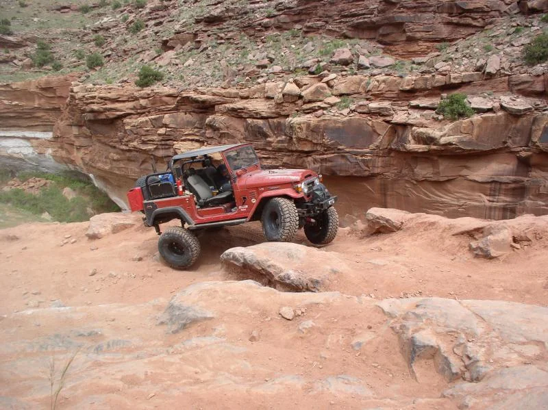

I remember the first day I did my spring over...still had the springs I was using before...factory w/ add a leafs ....shackles that were as long as half the legnth of the springs...and tiny 235/75 R 15 tires....was funny...wish I had pics of it...that was over ten years back!...just had to take it out for a spin befor I made new shackles and put larger tires on her....felt like I was going to tip over....awe the memories!
It flexes well now....for what it is..:cheers:

Have you run over a mattress lately?;) I've heard it can cause driveline vibrations...:meh:
Ed
no i havent run over any mattresses but f*@!k are they gonna have fun getting that one out
what other modifications have you made to your truck? after seeing yours im inspired. that flex's really well, and what shocks do you run?
I've never run over a mattress before...but hit a road construction sign laying flat on the ground that flinged up side my cruiser and gashed the right side door.....but crap...never like that.....cool!
