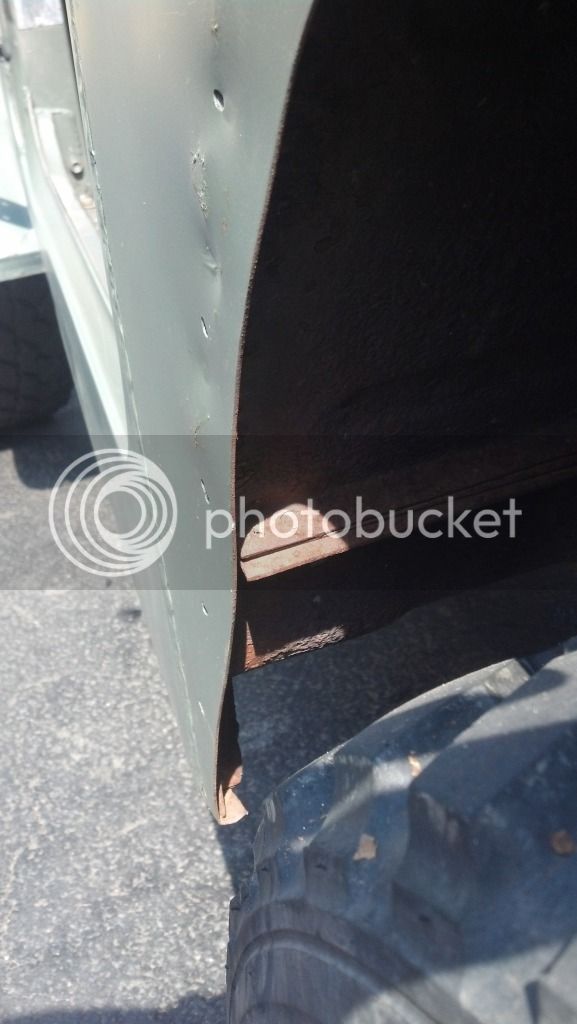

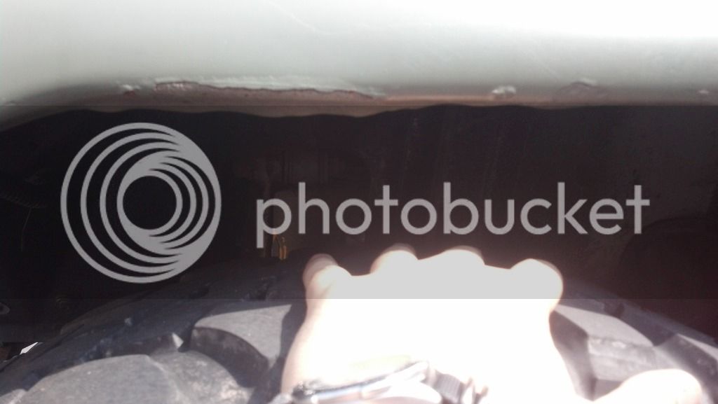

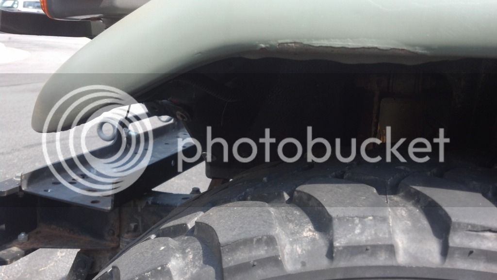

Think i'm going to try the fender cut option. I have about an inch of metal to play with at the front of the rear fender and plenty of rear fender to trim.

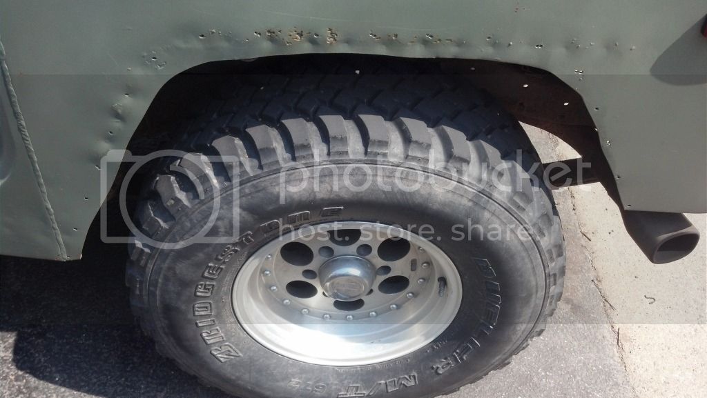

32 on there in the pics. I'll have to check how the 33/1050 on fj60 steelies fits soon.
The fronts are where tire width and wheel backspacing will matter. I'll likely have some rubbing on the inner lip of the front fender. but maybe not significantly more than what I already have w/ the 32s.
