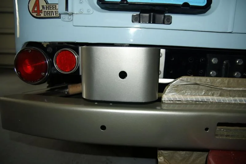

I just did the same thing on my 72 FJ40. I painted the bumper black back in 74 when I mounted the winch and since then also painted all those other pewter parts black. Now I'm going back to the original color scheme.
I purchased 5 cans of the pewter paint from JT Outfitters and with them did heater parts, glove box cover, dash, bumperettes, door inspection panels and handles, seat frames and a couple of seat backs. The cans worked well, and the color matched the factory color pretty well; I found it a little less bronze/gold than the original paint for my year. The paint quality is good; it applies well and can be polished and waxed to a good sheen. The down side is the durability. It scratches more easily than the factory paint. Consequently, when it came time to paint my front bumper, this lack of durability was a concern so I ordered the hardened paint from CCOT.
I just finished shooting the bumper a few days ago and am pleased with the result. It is a closer match to my original factory color than the JTO spray cans and has a much better sheen though I would expect that given the can vs a spray gun which can be adjusted perfectly for optimal application. I expect the hardened paint (CCOT) to be more durable - time will tell.
So, all this means nothing without pictures so here are some comparisons. The first is my old, newly refinished bumper (bottom) setting below a one year old factory replacement bumper (top). Good match. The second photo is again my refinished bumper below the bumperettes which were painted a year ago with the JTO spray cans and buffed. Again, good match but not perfect, and the CCOT paint has a better/deeper shine and does have the bronze/gold hue of the original paint. All in all, I think both colors are OK since even the original paint has aged and probably isn't the same color as it was 40 years ago.
My recommendation: if you have a compressor and spray gun and have a lot of items to paint - the CCOT half gallon kit is great. If you don't have the tools and/or just have one or two items to paint, the JTO spray cans do a very respectable job but you may have to be more careful with the parts and expect to refinish them down the road.
So, there you have it.

This is a bit off-topic but since the picture is in this thread. Kayaker, is that a new OEM reflector you have on your restored rig? It looks new, and I have been trying to find out if Toyota still stocks this part. If it's OEM would love to have the part number. Cheers.
Mark
Hey Mark,
Good eye! It is an OEM replacement albeit two years old now. I purchased it from CCOT for $38 at the time. It's still available but a bit over $40 now. Cruiser parts are doing better than my IRA. CCOT's part number is 61910-89015r but since it is OEM, you should be able to get it through your local Toyota dealer if you have a guy in the parts department that knows how to look up parts for vehicles without a 17 digit VIN.
