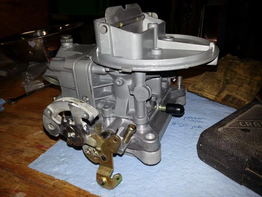

1977 fj40 with headers, Holley 4412-3 carb. Valves are set correctly. Dizzy is vacuum advance,new from city racer. Carb is clean, new kit installed with #35 nozzle and 4.5 power valve.
Engine starts great, idles great, accelerates ok until you make it pull and it falls off, hesitating unless you really mash the gas, then runs smoothly at a steady state.
Questions
1. What are timing recommendations ? Mine is set to where bb is at bottom of window, about 13-15 btdc. Then hook vacuum line to manifold vacuum and it advances out of site at idle. Should I hook vacuum advance to ported vacuum on carb?
2.What pump nozzle are you running? Carb is clean, float set properly and vacuum holds steady at 18 inches after idle mixture adjustment. Pump nozzle was a #28 and I changed it to a #35. Did not seem to help.
3. What power valve are you running? Mine is a 4.5 and I have ordered a 8.5.
I am not wheeling this unit, I just want it to run smoothly.
All recommendations will be appreciated.
Thanks

We have liftoff. Installed 8.5 power valve and that was the final piece to the puzzle. She purrs like a kitten and has gobbs of power. For the record, #61 jets, #35 nozzle and 8.5 power valve. Timing set with bb at bottom of window(vacuum disconnected) and then hooked to manifold vacuum. Will fine tune tomorrow as I want to check point dwell again, set idle at 650. 🚁🚁🚁
Thanks for everyone’s help and ideas.
