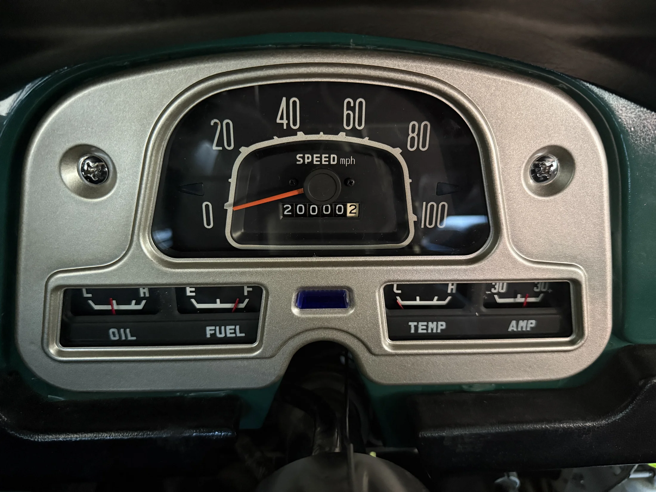

My original 1975 instrument cluster - the odometer stopped working ( well the 1/10’s work).
On my 2nd aftermarket KPH cluster - both 50 amp meter burned out. Temporary- on the 2nd one - I did a hatchet job and installed my old 30 -amp meter - but that’s not a long term solution
I suspect that shunt is needed. And/but in a thread here mentioned that maybe you had a solution.
The meter didn’t come with a manual.
@Coolerman or other have a a solution - I’d love to hear it.
So what's the secret ?
I would suggest you mail me your original cluster. I can fix your odometer.
The 50amp fuse needs a shunt to work otherwise the amp gauge will fry. I saw your pm will reply back to you.

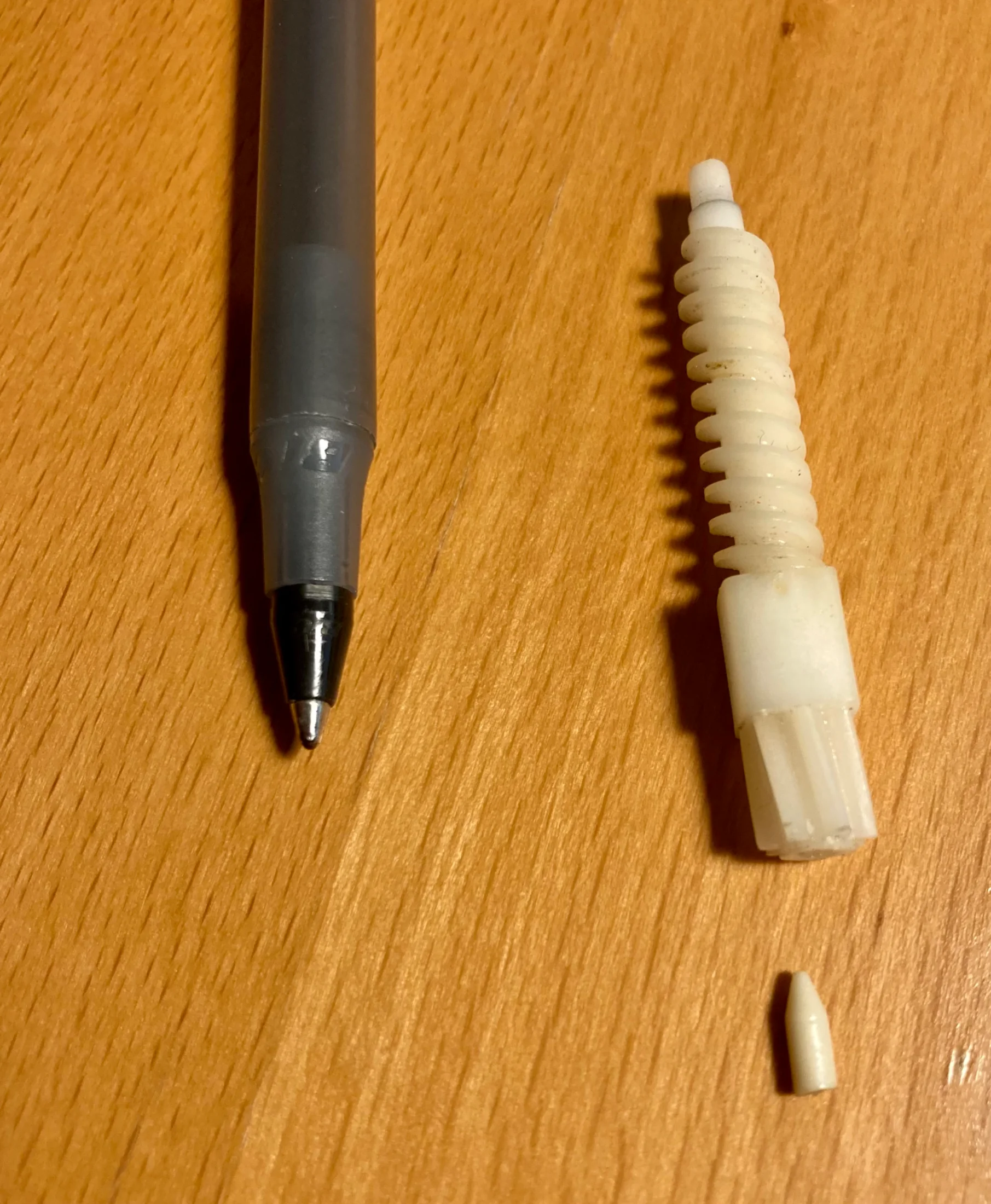

Sorry to hi-jack, but I’ve got an early cluster (1967) and couldn’t repair my odometer. The gears are metal and have ground smooth. Is that something you can repair?
@nabbasi I dont have any early speedometers at this time. I do have some gears though. PM me with a picture of what you need and I can see if I have it.
I wrote you a while ago but curious if you’ve run into one of these lately?
Was thinking of buying a new cheap one to rob parts but Chances the parts are different are pretty much assured.
Thanks. No I am KM which may be why you didn’t have anything at the time.
