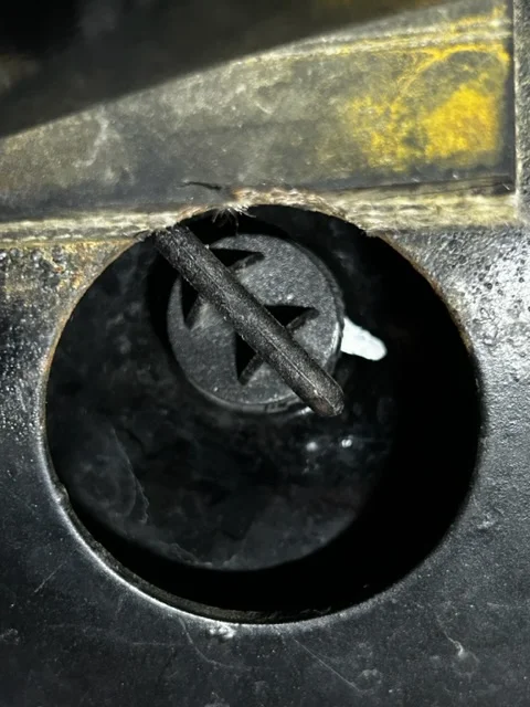

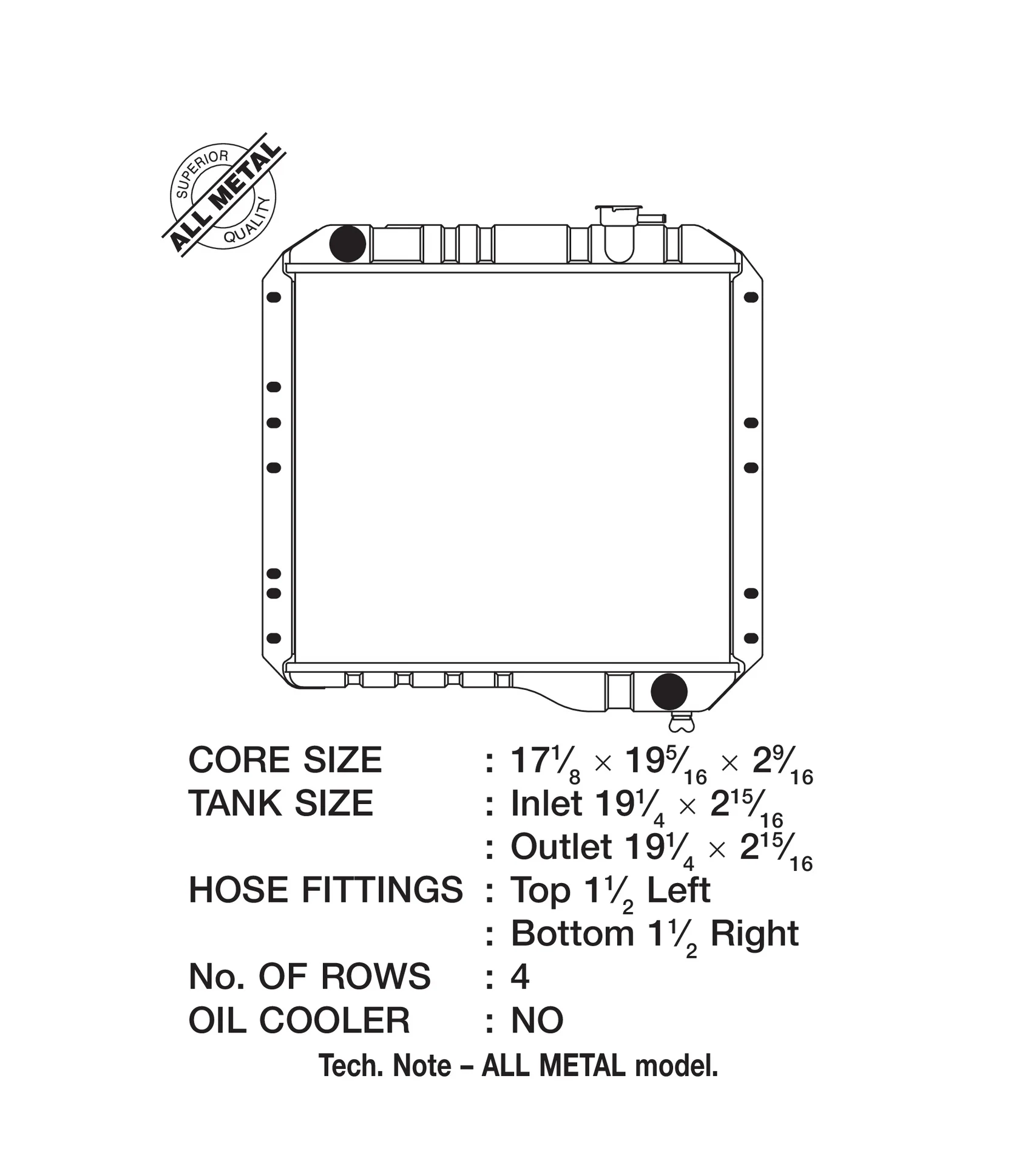

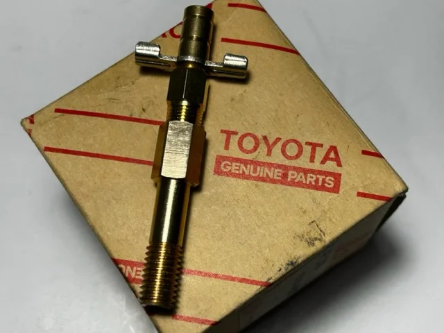

First, my radiator is an aftermarket 4 row type made by CSF. The drain plug is annoyingly off set inside the 53108-60013 radiator support making it difficult to use the plastic drain plug. I decided to just undo the lower radiator hose for each time I drained and flushed the system. The drain plug size is an M10x1.50. I contacted CSF directly to order a replacement plug, in the event I ever break it, and they have none in stock nor could they confirm the plug thread size.
Image below shows the drain plug offset. This has been well documented on ih8mud with several creative options to solve for it but no vendor @ToyotaMatt has yet to offer a proven extension and petcock product. I chose to experiment and make my own but am on the fence with using it. It will be a back up to my plastic plug.

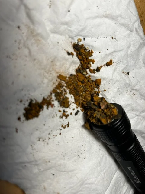

The radiator coolant appeared clean upon inspection per the FSM but look at what was found after flushing. This is metal as you can see it sticking to the flashlight magnet bottom.

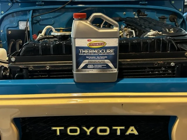

Once this was discovered, I opted to try Thermocure by Evaporust now CRC.

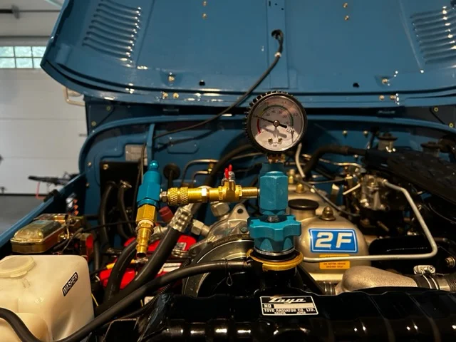

Followed their Instructions and then drained and flushed several times until no more rust flakes drained out. Each time I filled with distilled water I used a cheap $35 vacuum filler to not worry about having to burp it each time. It was a huge time savor.

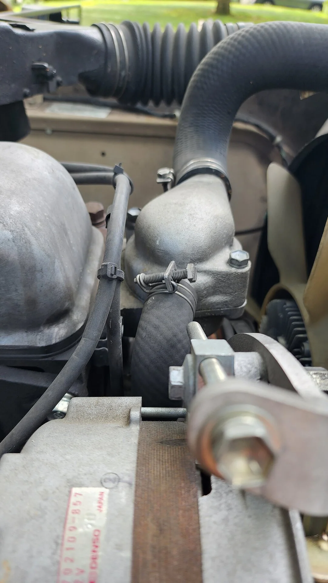

Next I changed my water pump bypass hose and then upgraded all hose clamps to the OEM type made in stainless steel by Cityracer.

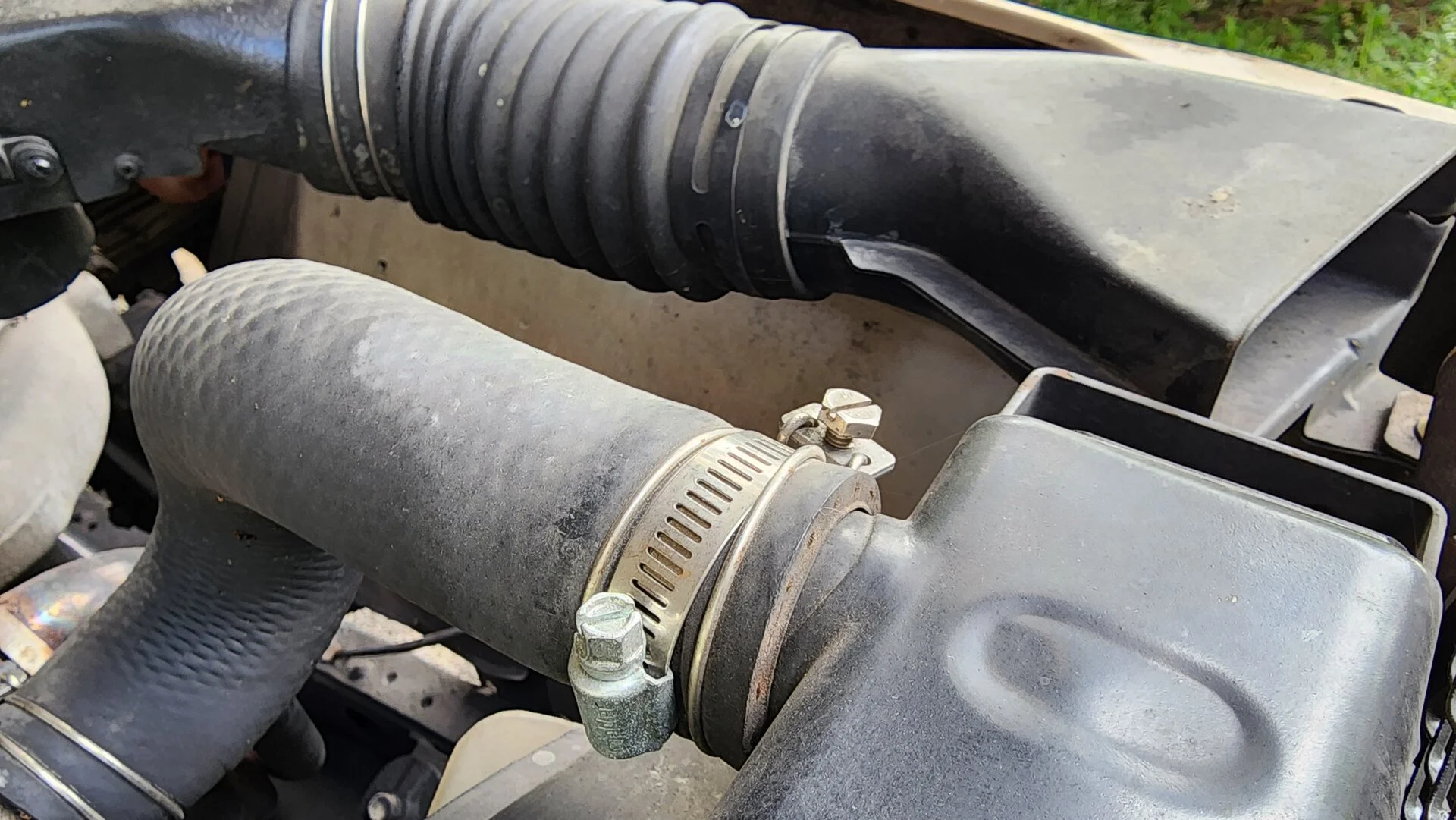

Thanks. I’ll keep an eye on mine. The vacuum filler evacuates all air and if it holds vacuum, theoretically it confirms clamps are holding. Things change, move and expand and contract... Time will tell. What clamps do you run on non OEM hoses?

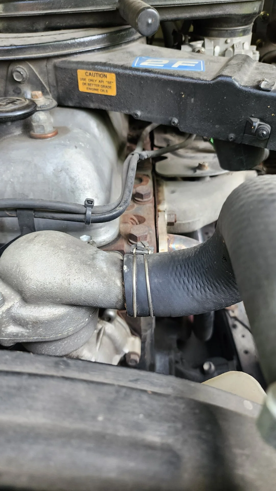

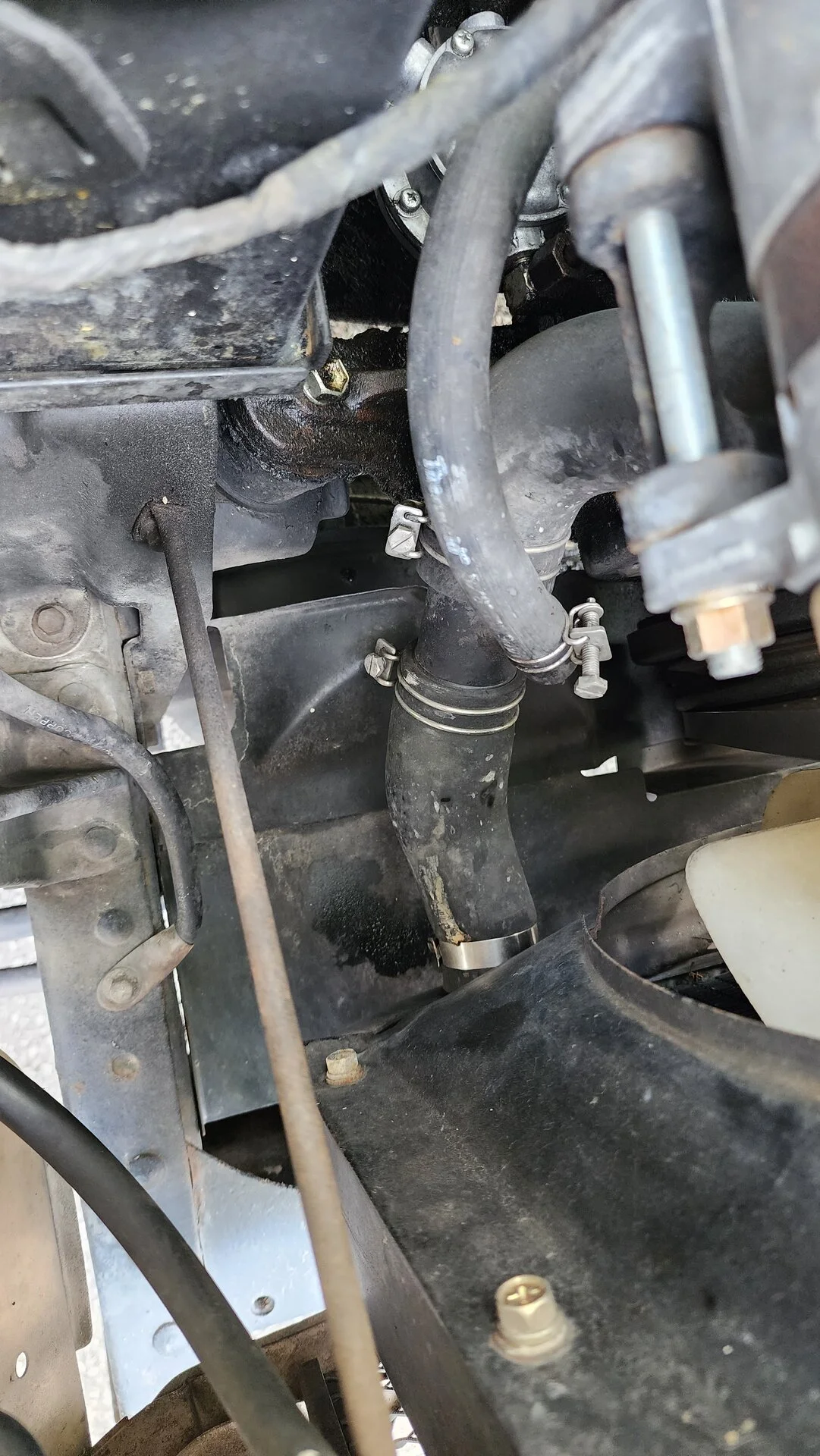

whatever worm clamps. in my case, i nearly ran out of adjustment on the clamps when the hoses were new...once everything aged a little, i was chasing water leaks and was unable to tighten the clamps any further.
After looking, the hoses i had problems with, actually are oem...the double clamped upper hose, was an on the road parking lot job....i just haven't gotten around to removing the wire clamp...a year or two later.
The smaller dia clamps are good, with plenty of adjustment left in them.
I like the look of the the OEM-style hose clamps, but like @brian I had difficulty getting a proper seal. I ended up going with ½" Solid Band Scandvik Hose Clamps (www.fisheriessupply.com)(# 382003, 382005, 382001, and 382009 (I ordered 8 size 10's, 4 size 20's, 4 size 24 and 10 size 28's ) I believe these were recommended by @GA Architect in his exceptional build thread but I may be mistaken.
I just use oem hoses, clamps…no issues ever on multiple/many F’s/2F’s?
If not non oem hoses for NLA hose and oem clamps are just fine.

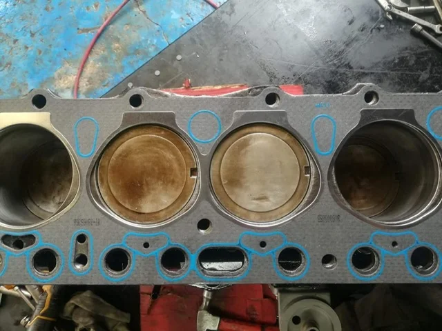

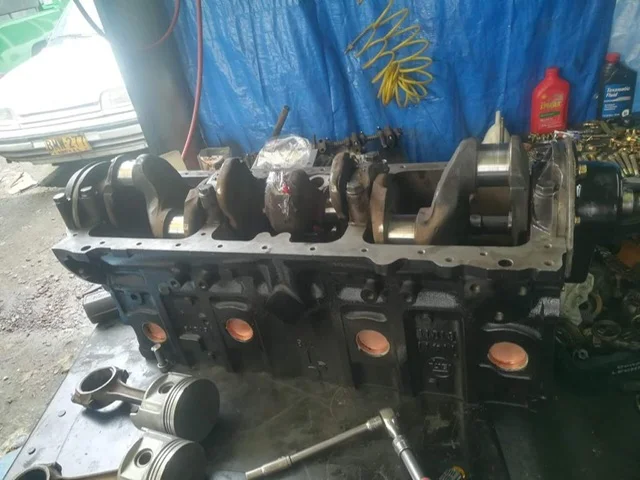

I’d likely be curious why you have clumps of rust - that’s either from your rad or leftovers inside cooling chambers in motor most likely. Since your truck is South American - can you trust the details if you haven’t seen inside the cooling area in the block? I usually inspect and blow out/rinse then dry with compressed air/brake clean etc.
The engine was rebuilt, not by me or with my direction, so it is likely the Colombian shop never cleaned out all the rust.
The rust came out of the engine block drain. I’ve learned that rust flakes settle to the rear section of the block near the drain plug.
Images of the engine being taken apart.

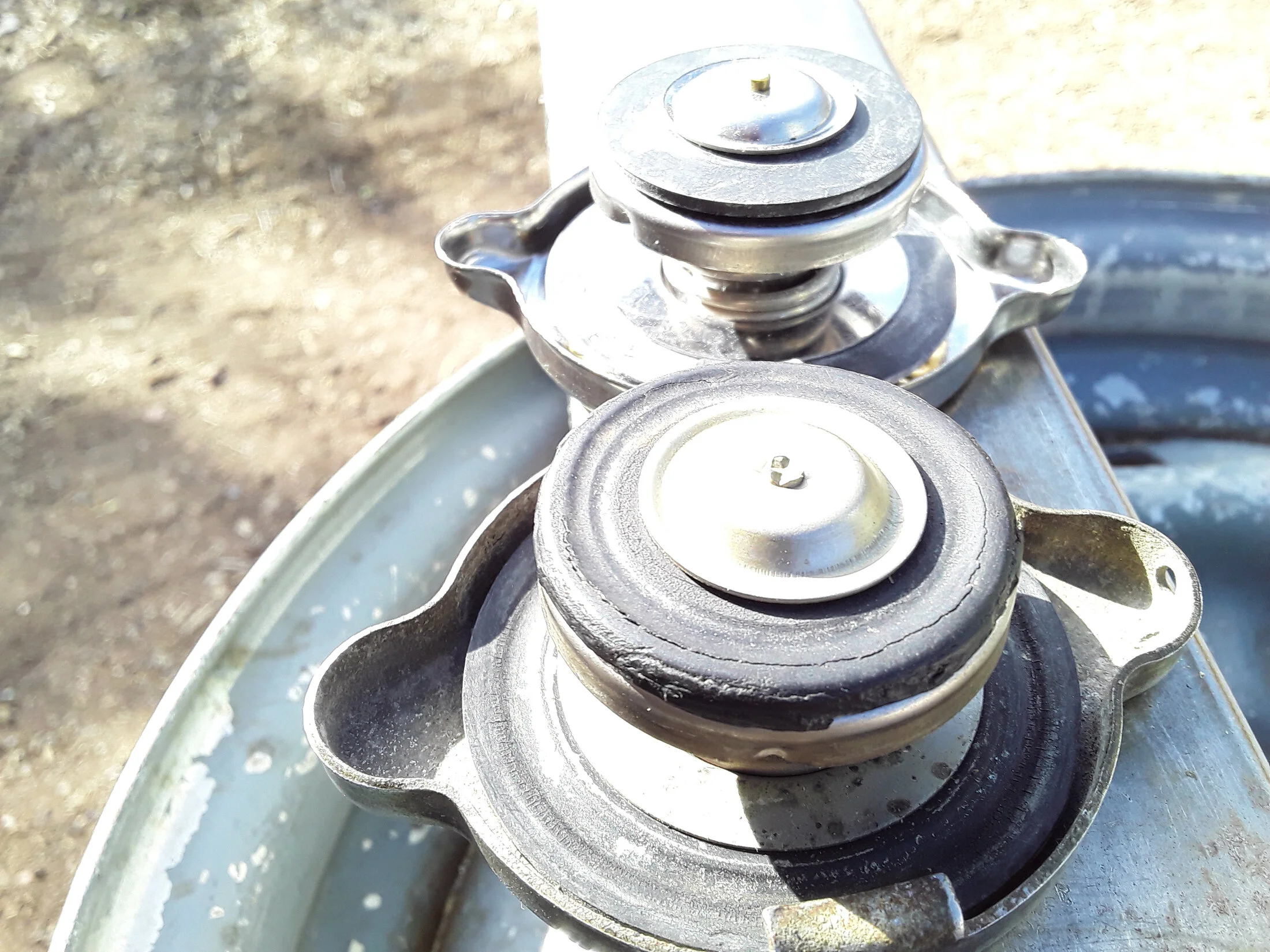

I've never done a coolant flush on my current rigs. I always have just bled the radiator and block, and replaced the coolant. However, the last time that I did a coolant change, I noticed how fast the seals on the radiator cap were stiffening up. They appear to deform and stretch-out, particularly on the inner seal. I've decided that I'll use a new cap for every coolant change.
I bought a cache of aftermarket radiator caps, as the other rig needs them, and they are the same part for both vehicles. So, I'm out a few bucks (RockAuto), to start fresh, without sediment under the vacuum poppet. The flow of anything solid between the radiator and overflow tank can build-up under this critical metal piece, and possibly interfere with the way that the system holds pressure. Plus, I want soft, fresh seals to hold pressure if something solid does get trapped here.

My guess is that Dorman 490215 will fit the aftermarket CSF radiator? (edit) at least for a gasket
I could probably get an M10x1.5 nylon screw from McMaster-Carr, and the gasket from Dorman, for a replacement petcock for the CSF radiator. However, I'm sketched-out by that. I sent an email to CSF, just to see how they respond.
All things considered, pulling the lower radiator hose remains a slightly more attractive option? I'm a fan of the band clamps, the cool-looking wire ones distort the hoses a bit much, and they twist and bend when the threads get kinda rusty.
Even for the rebuilt OEM radiator that came with my truck, it had a frozen drain plug / petcock , and I really made the radiator casing flex when I finally got the petcock removed, uninstalled, out of the truck.
