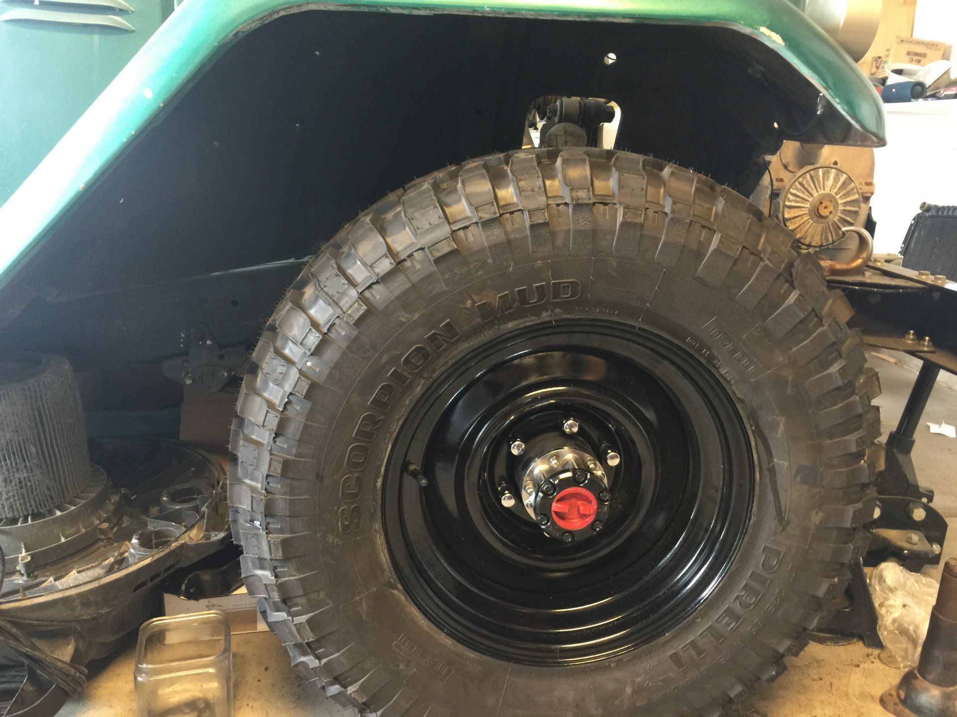

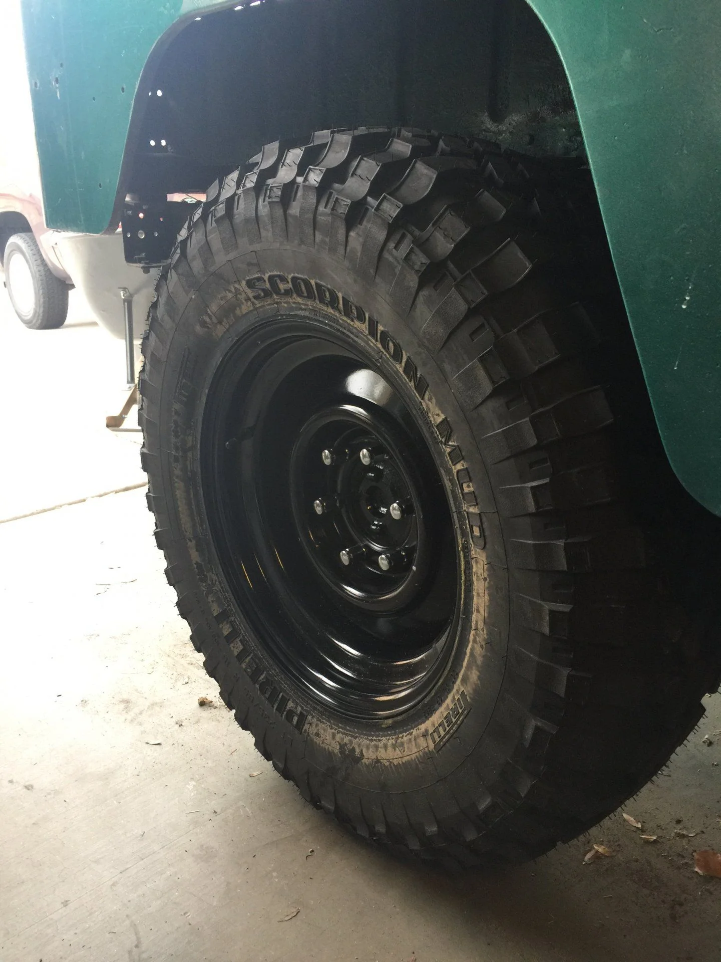

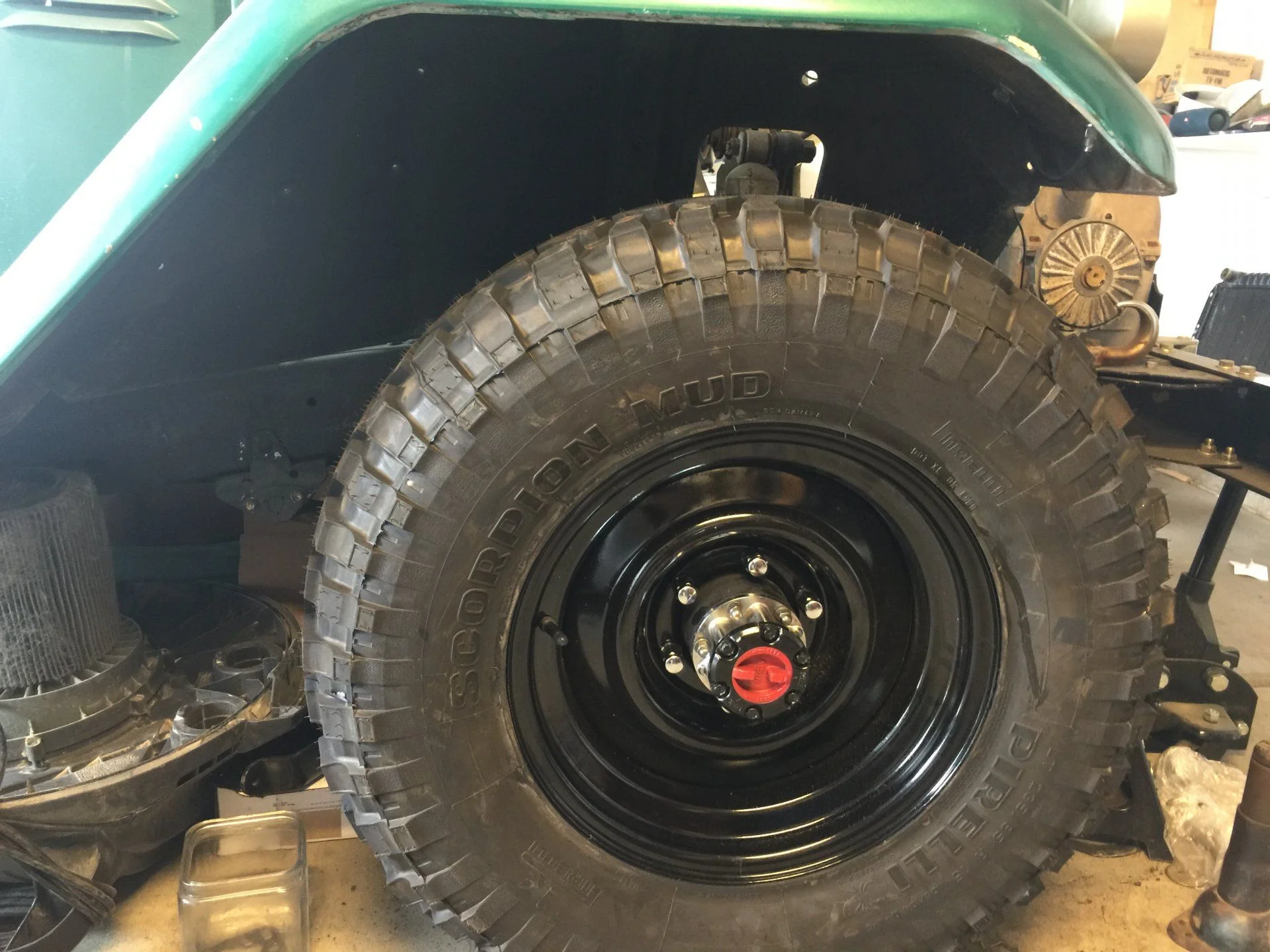

I have 235 85 16, to me the perfect fj40 tire size, but I also like 255 85 16. These are the wheel vintiques, 4”backspace 16x7.

The Pirelli Scorpion Mudders I have are 235/85r16 and are NOT E rated! Look em up!
