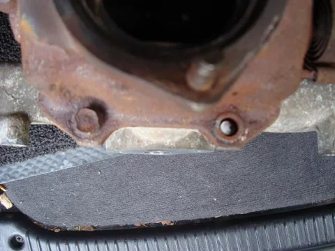

Now I did it! Broke one of the bolts trying to get the two pieces apart. I'm at a loss looking for a machine shop to help me.
It would help to post your location... I'm sure somebody will post a machine shop to help you out...
They can do EDM (electronic discharge machining) or drill/tap. Shouldn't be too much.
I broke one of the EGR J-tube studs on mine, then broke an EZ Out extractor off in it. Had to have it drilled and tapped.
Your exhaust manifold looks really rusty- you might try to find another one, or you could be headed for lots more headaches before it's all said and done.
