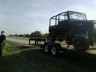

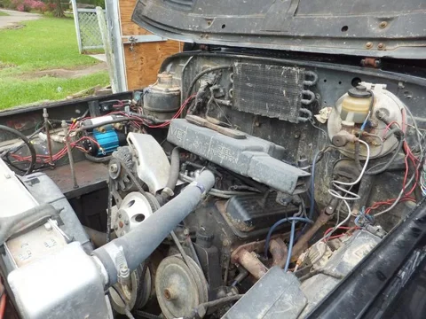

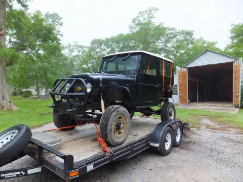

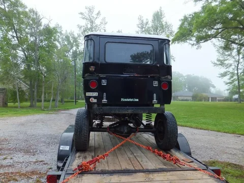

Picked up a new project, the FJ 40 from Hardline Crawlers forum:
FJ40 Land Cruiser (Tons/Linked/v8 etc) PLUS LOTS OF PARTS
Its a 73 frame with a aluminum tub, and cut front fenders. CUCV dana 60 front with 4.56 gears, Detroit locker, rear is a 14 Bolt 4.56 gears, gov't locker. Rear has been four linked with some stock TJ springs, Rusty's offroad joints and have the brackets and joints to link the front. Chevy TBI V-8 engine swap, that is for sale.
This will be a slow build, but the plans are to remove the Chevy motor, install the 2UZ from the wrecked Tundra, Inchworm prerunner adapter for the 2wd trans to mini truck T-case, and some properly sized tires to get it road worthy. Sliders, tube fenders, roll cage, and then four link the front with some ORI struts to get it trail worthy.
