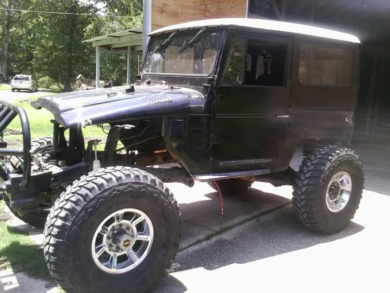

Those rims bring the bling for sure! No mods to the rims make them fit the axles ?
No mods needed they clear everything so far. I think the Hummer H2 has a factory 14 Bolt rear axle. Also the back spacing will keep down the width some, if the tires clear the rest.

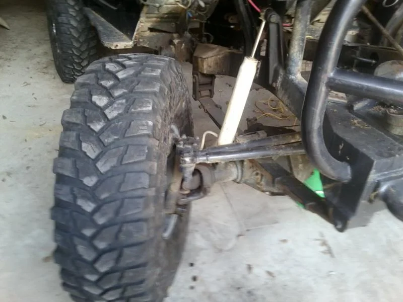

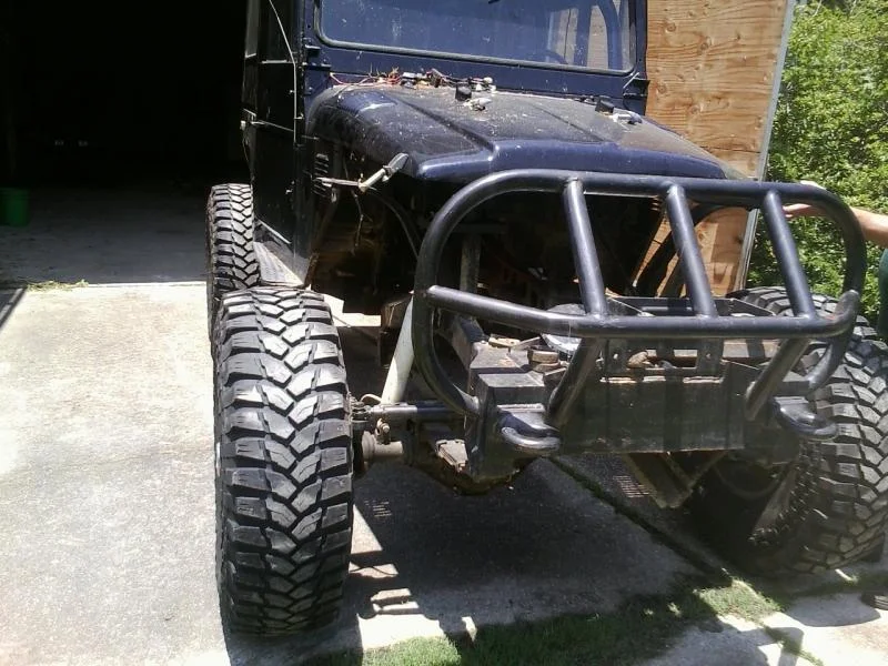

Mounted the 40" Trepadors on the H2 wheels and did some clearance checks, all looks good so far. Unable to flex it to much with just a floor jack, but I know its going to be tall.:frown:
Also took one inch out of the 2 inch body lift, next is finish cleaning up the frame in prep for the engine swap.

Looks good bud and I like that front bumper it looks mean. I don't think even I could bend that one. Do the rear wheels really stick out that far? In the first pic they really look out there. I'd like to come check it out next time your in, I still have Mason's 4-runner :)
They do hang out the back some, but need all the room I can get for the rear driveshaft.
