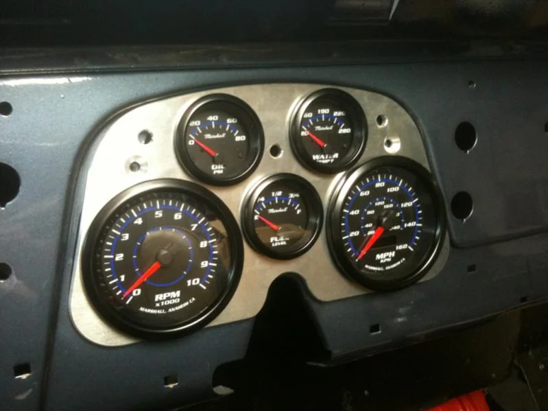

I bought the covers that JT sells to cover the dash. Haven't installed them yet. They look good and pretty much cover everything.
Also bought the metal tech gauge panel and Marshall gauges.
