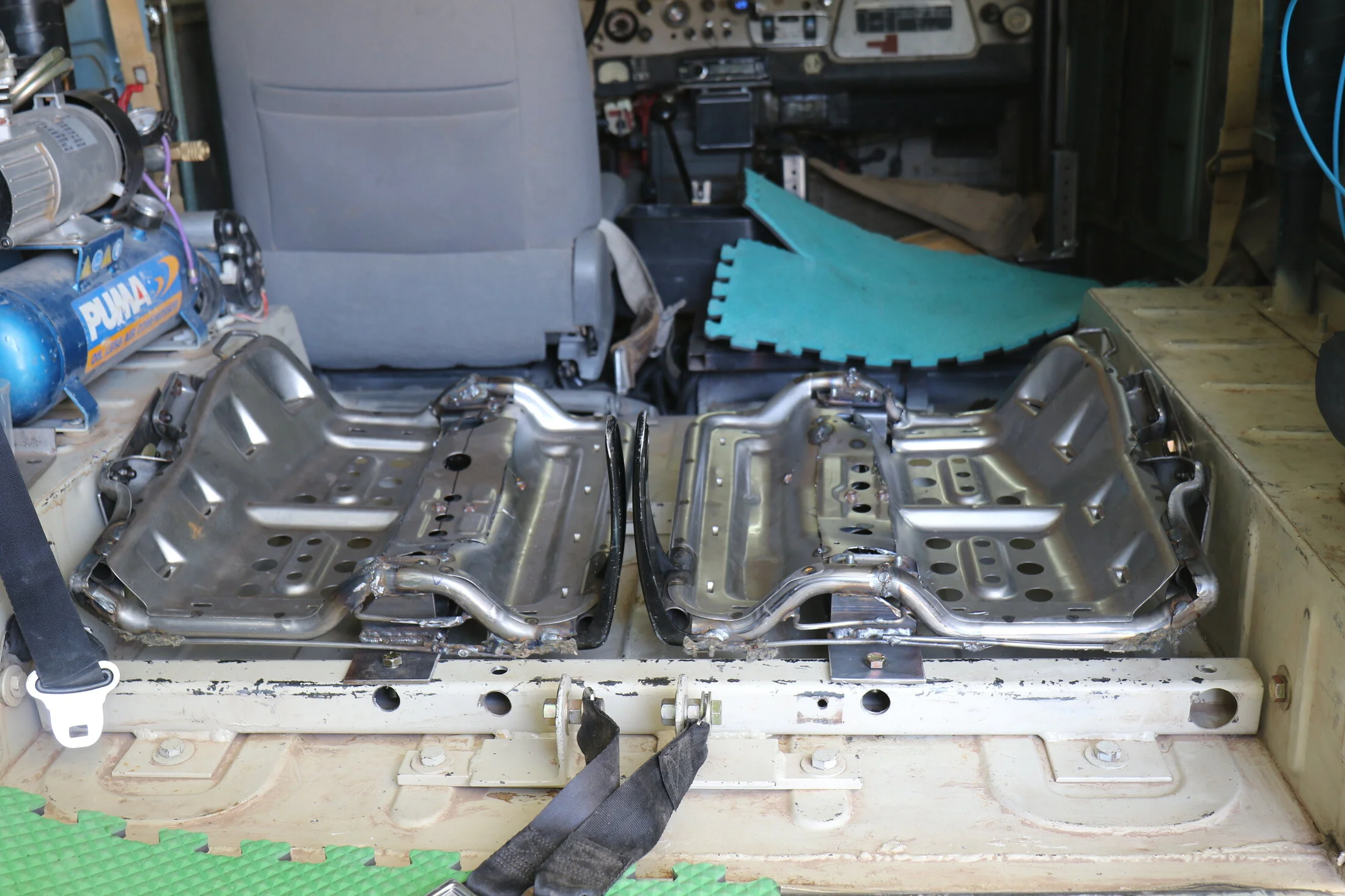

Last year I needed a fourth seat in the FJ40 for Cruise Moab so I welded up a quick mount for the second FJ80 seat. Since there is no room for two FJ80 seats side-by-side between the wheel wells, the second seat had to sit on top of the wheel well and only a short person could sit in it without smashing their head on the roll bar.
I need two rear seats in the FJ40 for Cruise Moab again this year, so I modified the FJ80 seats so they can fit between the wheel well in my FJ40.
I cut out 3.5 inches out of the center of each seat frame and foam padding and squished the remaining between the wheel wells. I was going to modify the pleather to fit the smaller frames, but now see that although the excess material looks amateurish, it doesn't affect the operation of the seats - they fold down as designed, and have the same two original FJ80 upright settings available. I may be able to stuff the excess material into the seats, but I don't really think it is necessary.
Welding was a disaster because of the enormous amount of rust on the seat frames. Welds are not pretty, but these seats will never break apart due to the cr@ppy welds.

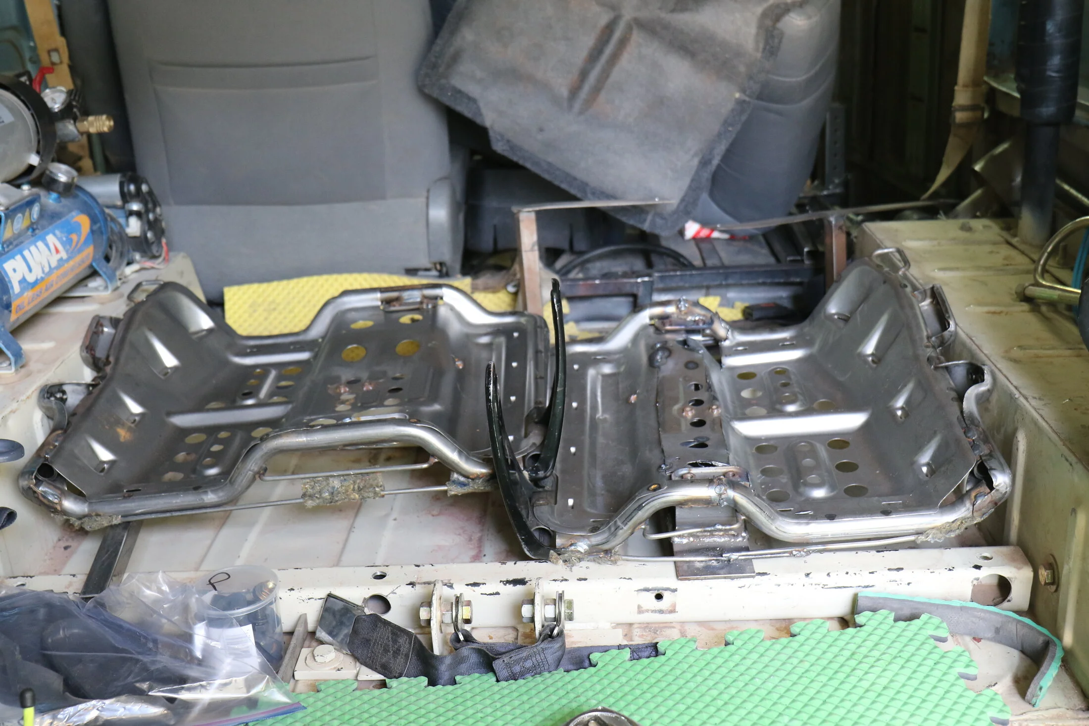

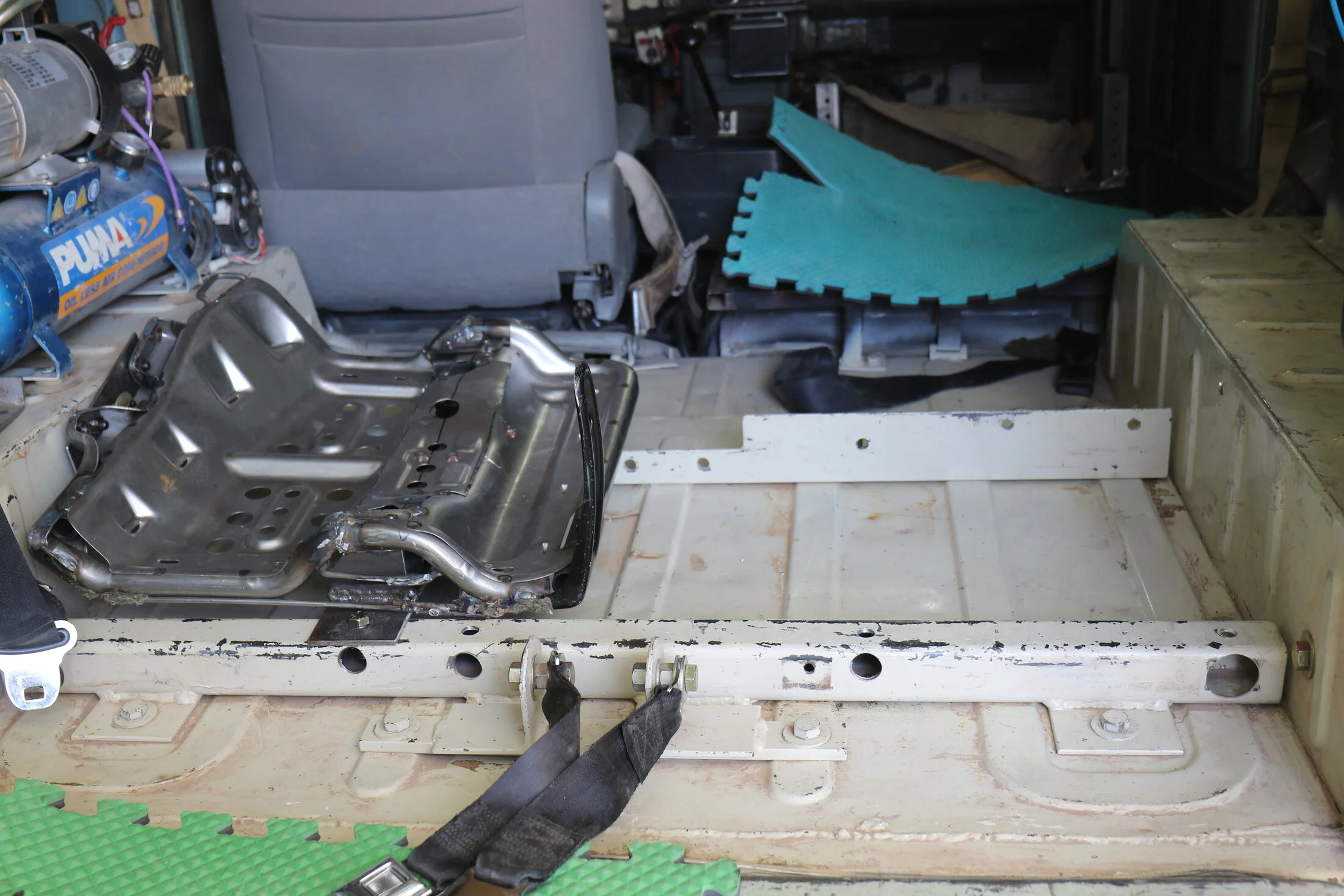

Test fitting the seat frames - unmodified on the left, cut up frame on the right
Original frame
Welded up frame on the right
Original on left, welded up narrowed frame on the right

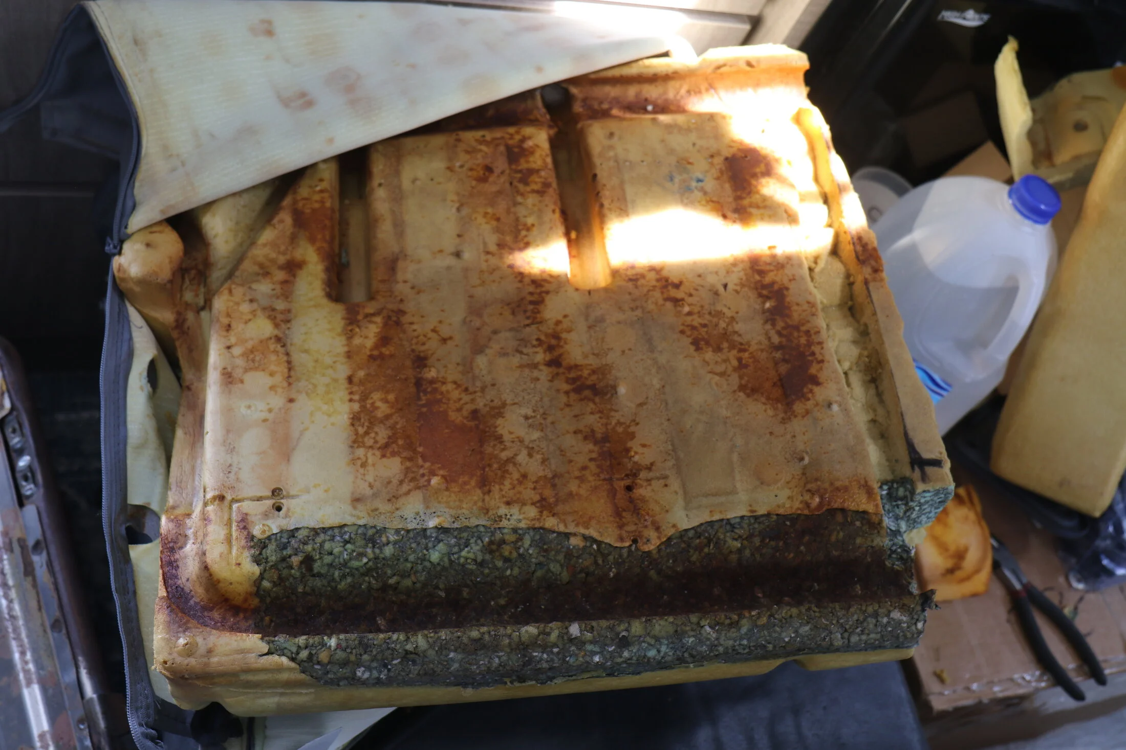

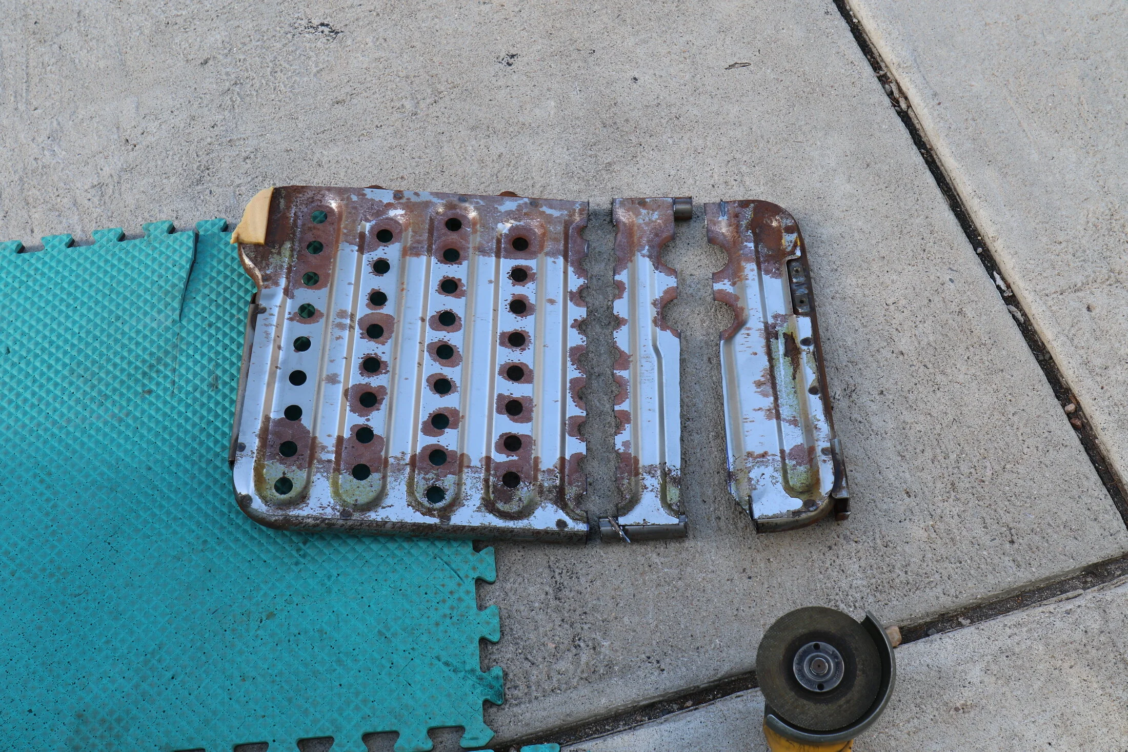

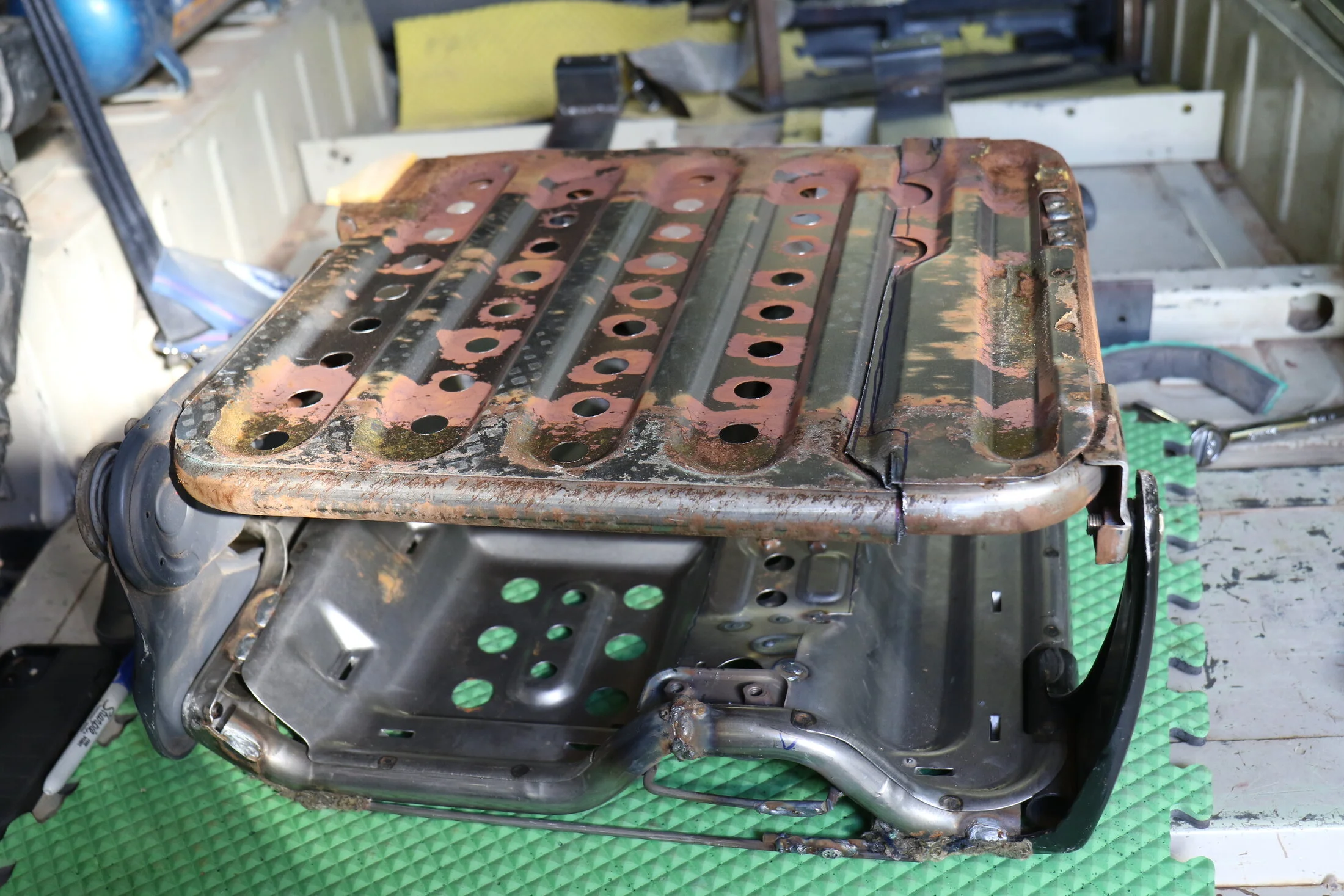

Cutting up the seat back - extremely rusty

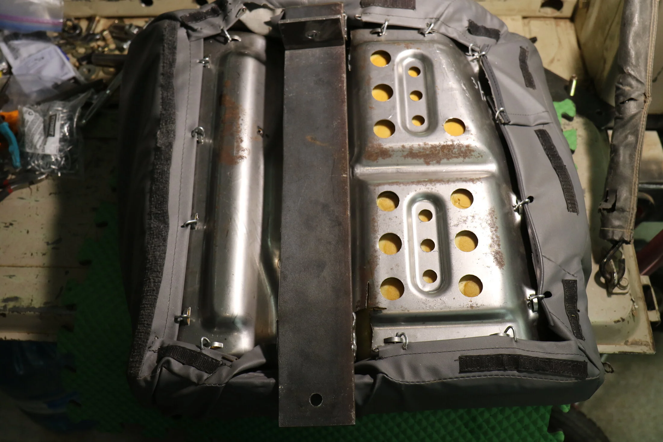

Test fitting the seat back frame to the seat frame
Modified seat back foam

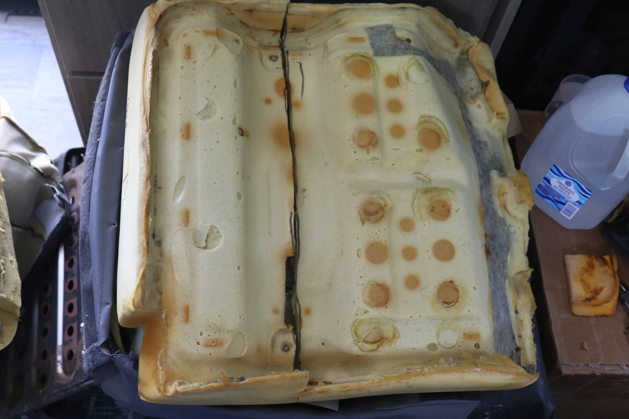

3.5 inches cut out of seat foam
Remaining seat foam

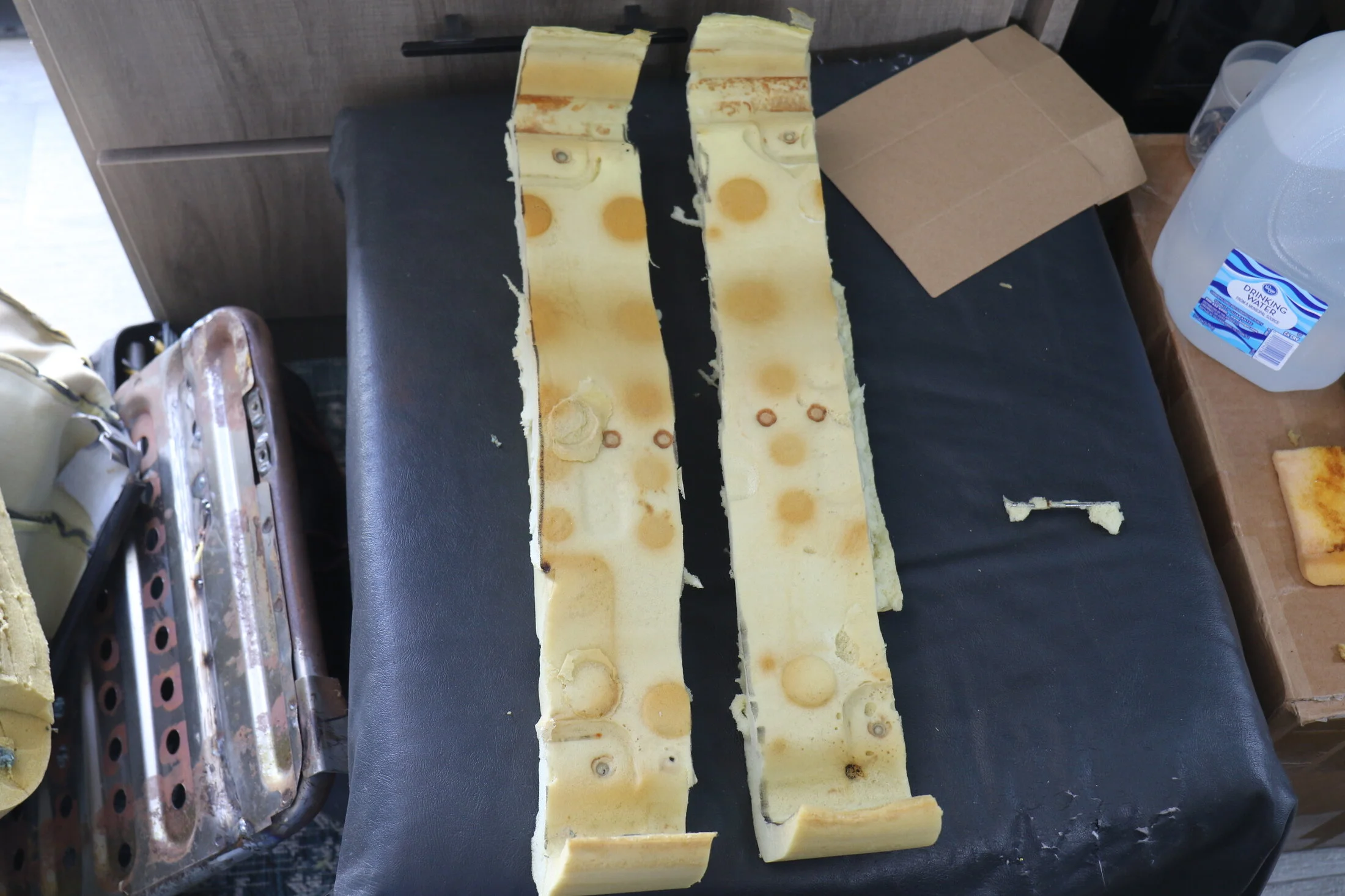

The two 3.5 inch strips I cut out of the seat foam/

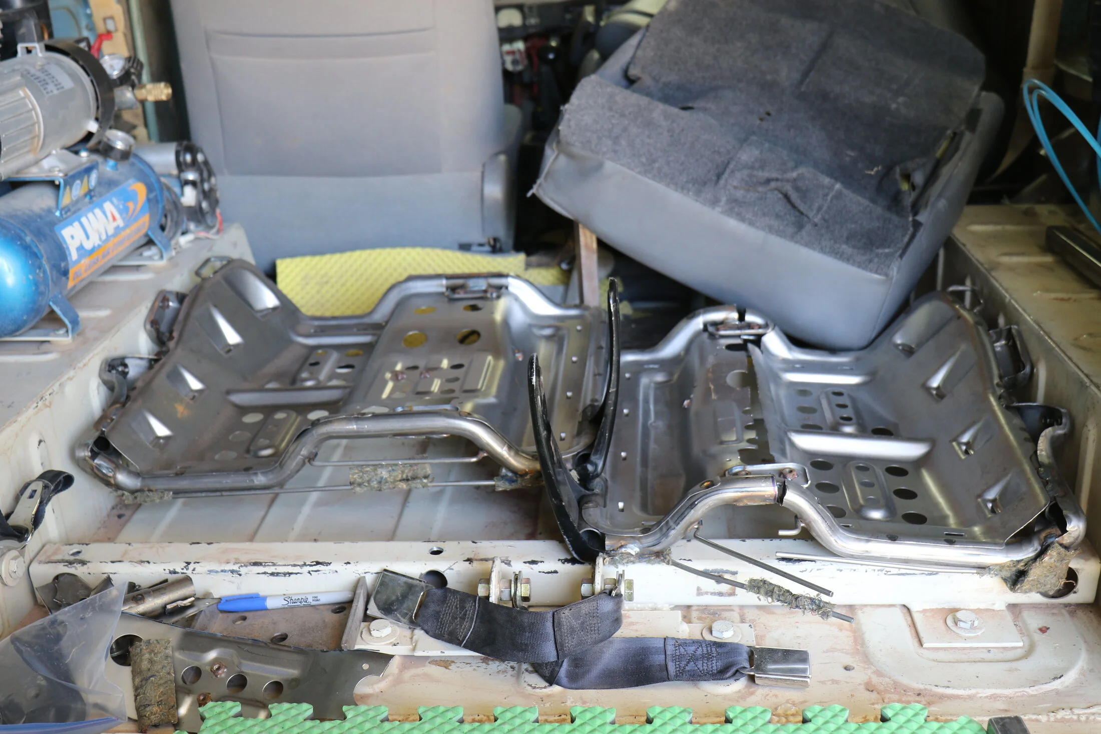

Test fitting the completed narrowed seat frames

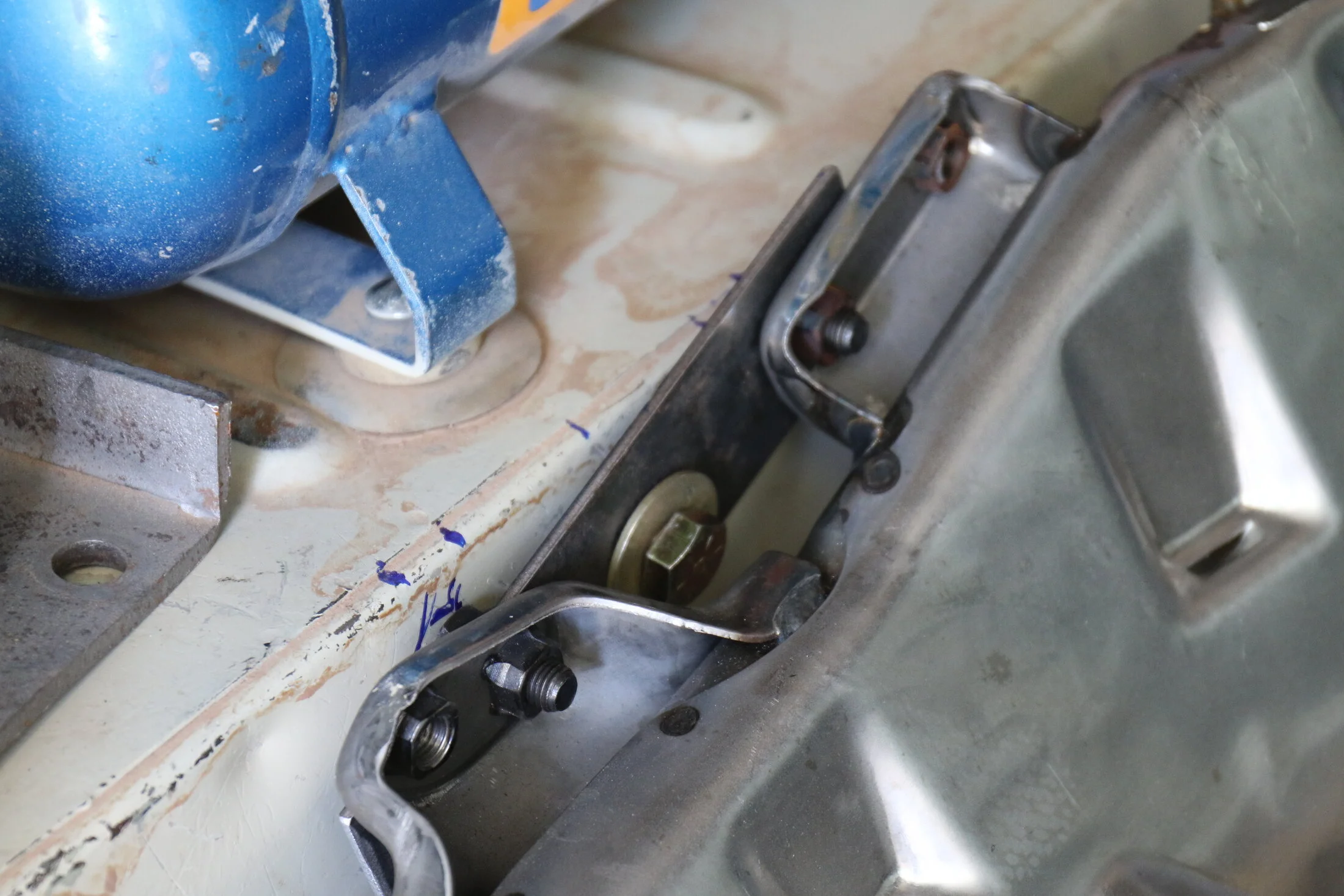

Detail of side mount through wheel well
Upholstery back on seat frame and bottom mount attached to seat.

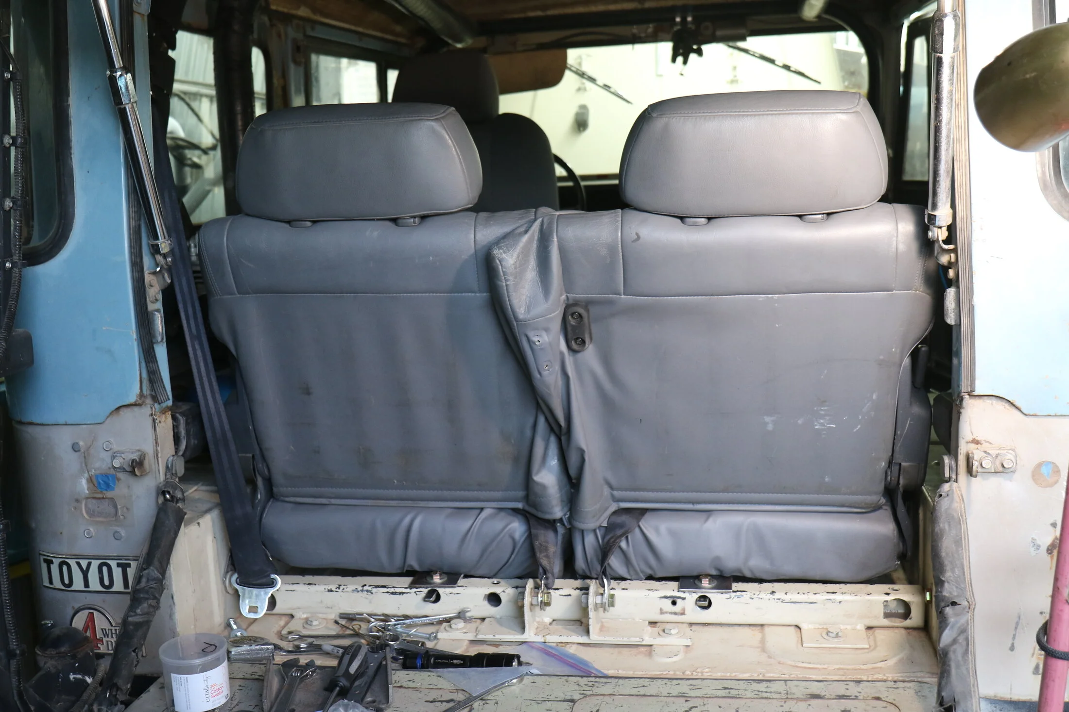

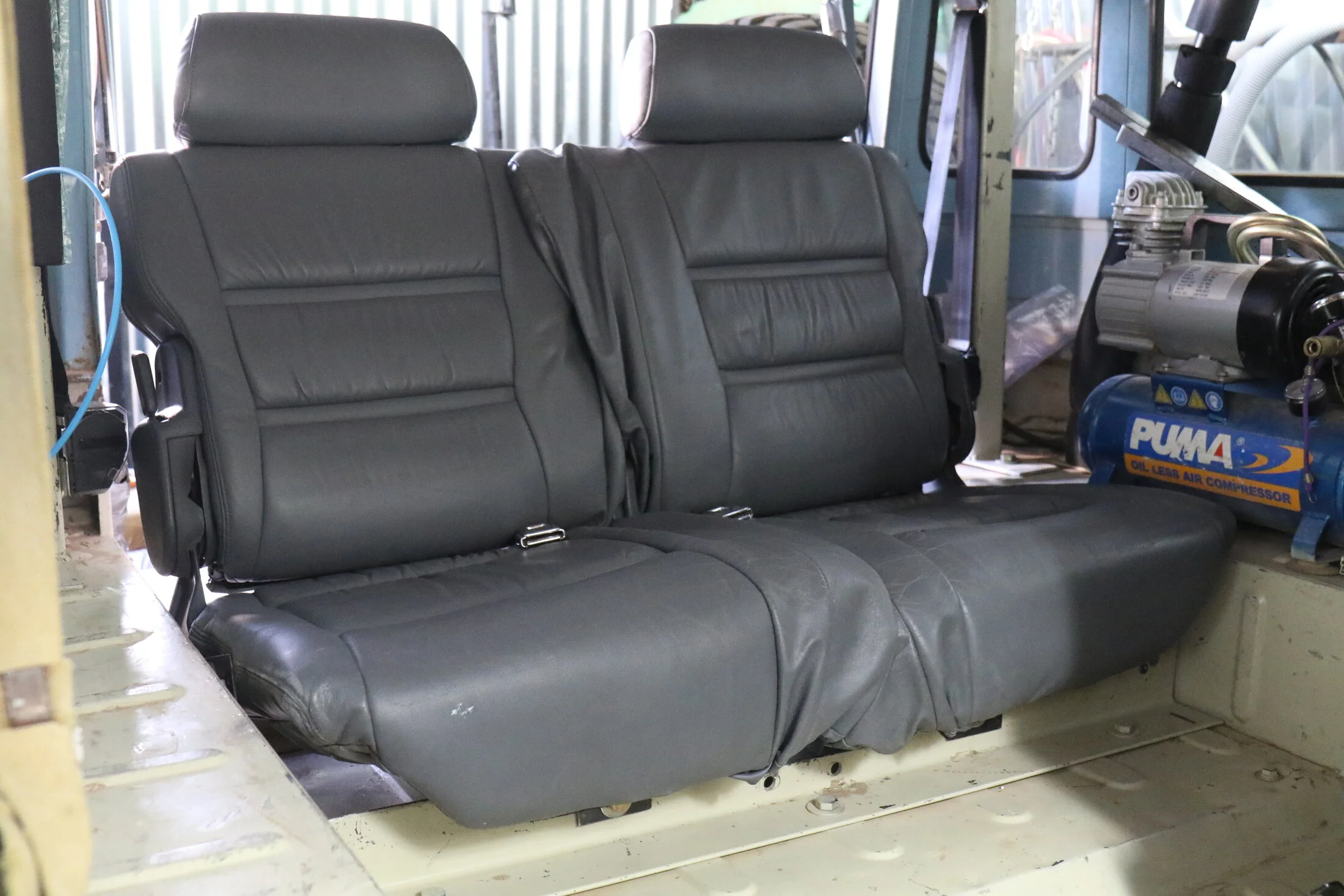

Seats mounted in FJ40
