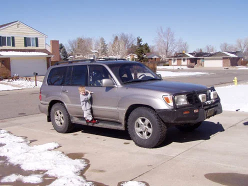

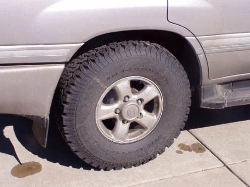

    Photos of the 2002 with 295 BFGs
    OK, thanks for the tips and suggestions. here we go... first time photo postings.

    Photo attempt #2
    Here they are I think... tight fit but no rub at all on the road, and I haven't had any up and down curbs yet. Taking it to Moab this summer and looking forward to that. I'll get some dirt time this month and let y'all know if I see any rub.

    Looks great! Now it's time for an OME and t-bars!

    I love the way it looks, you opted to go the route of bigger tires before the lift,suspension upgrades from what I gather???, and have found there is no real rubbing so far with 295/75'?
    I think most here run the 285's and a few like Macneill run 305's.
    I will be very interested in hearing how they go after a while. If you like it I will use 295's, I would like to go with 305's but not sure if i can do it.

    dont forget shotts with his 315s!!!!!
    Shearne, truck looks good! Did you notice any difference between 295 and 285?
