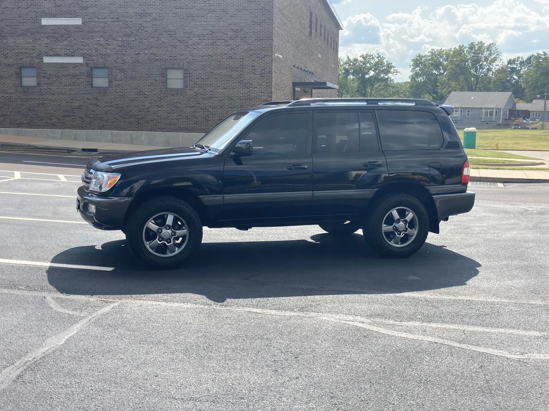

I currently have newer stock shocks and OME 865 coils. 1 inch wheel spacers. I will need new tires soon, and I would really like to use 295/70/18s if they will fit and actually be functional off road.
I know I will need to smash the pinch weld and modify the fender liner, as well as possibly the washer reservoir. Yes, I know I should probably be looking at 275/70/18, but love the look of 295s if they can be functional with my setup. I am not going to utilize the stock spare location.

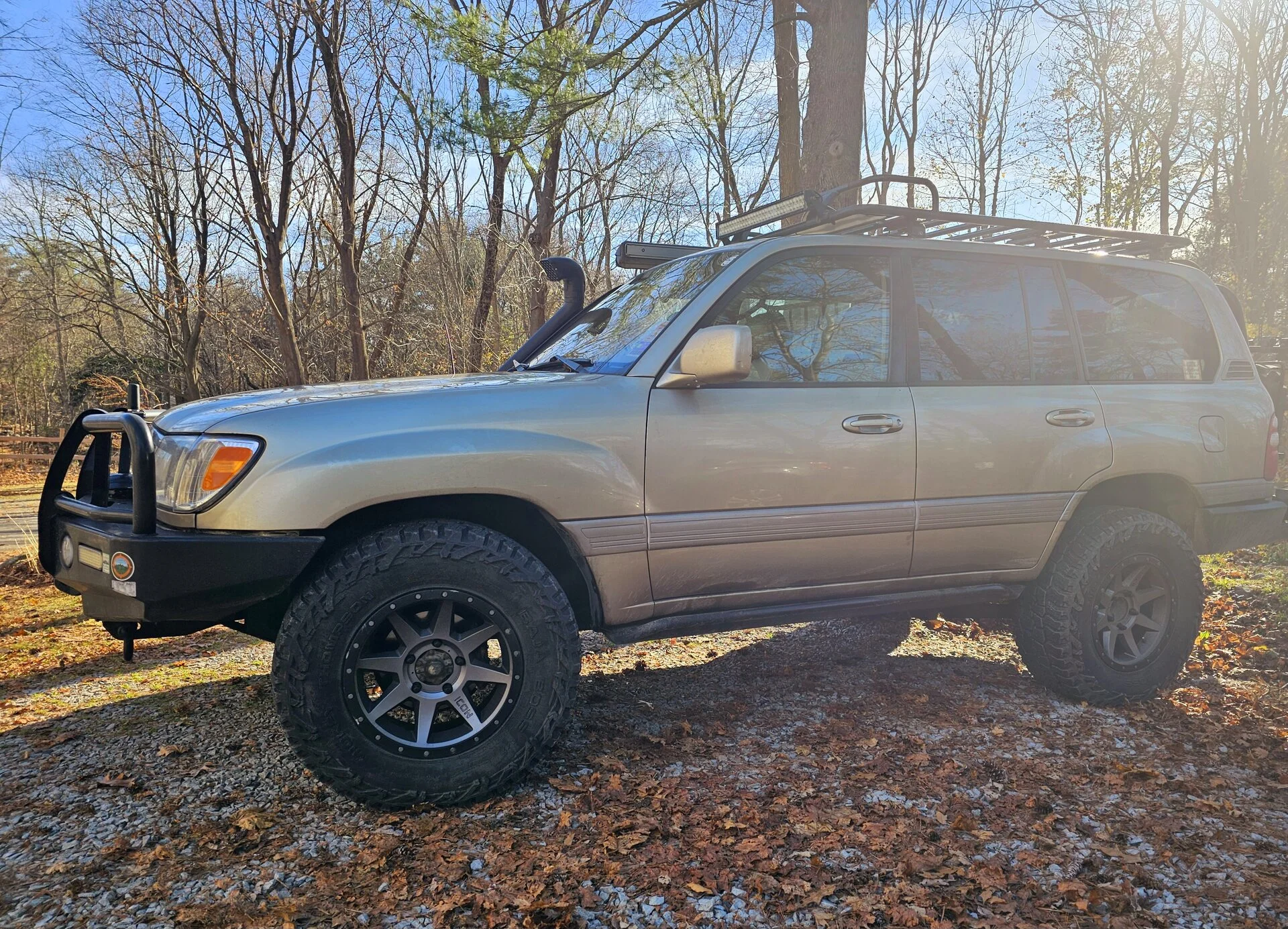

I have that size tire with +25 wheels and 555 UCAs, and just did the pinch weld etc.
Thanks very much for your reply. What suspension setup are you running? Do you have any rubbing on or off road? Thanks again
It's OME torsion bars and extra heavy OME rear springs (864). It doesn't rub the fender frame or suspension when flexed, but it took several times
with the heat gun to get the fender liner over the pinch weld area flat enough.
