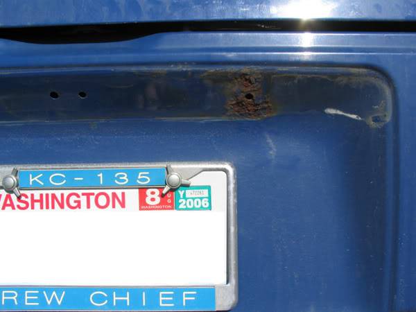

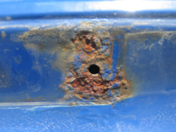

While pulling all my trim off today to repaint it (paint was chipping off and showing chrome) I decided to de-bling the TOYOTA chrome strip on the tailgate as well. While unbolting it, I noticed that the threads on one of the bolts holding it on were all FUBAR (repairable with a thread chaser, so I'm not worried about that) because for some reason the first owner put the wrong damn thread nut in place of the factory nut with the "built in" star washer. Not only that, but the stupid jackass (I hope he's reading this) used an aluminum lock washer! So of course the steel on the tailgate started to exfoliate and formed a decent sized chunk that rusted completely through.
So what do you guys think I should do? I'm thinking I might be able to have a sheet metal or body shop cut out the rusted area and weld a patch in its place, then redrill the hole and prime/paint the area to seal it up and cover the work. With that much work though, I'm wondering if it's going to come close to the cost of just replacing the tailgate. A replacement is $300 from Cruiserparts.net though :frown:
Couple pics:
So you can see where exactly the rust is
Closeup of the damage
And yes it's rusted all the way through. If I tried, I could easily punch my finger through what's left there.
I'm not a body man, so my approach might not be the most appropriate...but what I'd do is fix it myself. Sand all around until I got clean/unrusted metal. POR15 the area, body filler as needed, primer, then paint. It's not a structural area, so no worries about strength. A little dirt, and the paint will match fine...

If it was just surface rust, that's what I'd do, but it's gone clear through the steel, so if I were to remove the rust, the result would be a 1.5" diameter hole :frown:

For the price of any body shop repair you could buy a decent little welder. I can't tell you how handy a welder is, particularly for Cruiser body shop repair and accessory builds (roof racks, tire carriers). Welding is much easier than you might think if you haven't tried it, and fun, and suddenly the whole world of metal fabrication opens up to you. That would be a twenty minute repair with a welder, grinder, a little bit of putty and some sanding.
