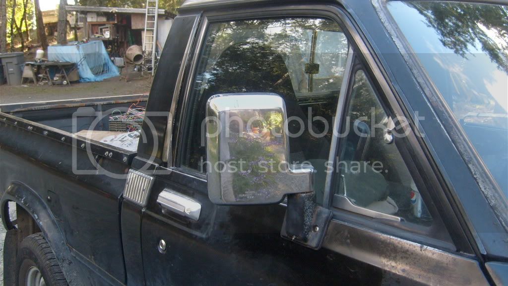

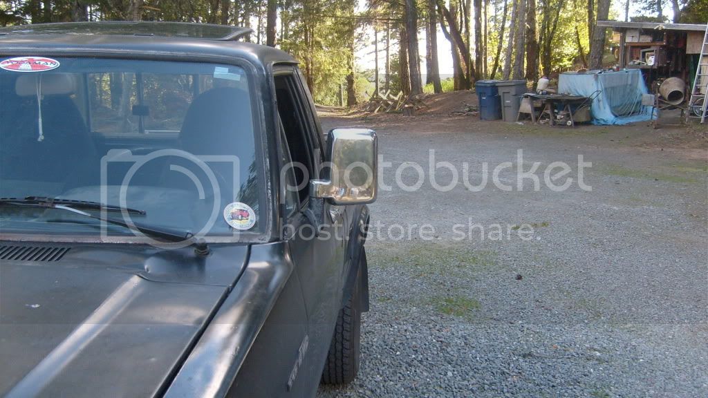

I've never much cared for my factory mirrors on The Mule, they're just too small and too low.
While browsing Pick-n-Pull today, I stumbled across an FJ62, and got to admiring its (surprisingly) intact side-view mirrors.
Pulled 'em off, took 'em across the way to a wrecked first-gen, did a quick comparison, and the bolt holes lined up.
Bought 'em, and swapped 'em on right then and there.
Here are the results:

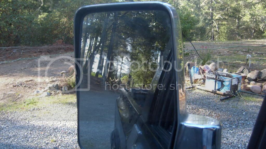

Visibility's nice, it's pretty well eliminated any blind spots, I don't have to hunker down to see 'em, and the passenger one doesn't rearrange itself anymore (the stock one had a tired spring).
So, for an inexpensive no-hole-drilling needed mod, FJ62 mirrors fit a first-gen.

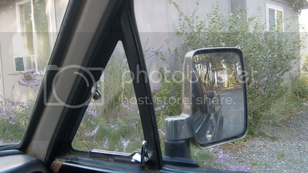

One question though, does it interfere with the wing window?
You know, I hadn't thought about that.
I wasn't sure, so I went out and checked, and there's no interference.
We're in the clear!
