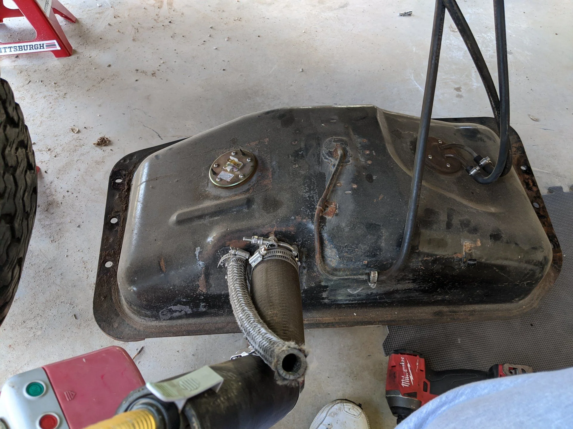

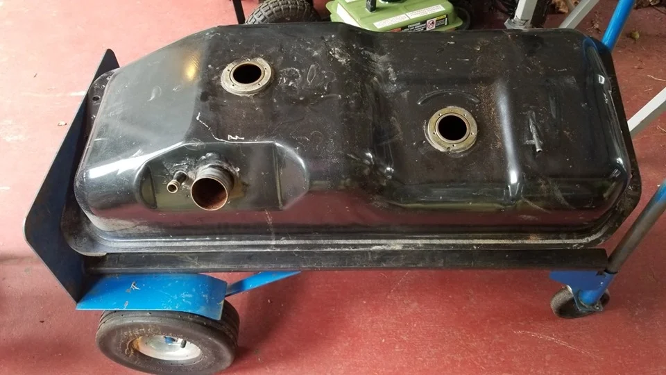

A 1st gen carb 4wd pickup(79-83) has the exact same fuel tank as a 2nd gen 2wd(84-89) of the same bed length, which is waaaay more available
a 1st gen 4wd short bed, fuel tank, is identical to a 2nd gen 2wd short bed pickup
Spectra tank on amazon
or
Dorman tank i actually bought
I put this in and it fit perfectly, I have photos somewhere of them side by side, but i can't find them, when I do I'll add them to this post.
Another guy did the same thing with a 1st gen 4wd longbed, and a 2nd gen 2dw longbed, and it too was identical, bolted right in..
I suspect that these tanks will also fit 2wd, but be a small upgrade in capacity, but i have not tested it.(I don''t own a 2wd 1st gen)
