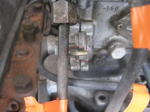

This image, hopefully, is highlighting the only remaining connection I need to make on the carburetor. However...I don't have a clue what plugs into this. Is it the vacuum hose from the carburetor? If not...where does that vacuum hose go? :) Having a tough time finding detailed images on what and where things are supposed to do and go.
As usual, all help is MOST appreciated:)

That is the AAP and according to Jim C. unless you have a healthy 2F with headers it is probably not needed. It gives an extra shot of fuel. You can hook it to manifold vacuum and see if it makes a positive difference in performance or just leave it unhooked. Make sure the diaphragm under the cover is not torn.

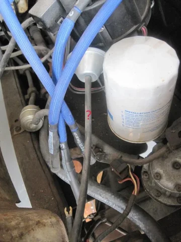

Ahh haaa...Thanks! So then where does the line from the distributor go? That is still unhooked and I can't seem to find images on that showing where that hooks into (if anywhere).

The distributor connects to the fitting on the valve cover side at the carb base. It would appear you currently have a vacuum hose connected to it disappearing somewhere away from the distributor.

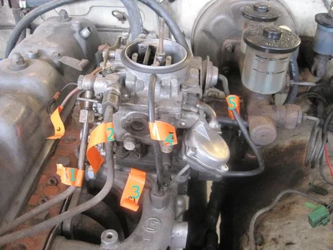

So in this picture you can see the hoses I have, and the corresponding numbers on them. I cannot, for the life of me, determine absolutely which hoses go where, and what hoses may or may not be in the correct place.
And this is the hose from the distributor goes where?
I swear I'm not a complete moron with cars, I just have ZERO experience with something this old:/ I feel like a total dolt.
Thank you guys!
You have a bunch of issues. Take the hose from the advance on the dizzy and hook it to the carb base where hose 3 is now. Cap the nipple where hose 3 currently hooks to the intake and the cap the nipple next to it currently causing a huge vacuum leak. 1 & 2 are your fuel supply and return lines. It would also appear your header flange where it meets the head is warped. Do you have a exhaust leak there?

Yep, dizzy and dissy are short for distributor. Since the carb is already on there I would try to use it. You will need to totally change the throttle linkage system to use the Weber. The red arrow points to what appears to be a massive exhaust leak except there is no carbon which I find strange unless the motor had not been run since that intake/exhaust gasket was installed. I had a warped header flange like that due to the header impacting a rock. Had to pitch the header as I could not get it bent back. If you can't get the stock carb to behave after a rebuild then slap on the Weber, or even better, sell it and buy one of Trollhole's brand new OEM knockoffs.
