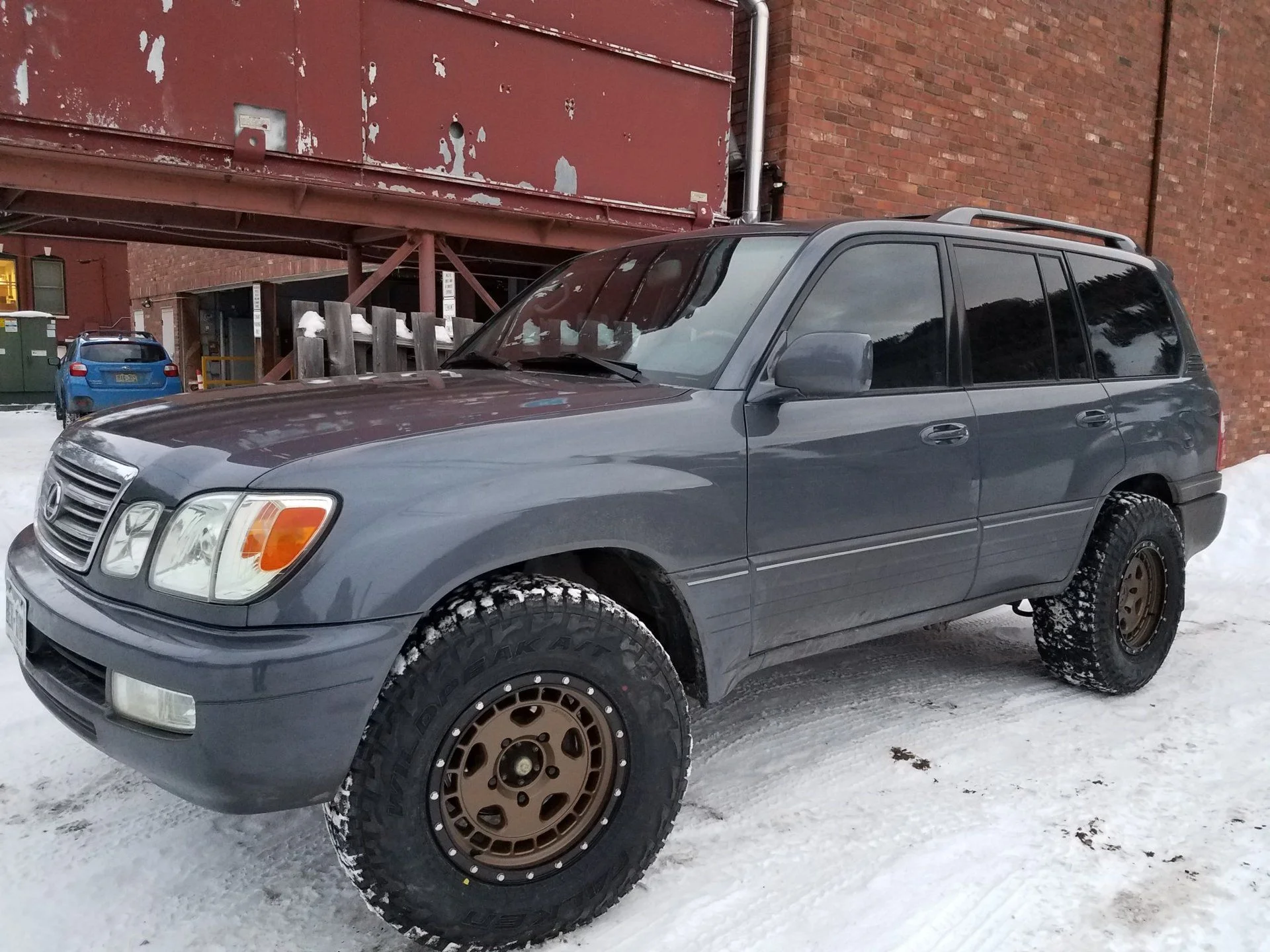

Finally got them installed yesterday. Unfortunately I got sick as hell today and can't go play around in the snow with them.
285/70/17 Falken Wildpeak AT.
Do you rub when the suspension is compressed? I’d love to pick up a set but their offset is not 100-series friendly at all.
I didn't have any issues other than the pinch welds. I haven't had alot of time driving around with them but some of the streets around town are steep and require some articulation and I didnt notice any rubbing.
Well just a little update, after driving more on these wheels, they do not fit. Too much rubbing even with the pinch weld mod and they do hit the fenders under full compression. They do actually tuck up under the fenders on the rear. I guess I didn't do enough research or misread the spec on these wheels. Kinda a bummer cuz I really liked the wheels but hopefully this post helps someone who might be thinking of these wheels. Unrelated side note, I have a set of Fifteen52 Turbomac HD wheels for sale that fit 5 lug Tundras if anyone is interested....:bang:
