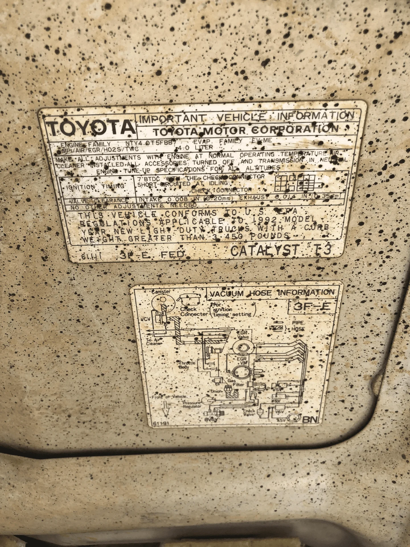

Hi All,
I'm still doing some research into whether I can register this 1992 FJ80 in California.
It looks like the emissions label doesn't specifically state that this car meets California Emissions requirement, however I do plan to bring it into meeting the CA standards. See below for the sticker on the vehicle:

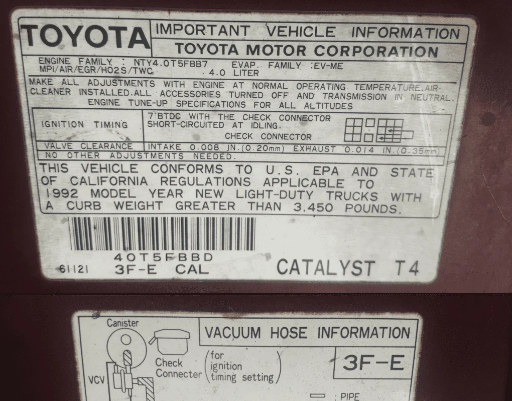

I've seen other images on the web that specifically state that this model year also has something that conforms to 1992 standards. See below:
Anyone have any experience with registering vehicles like this in CA? My other alternative is to head down to the local AAA to ask as well.
My other option is just finding another hood with the stickers already on there that say CA compliant and calling it a day, but wonder if that's worth that hassle if the VIN states that it's not CA compliant.

You look at the CARB website?
I have looked at the CARB website. It's inconclusive what I can or cannot do for used vehicles and only specifies new vehicles
A California resident or business cannot operate a new out-of-state vehicle in California that is not "California certified." The Department of Motor Vehicles will not register it. It cannot be driven or sold here. If the vehicle is to be operated or resold, it must be removed from California. Converting a "federally certified" vehicle to be "California certified" is not allowed.
Well considering it’s a 1992 it might have a exemption. Like out of country importation of vehicles 25 years and older.
The operative word in that quote you had above is "NEW out-of-state vehicle." The vehicle is not new. You're transferring registration without transferring ownership, therefore the vehicle is not being sold into the state. As long as the emissions equipment on the truck is intact and operating as intended, as will be determined at the SMOG station, you should be fine.
I can't find a well written article on the new CA DMV site, but basically, if the vehicle has over 7,500 miles on it, it's considered used and as midfat says, it should be fine (assuming smog equipment works as manufactured).

All good points and good to know. There is a CEL and o2 sensors are non existent due to cats not working properly. I plan to do a whole emissions system swap prior to bringing it to the DMV so I'm assuming if I can get rid of the CEL and get it smogged, I should be good to go? Also what's the late fee? I don't know how long it will take me to get the truck up to smog readiness but hopefully it should be quick....
@alphaeighteen,
As long as you pass smog, you should be able to transfer the title to your name in California. So that means you have to deal with the CEL because that will show up when you get it smogged. Toyota Land Cruisers are 50 state legal - some manufacturers had cars that was not legal in California, I am not sure if they still do that now but you should be good with your Cruiser. Good luck and have fun with it.
