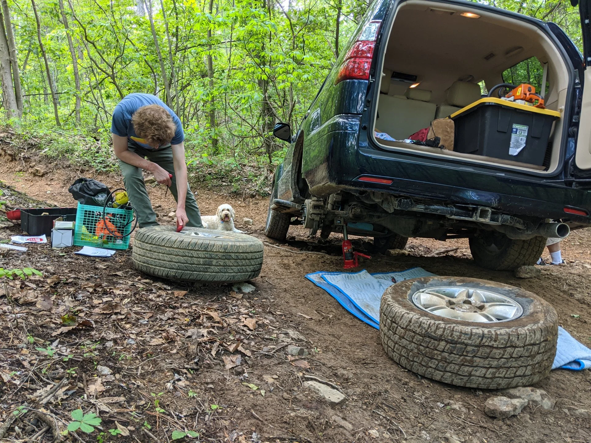

I got a taller bottle jack and it worked fine when I got a flat at the cove. I will be getting some kind of axle cradle in the future though because it was sketchy lifting without one with the jack just on the axle. I don't think a high lift would have helped me in my situation.
If you have nothing else at all take your spare and put it under the axle as soon as you get it up enough. It at least gets you about 10" of clearance. As soon as you get the flat off swap it for the good tire and keep on going.
