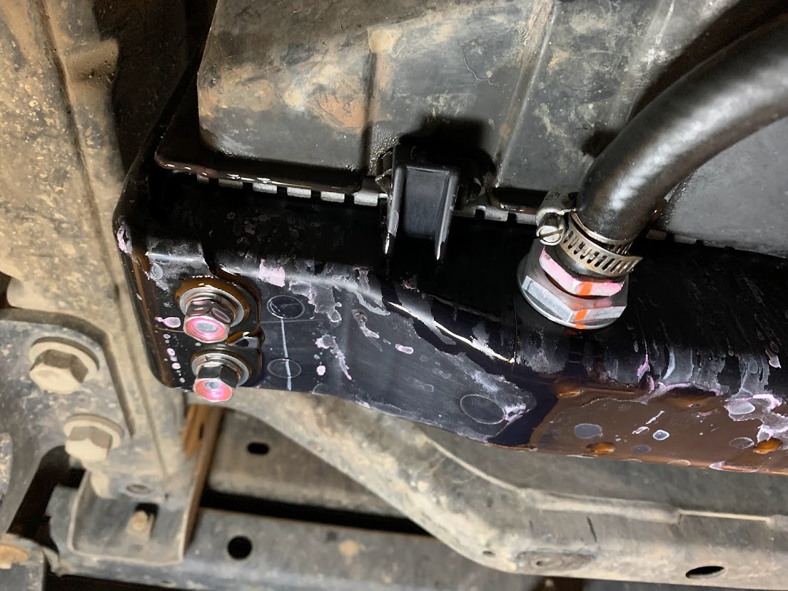

98 LC with 210K mi. Have installed four radiators in 2021. All have failed. Last radiator install included head rebuild, new gaskets and head bolts; new thermostat, new radiator cap. This LC runs very well, does not leak oil or use oil, and does not overheat, but I can't seem fix repeated blown radiator issue. Thoughts or suggestions please.

So the radiator is blowing apart at the seams, do you have any pictures to share? You mentioned the upper hose is very firm, isn't that normal when the vehicle is hot? I don't see what else could cause all that pressure in there other than something head gasket related but I haven't experienced this before so I'll bow out of this one.

Does not overheat. T-stat is new and new one was installed with each radiator. Here are some pictures. Let me know if other shots are needed. Thanks everyone for your help.
How do you know it doesn't overheat? Are you using the instrument cluster gauge as a measurement tool or something else?
Looks like the top seam is leaking, not the bottom. Has the radiator cap been replaced or you’ve just kept using the same one on each radiator? A failed cap will cause pressure to build excessively, and if the hoses from radiator to overflow tank are clogged, pressure very well could build to the point of busting the seams.

There is evidence of leakage at the top seam of the radiator as well.

is it possible, the radiator support brackets, or support are bent causing stress on the radiator or are the support bracket bolts to long and cracking the tanks????

Are you sure they mounted the radiator correctly? I installed my new Denso radiator 4 days ago and you must slide the radiator on to two bottom cushions properly to get the radiator to be mounted without a strain. I had to use WD40 to push the radiator onto the rubber mount. Without WD40, it was not going completely onto the bushing. Are all 4 rubber mounts installed?
One more, those constant hose clamps might be too right leading to a crak.
Locate where exactly it is leaking. MAy be due to a twist, the aluminum tabs have come loose? So ensure the radiator is properly mounted to two bottom cushions (cushiosn are near the fram rails) 12 mm bolts.
Check the reservior tank tube. It cannot be clogged to release pressure.
