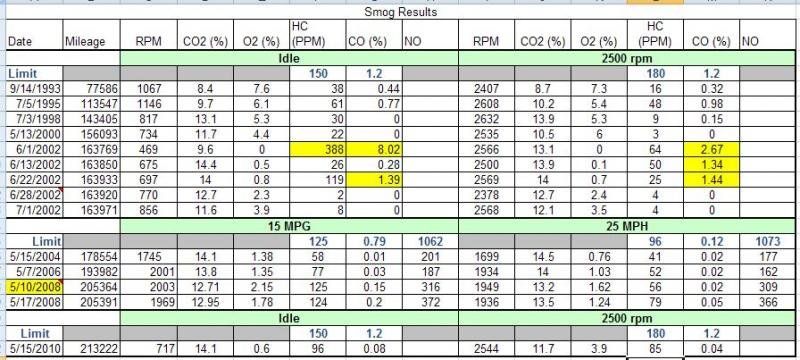

Here are my previous results over the years, both the idle test and the dyno test. I have had passing smog tests with oxygen as high as yours so it's not abnormal. In 2002 I failed smog. I did a lot of stuff, the last thing I did before finally passing was change both the smog pump and the cat.
That's a hell of a spreadsheet you've got there - nice work on keeping track of that stuff! I really hope I don't need a new cat ($$$), but it sounds like I'll have a new smog pump soon enough... I'm sure I'll be able to track the problem down soon.
