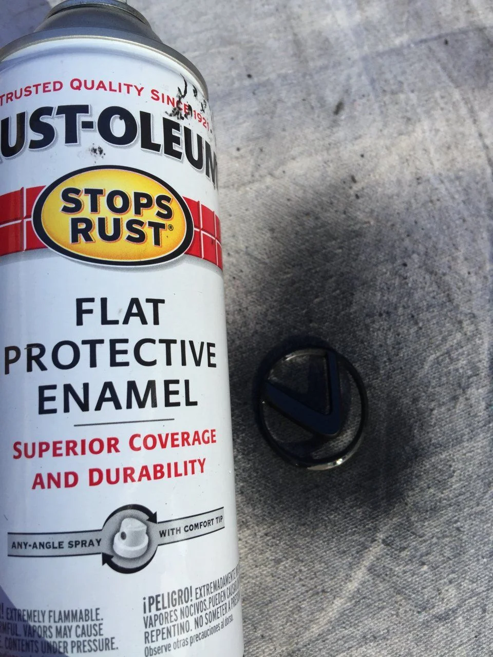

Perhaps consider prepping the wheels really well and then trying a Rust-o-leum wheel paint. You can always chemically remove it without damaging chrome plating.

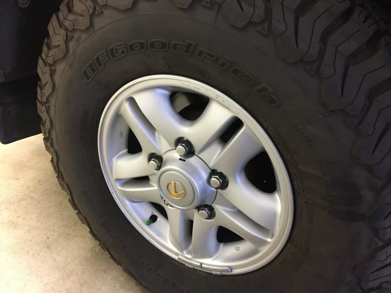

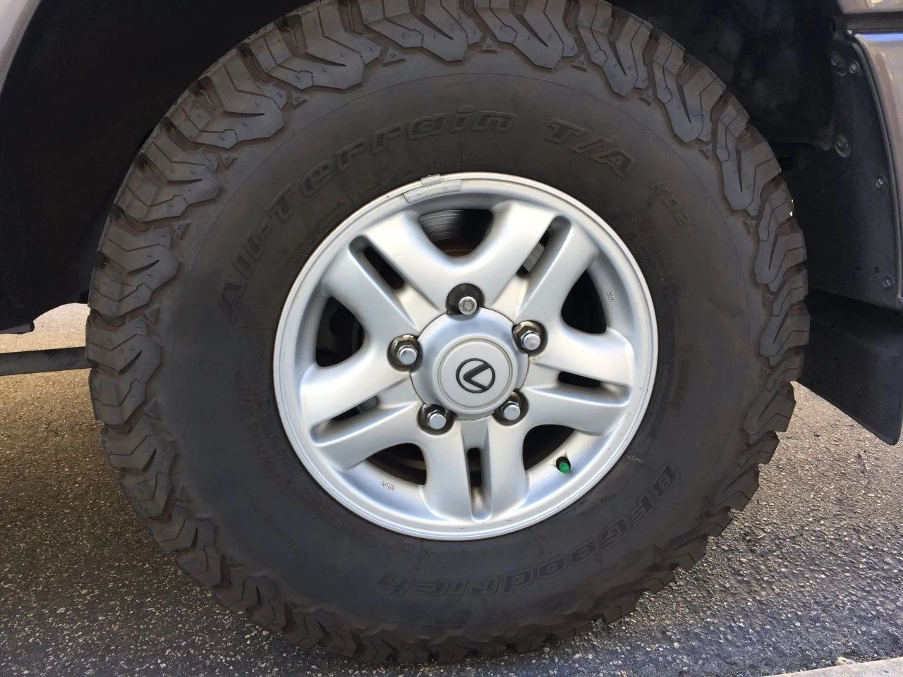

I went from chromies to OE silver.
I waited and waited and waited for a set to come up on CL or in the Mud classifieds.
I'm really stoked on the way they look on my truck. It's standard, but im happy not running the pitted and discolored chromies.
If you find a set of if silver wheels then you can blast them or sand them down and rattlecan them to the desired color.

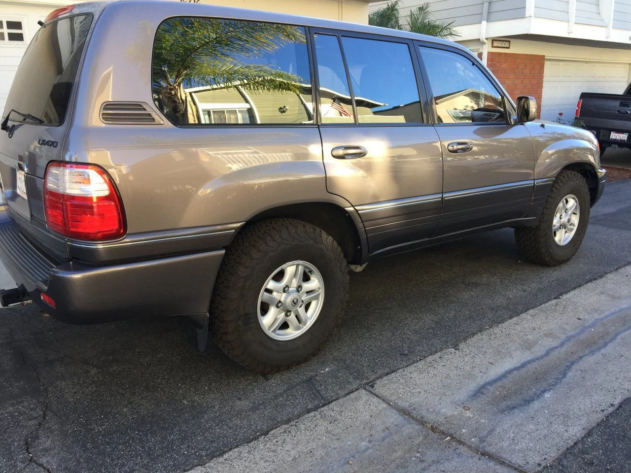

I'd go the route @OG 91 LC did - set your chrome wheels aside, find a set of OE non-chrome wheels and have them powder coated, paint them or leave them stock. A friend of mine found a set locally on craigslist for $75. Guessing you'd spend a lot more than that having chrome removed.
