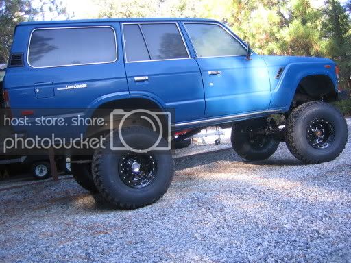

Still wrapping up the SOA setup but i figured i should post some pics. I just turned 17 and am sick of the rice burners in my school parking lot. Ive definetly got the bug that seems to run in the family.heres some pics, Happy wheelin-Dylan

Finally, here we go. My buddys got a 5.0 and it is pretty cool, and you are right i can run them over easily. my buddy with a lowered civic can back up partly under it in the middle

Congrats dude. How did you do it for free?
I'm confused.
No brake lines or steering or shocks?

awesome man!! Who helped you do it? You sticking with those tires or going larger and what size are they? Keep us posted, looks like a very nice ride.

I robbed a local 4 wheel shop. No. . . i never said i did it for free, I basically spent this and part of last years savings. i went with Marlin crossover steering, 4.88's, master installs, SS brakelines, new driveshaft w/ CV, 35" muds, custom 15x9 simulated BL's, 4+ shackle reversal, new bushings everywhere, and the obvious stuff that goes along with SOA like perches, new pins, made some shackles, made some ubolt plates.

yeah those are the 35's. i was surprised to get that much lift. granted i did do the shackle reversal but compared to other straight spring overs it seems a lot taller. now i know that i wont rub for sure and those babies will tuck perfect, hopefully. . . .-Dylan

yeah its pretty tall, trust me i would have liked to go with 37's or taller but there was other places that needed money that i thought were more important. I am glad how it turned out but this is only phase one and i dont think i will ever be "done" with it. Thanks for all the compliments on it, i havent got that much support from family since they dont think it is safe and my friends like civics and integras. _Dylan
