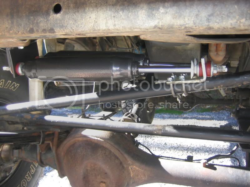

Fab'd a simple stabilizer bracket for the SOA crowd
Aug 4, 2005
70
2,042
california
Since the I did the SOA I have not had any sort of stabilizer because of the hysteer conversion. I never thought I needed one because the steering always felt pretty good. Fast forward to yesterday, helping my buddy demo a chevy pickup, I was able to snag this Rancho dual shock stabilizer. I used three existing holes to mount the fab'd bracket to on the inside of the passenger frame. Anyway, the steering feels a lot tighter and 'stable' with the ranchos installed. Maybe this motivate someone. . .
:cheers: Dylan
Very clean Dylan. Nice work.
I think you should do quad shocks in the wheel wells. You got the mad skilz man!
Dual stabilizers is pretty redneck, huh? :D
Maybe hydro assist someday, if I step up to 40's :flipoff2:
Dylan
Howdy! Looks good to me, and the price is right. I used to run one one tie rod and one on the drag link. They were both Heckthorne singles. I don't know if they are even still in business. Both were pretty worn out when I did my Hi Steer, so for now I run none. Like you said, it feels pretty stable on the freeway now, but I may add a stabilizer or two later. I am also running dual shocks on all 4 corners. John
