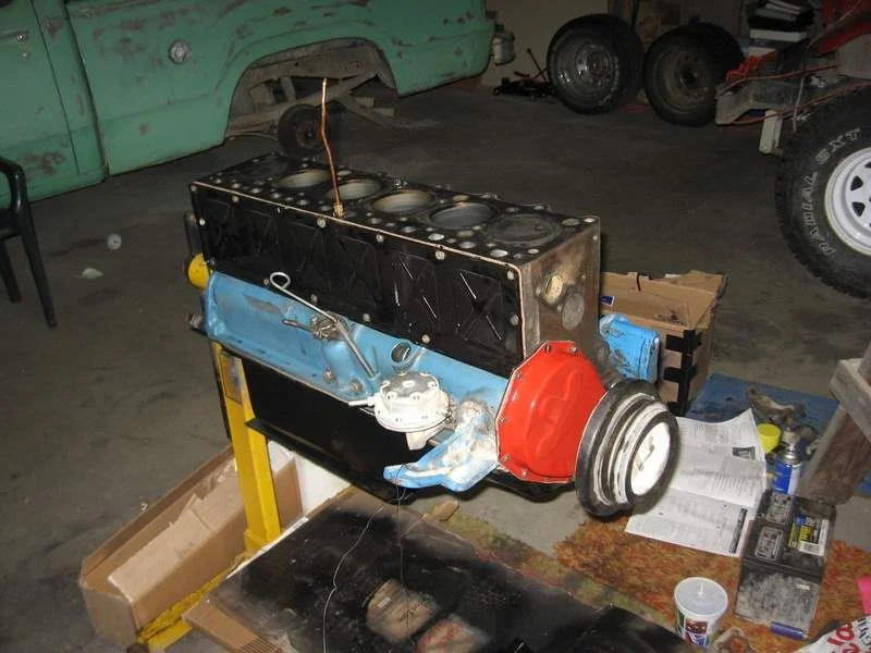

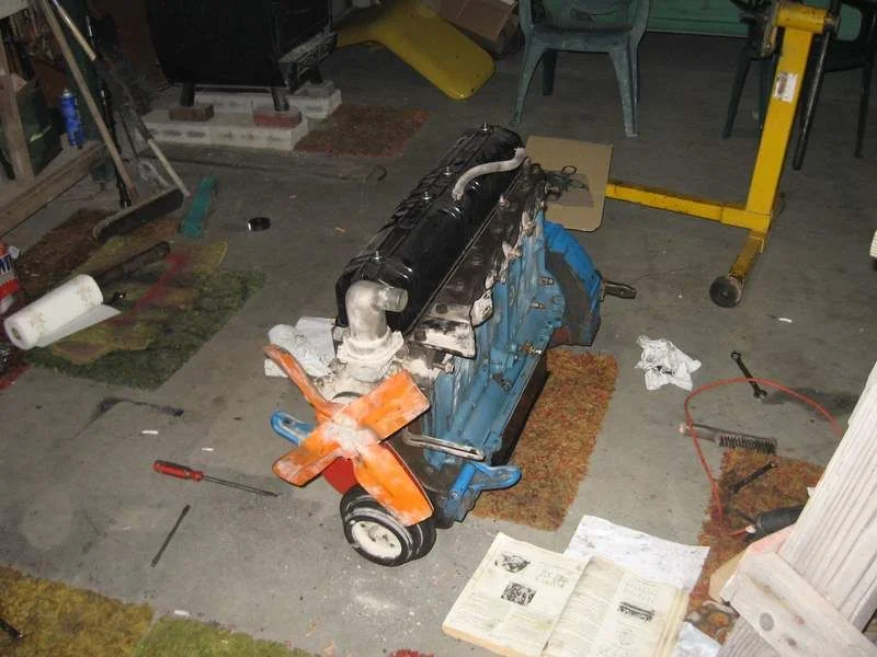

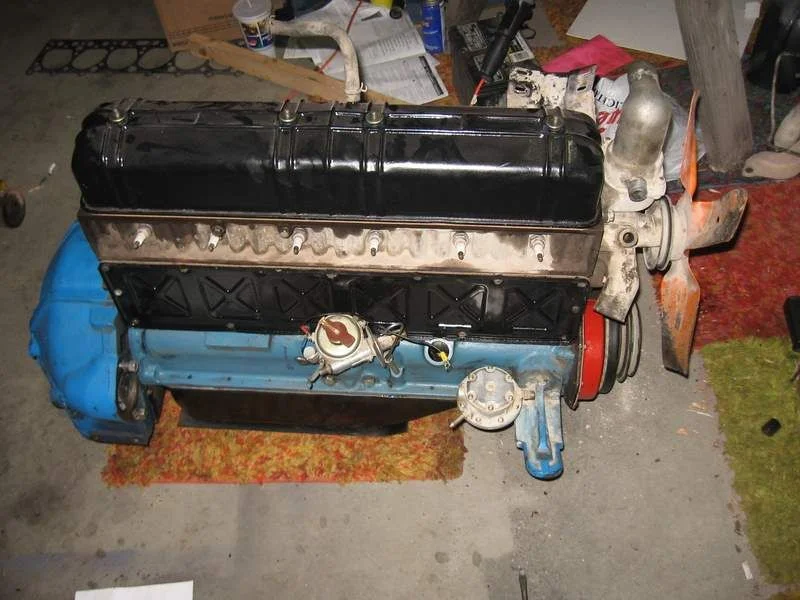

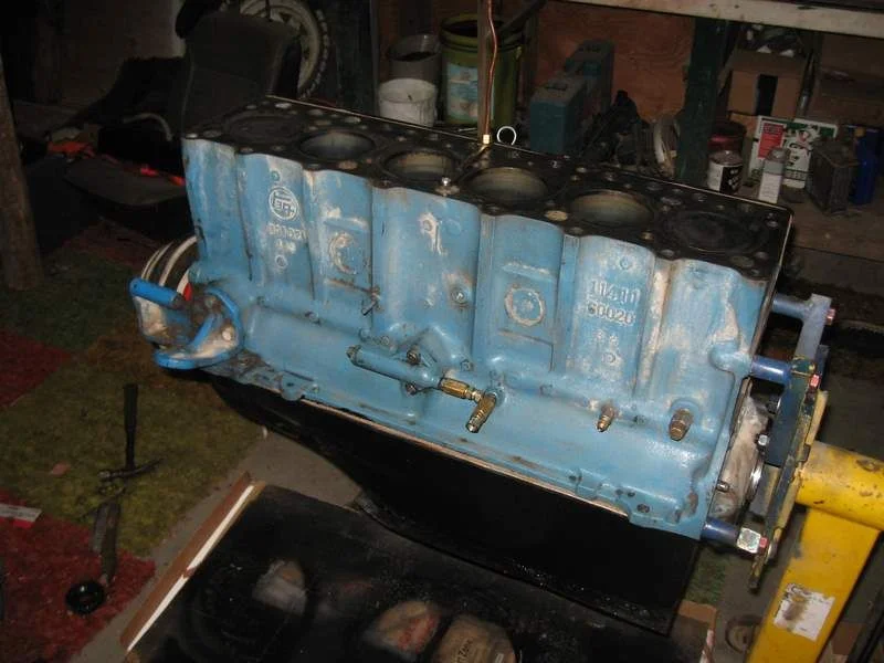

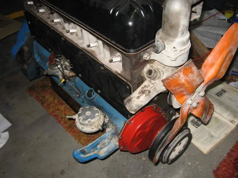

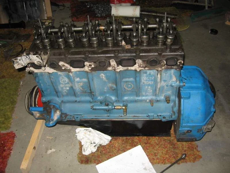

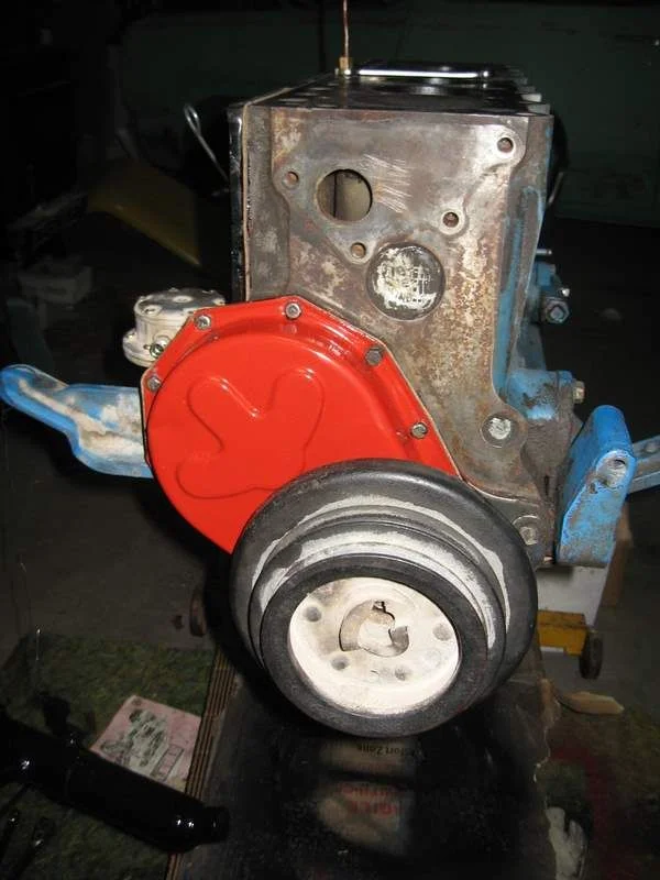

Here are some updated pics of my progress so far...I should get my head gasket and manifold gasket tomorrow and should have it back in wednesday night.
On the last picture can i reuse the water pump gasket or can i put on the new one that isn't round but half circle and half square?
Wow that's interesting.. did they come in the Blue color stock?
With it bored over, what's the hp now? And would you know the difference in torque you'll get?
Hi All:
I think I just used RTV when I installed a replacement water pump last Spring.
Regards,
Alan
when i had it hot tanked they painted it too i think its a ford blue. I'm not sure if I gained any HP or torque i dont have the equipment to check that plus I never drove it before the initial rebuild.
I used the blue RTV 'with' a gasket last year also. Both with the water pump & thermostat.
I use blue RTV along with a new gasket for the water pump.
I would personally leave the manifolds off until you get the engine back into place. Sometimes it can be a little bit of a challenge getting it under the firewall lip and getting the passenger rear engine mount into place, and the manifolds can obscure your ability to see what's where. That said, I'm sure it's doable with the manifolds on.
If the old water pump gasket is in good shape, smear a THIN cost of RTV on both sides, and re-use it. Otherwise use that old gasket as a template to make a new one. Just about all auto stores sell gasket material in a small roll.

Thanks for the support coolerman, I should be done by now but living in the middle of nowhere makes it very difficult to find parts and get them here. plus i have the siamese port head so gaskets and etc always have to be bought either east or west coast. Frustrating but nothing i can do about it. I should get the head on tonight if my gaskets come in. Then I'll drop it on the floor and attach my bellhousing and clutch assembly. Then hopefully tomorrow night it will get put back in. I'm tired of looking at in onthe engine stand and being stuck.

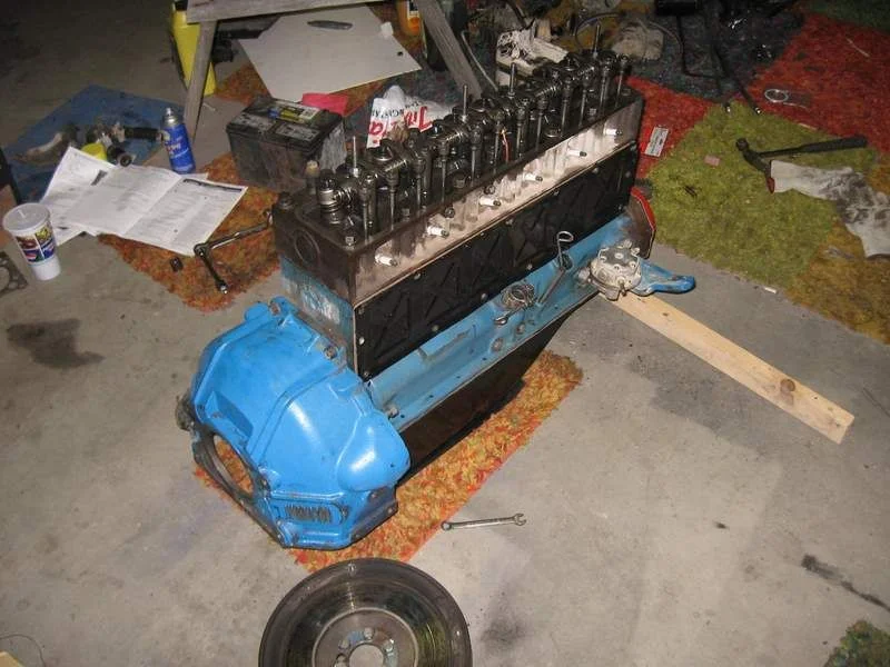

well I got my gaskets from Mark's Offroad lastnight and was able to get the head back on and the pushrods back in. I got everything torqued to 90lbs. I attached the bellhousing and will be puting the flywheel and clutch assembly in tonight. It's finally starting to look like an engine again. Two quick questions though...Do i need to put lock tite on the flywheel bolts and how many Ft/lbs of torque do I need to put on them? Thanks Guys I will have pics at lunch today of my progress.
Absolutely bend those lock tabs. Don't even think about going without them!
I bought my 1968 FJ40 in August of 1974. In January 1975 I was pulling the tranny/transfer in my driveway (Flagstaff AZ) because the PO didn't bend the tabs. One bolt backed out and locked the clutch up. Six months later I had to rebuild the engine because the cotter keys were missing from the castle nuts on the rod caps. Just got to love POs

I'm starting to put the engine back in the rig can i take the clutch fork out, drop the engine in and bolt it to the tranny then put the fork back in?
