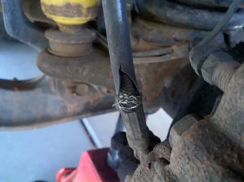

If I could do my lines again I'd go with the extended OEM lines that Beno or CDan put together. Iirc some of the lines are from a Tundra, do a search for the part numbers. The Slee lines (and I'd imagine other stainless lines too) fray over time especially the front caliper lines.
This is after approximately 22000 miles on the slee stainless front caliper. The OEM lines last 10 times that many miles or years. Stainless lines are overpriced shiz and hype if you ask me.
I agree with the above poster. I have Slee lines and the front have had the clear jacket come off. The rear is fine though...
I am sure any other stainless line would have done the same also.
If you look closely at my pics not only is the clear jacket gone, but the stainless sleeve is frayed and presumably cutting into the inner rubber line. Bottom line is that the stainless lines are overpriced s***ty lines and not made with long term reliability in mind.
As far as the firmer pedal comments, I'd be surprised if the OEM are any less firm than the stainless.
