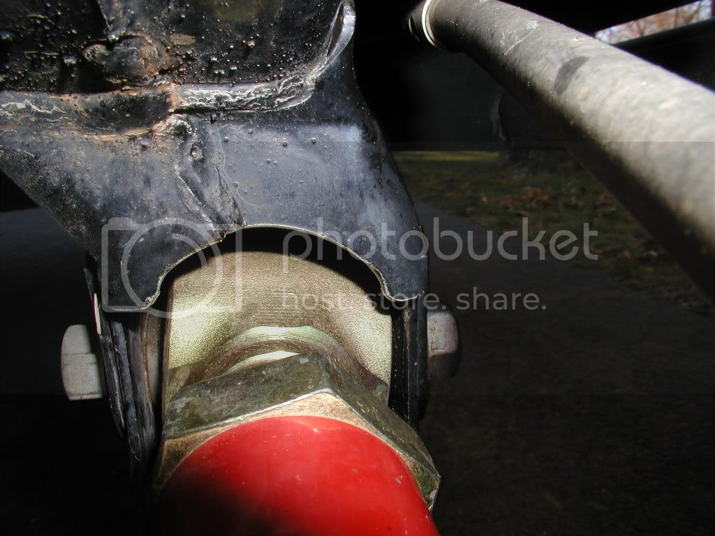

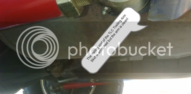

1. Here is the front end (top end?) of a lower control arm with the zerk showing. Note the scratches on the TLC Trailing Arm skids (upper right) - but none on the arm itself -- very cool
2. Here is the same front end, but from a higher and more level angle. There's a couple things to note. One: you can't see the zerk - it appears to be pretty well protected by the Trailing Arm Skid and the mounting bracket itself. Two: you can't see it very well from here, BUT the upper portion of the mount point is *enclosed* -- there would be absolutely no way to get at the zerk if it was mounted in the up position:

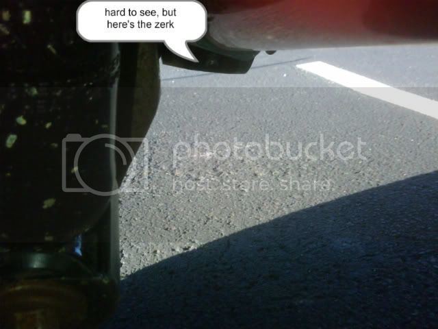

3. Now, here is the back / lower end of the arm. This zerk looks much more exposed than the other one. I was unable to snap a good photo of the top - but once again, the area surrounding the upper portions of the mout point would make it impossible to get at the zerk if it were in the up position.

you can get small bolts that thread in where the zerk is, the only thing i can see you doing is to grease the joint unthread the zerk and screw in the small bolt. the only thing the bolt would do is not hang down as much but it would suck talking it out and screwing in the zerk every tim you wanted to grease it.
you could just leave the zerk in and wheel with it until it snaps off and just go in with a screw extractor and pop the rest out and replace it with a new one

weld a ring of tube around it to protect it. But removing the zerk and putting a plug in there is the easiest.

From the pic it looks like you got lucky that the fitting is still there. How much of the joint is exposed when you jack up the chassis as high as you can? you may be able to grease it if it is on top w/ the chassis jacked up? If there is not enough room then would there be if you used a 90 degree fitting? (keep in mind that the 90 can be pointed say 15 or 20 degrees from the axis of the link, this put everything very tight to the joint body, then I would use a needle attachment to get in to the fitting.
Keep working towards a solution because you do not want to keep the joints mounted fittings down if you wheel it you WILL rip them off then they will get contaminated and destroy themselves.

Upon closer / better inspection maybe reinstalling with the zerks in the up position is a option after all.
1. Note that the zerks are angled (45 deg I think eyeballing it) and that at the top/front end the previously mentioned enclosure does have an opening that I could not see yesterday. It looks like if I reinstall them other-way-around I might get lucky. It's the "might" part that makes me nervous.
2. Now, for the bottom/rear end of the arms. Zerks are angled on this end too. And, once again it looks like there might be just enough room to get inside that enclosure on the top side with a grease gun.

with the new pics it definitely looks like they will be accessible from the top. I have seen two different needle nozzles, one looks like a I.V. needle for poking through dust boots and such and the other looks more like a pencil, this is the one you would want to use for this application the opening on the end is the same diameter as the ball in the face of the zerk so you push it up against the ball and pump in the grease.
