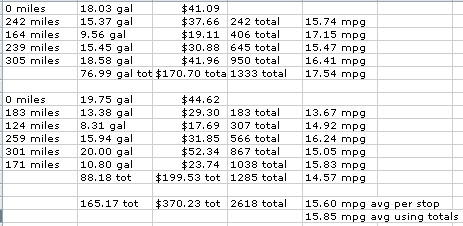

Totally stock, properly tuned and maintained (including JimC rebuilt carb), my FJ60 gets 14-16 mpg. Here's a chart from a road trip last year:
