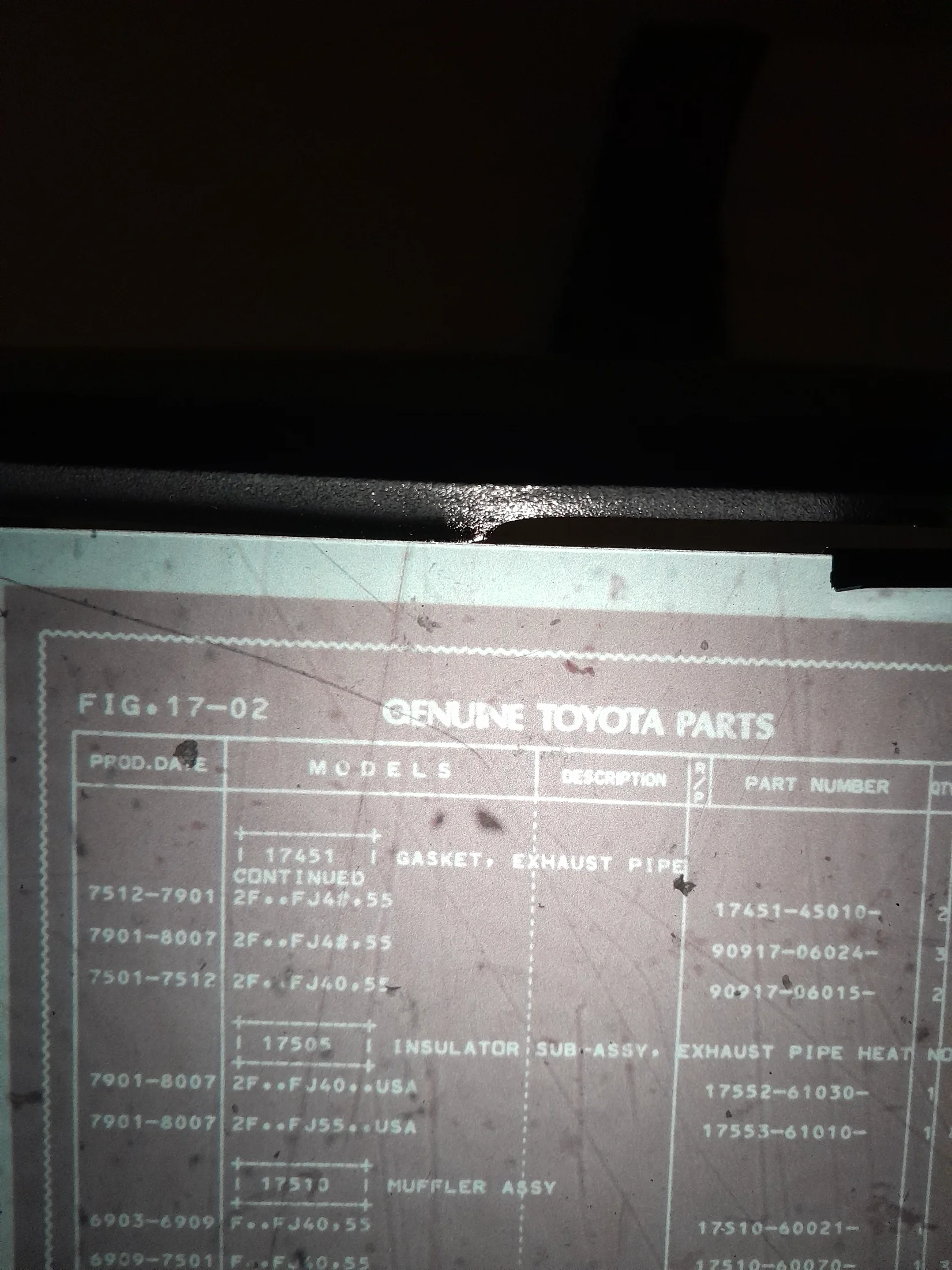

It is usually beneficial, and sometimes necessary, to provide the model and month/year date of production when asking for help. I'm guessing you have a FJ40 with a build date between 12/75 and 01/79, as seen on the microfiche pic, with a p/n 17451-45010 for the gasket.
The correct part number is 17451-45020.
