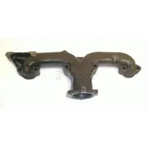

$20/set is a smoking deal if they aren't all screwed up. I hope your inexperince here doesn't get you burned. These are available new you realize? Here's an example of the desireable 2.5" outlet with integral alternator braket from a Vette for a mear $104/side
Shop 1A Auto® for Chevrolet Corvette 5.4L 327ci (Hi-Flow) Driver Side Exhaust Manifold 1962-68 for your Corvette

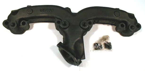

Just found this thread. Picture attached.
Oh... it was $250, and I thought I got taken.

Within the last year, I've found new, repro Rams Horn manifolds for $32 each, on sale, +shp. Over $50 otherwise. Check ebay motors, for one.
With reference to 67-72 trucks, the straight dump Rams Horns came in 4x4s, the angle dumps in 2wds to clear a 2wd's IFS frame cradle.
